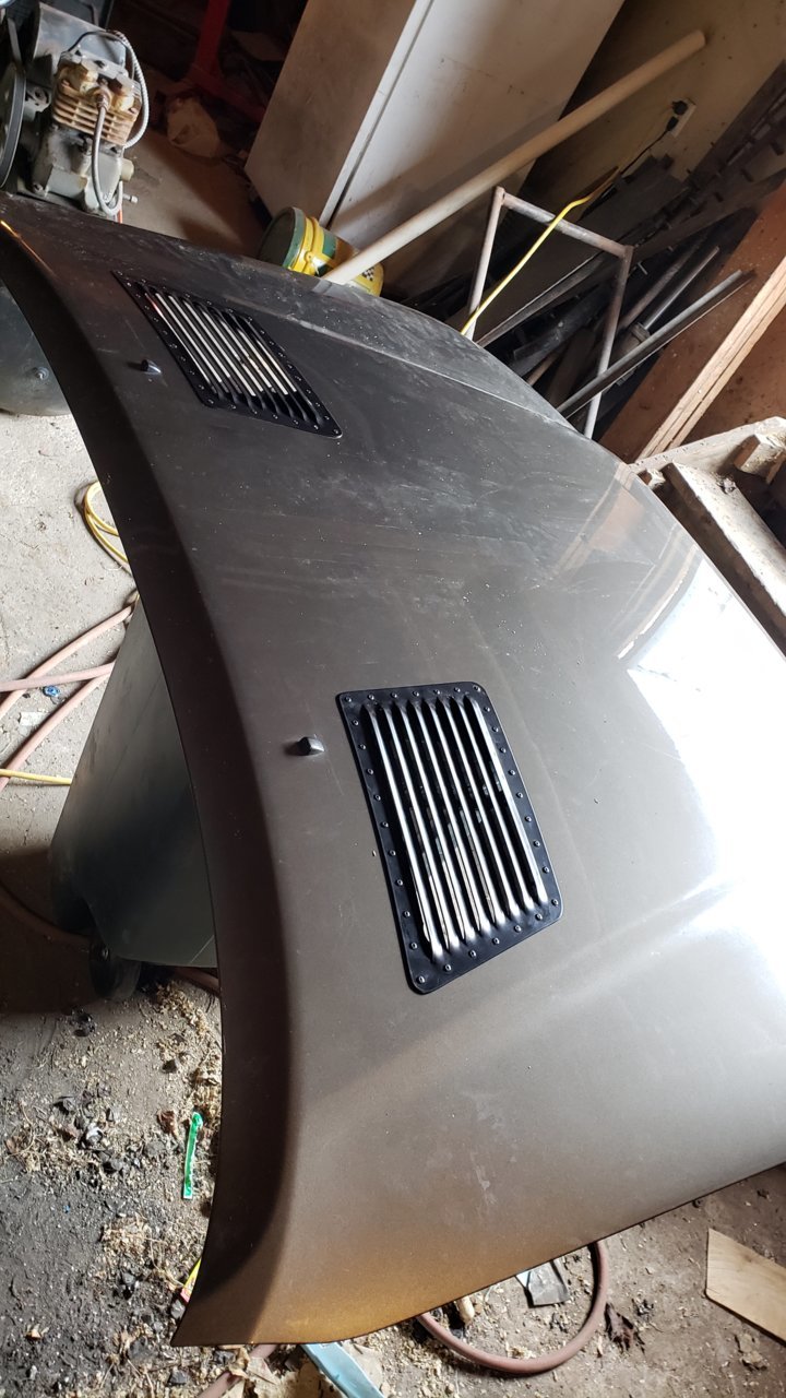

    I’m not interested in engine modifications, I’d rather keep it all mostly stock. These do make a difference on engine bay temps and thus far have had zero negative impact. Beyond that it is purely cosmetic.

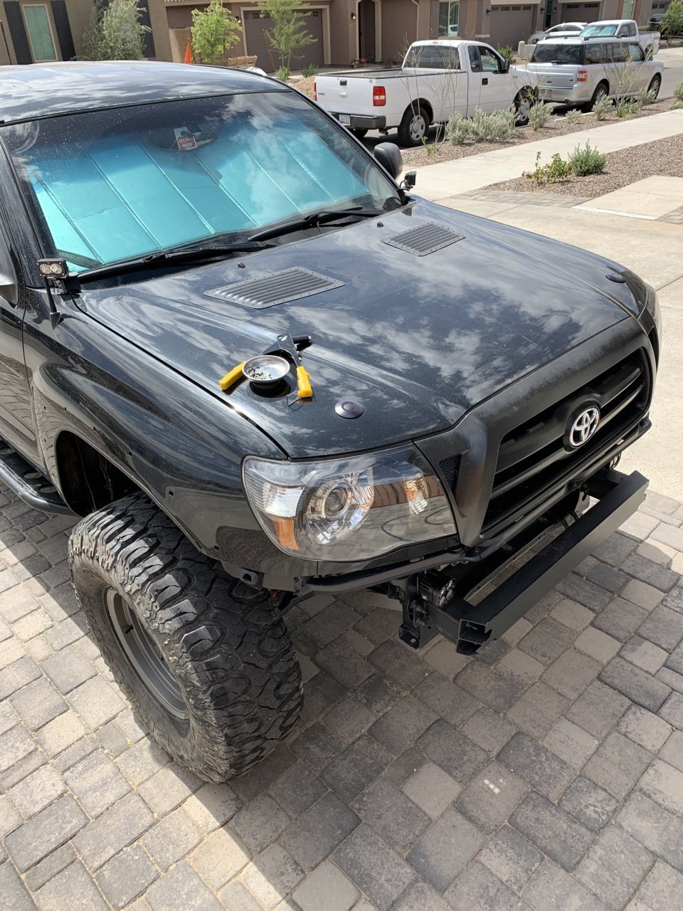

    https://www.tacomaworld.com/threads/singletrack’s-‘dad-shred-build-thread’-i’m-just-doing-it-for-the-kids.619250/ Sos offroad sliders (kickout + filler) Sos offroad full belly skids (steel) Sos offroad front recovery point Sos offroad concepts HC rear bumper with bedside kickout tubes Marlin Crawler LCA frame brace kit Trail Gear rear diff cover Bilstein 5100 + OME 885 Total Chaos UCA BILSTEIN b110 OME Dakar standard pack Wheelers Ubolt flip kit Wheelers Superbump f/r Wheelers SS extended brake lines FN five star 16x8 -25 Milestar Patagonia MT 315/75r16 Custom projector retrofit (acme super h1 + morimoto 4300k) Baja Designs S2 sport ditch pods on CBI ditch pod mounts Amazon AMAK rock lights CMC CB radio hardmount

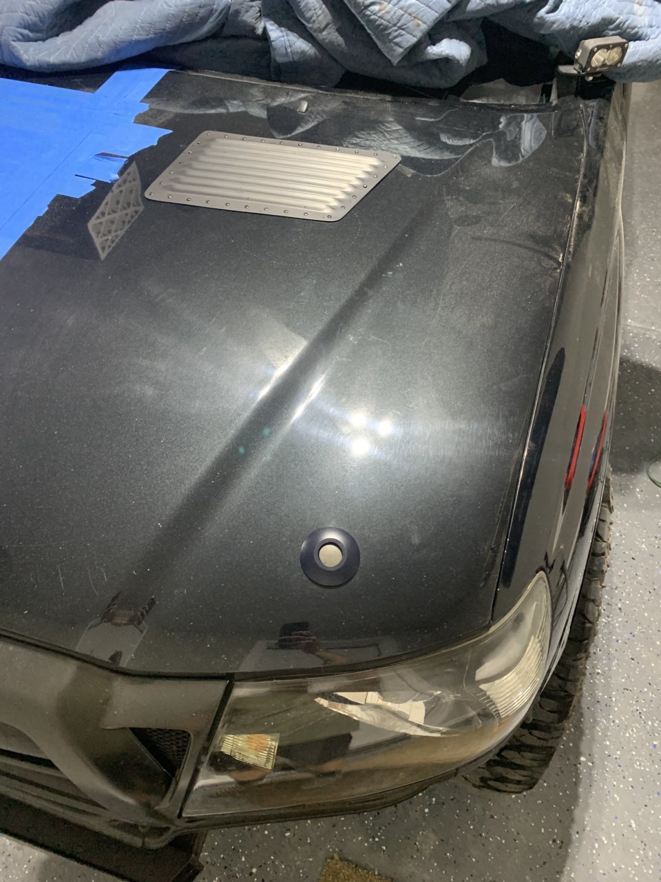

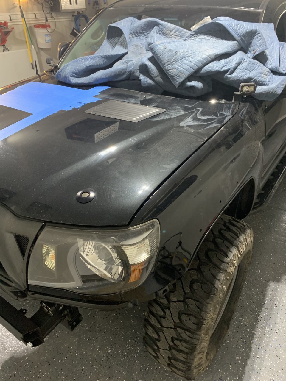

    One side is in!

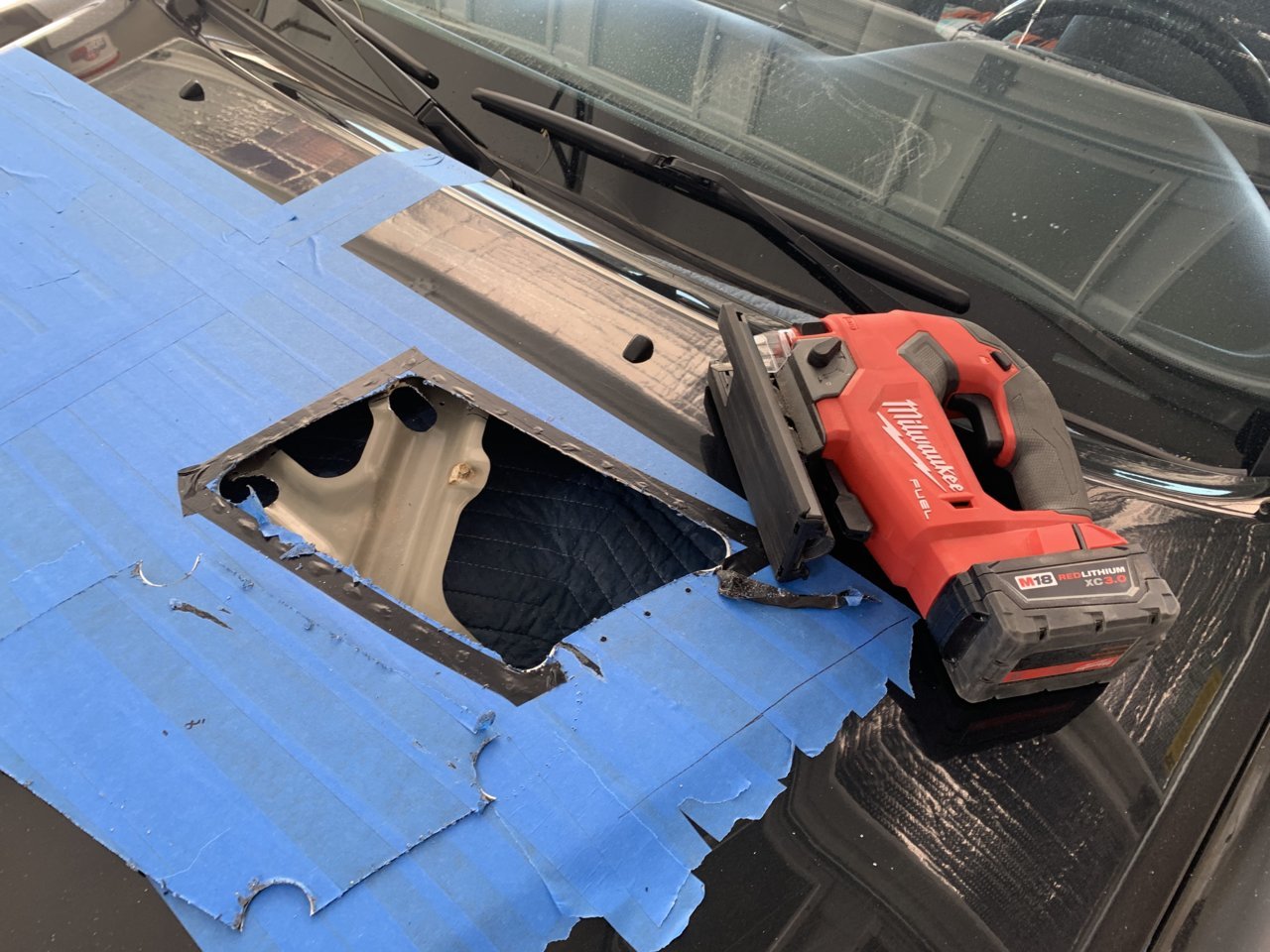

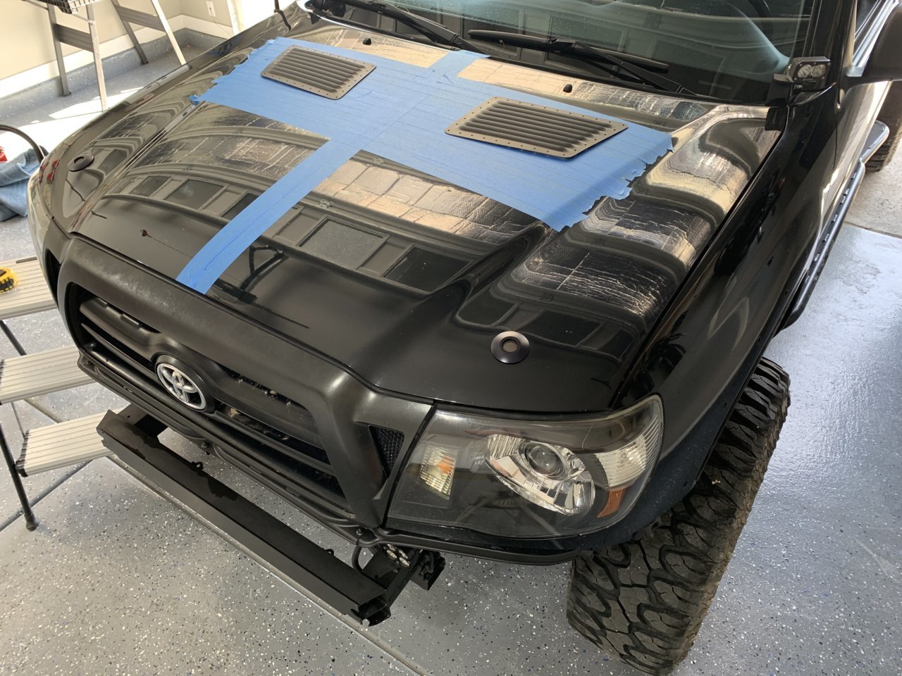

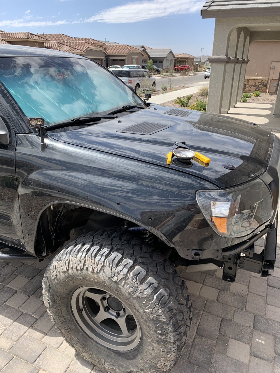

    All done with both sides. Very happy with how it came out. Didnt take as much time as I’d like to cleaning up the cuts from the underside but this’ll do just fine. Going forward I’m keeping temp logs with intake engine and trans temps to see how much this has reduced those in given circumstances/weather. Nothing scientific but data nonetheless.

    Link to these louvers? I'll put those on mine. Looks good and will help with crawling temps I'm sure as that location is pretty much over the headers

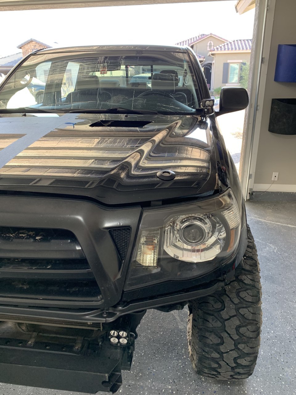

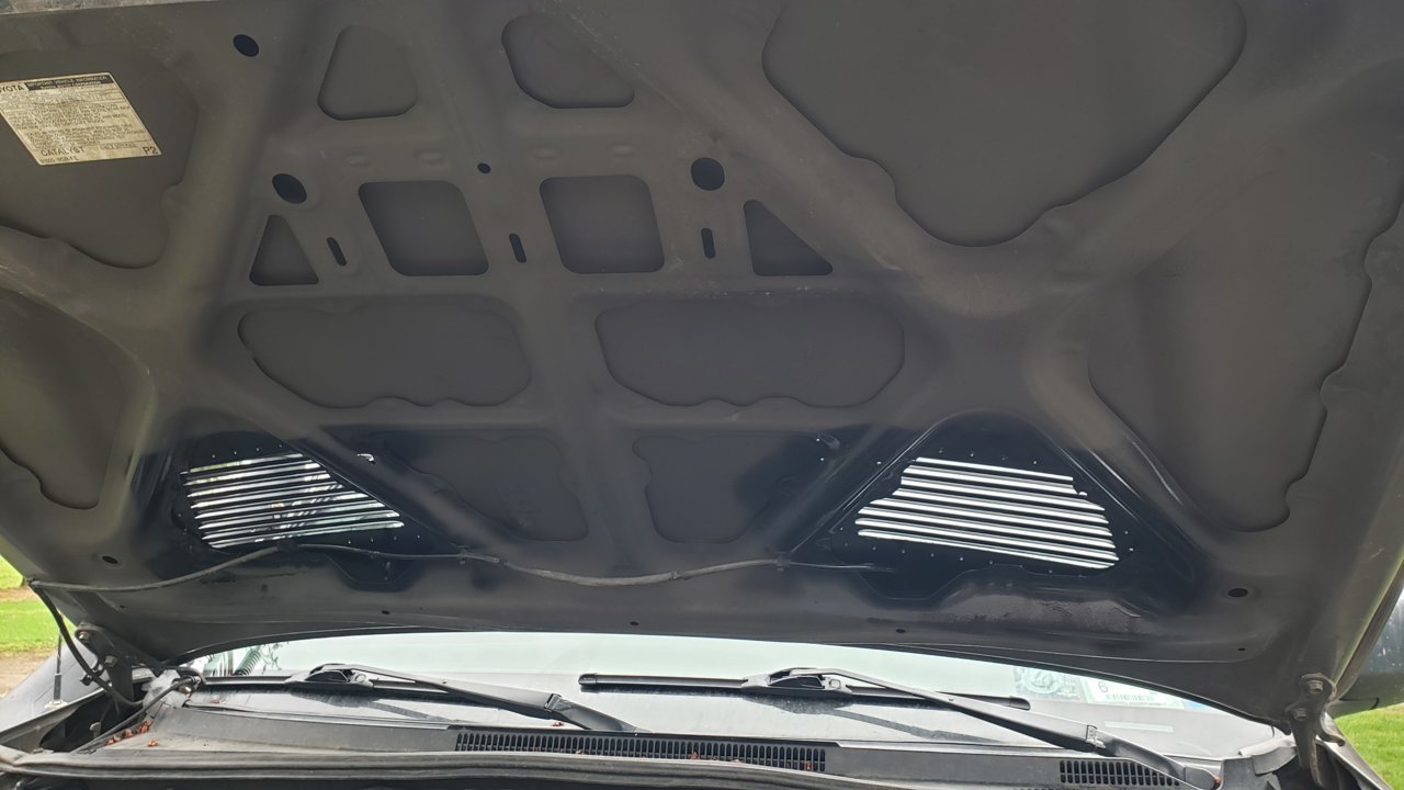

    Did it earlier today.
    Initial thoughts are- I can see temps lower faster when coasting.
    Inside cab noise is quieter- doesn't make sense to me but I'll take it.
    I can see mirage coming out the vents when stopped.
    I tried to place them so they looked right but also over the headers. This also allowed me to avoid cutting supports.

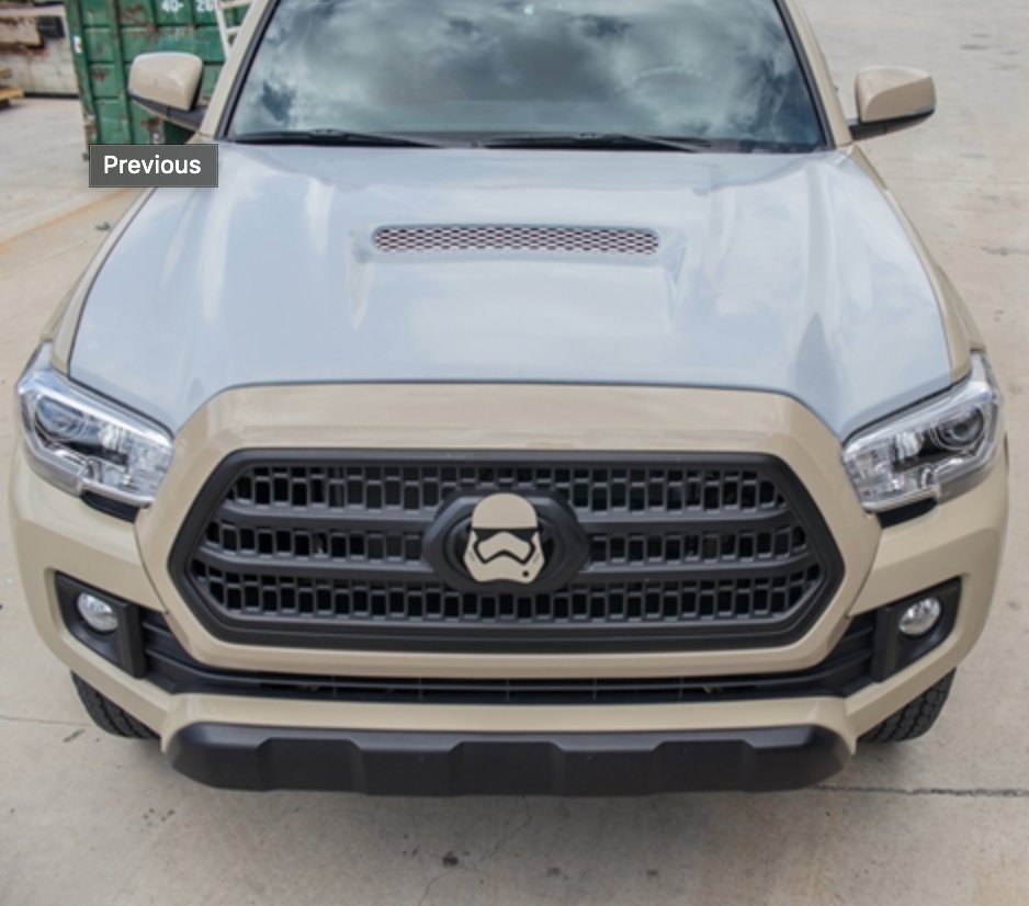

    Dug this thread up from the grave two years later…
    https://www.classicindustries.com/p...zf7T36fZU4IkrtMXaOQaAoziEALw_wcB&gclsrc=aw.ds
    with the build I have in mind I’m going back and forth about hood options (cf with built in louvers or cut my bud and add em myself) I like what OP did with his, and seeing as mine has the stupid scoop I wonder if these would look better with it.
    I’m in Arizona so I don’t worry too much about rain but heat is an issue especially when you’re pushing your rig in the summer when ambient temps are upwards of 120*

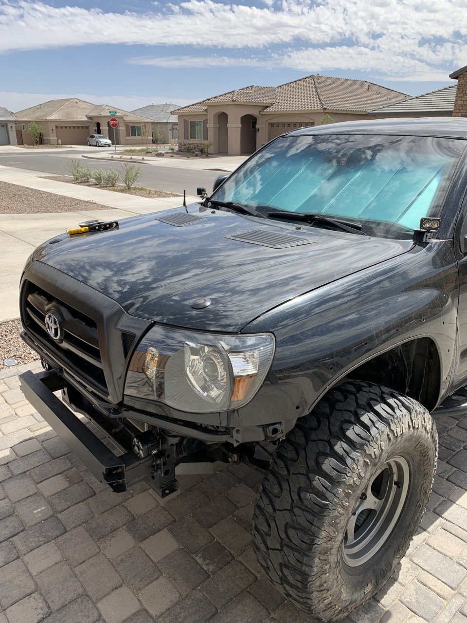

    Still going strong. Love my louvers

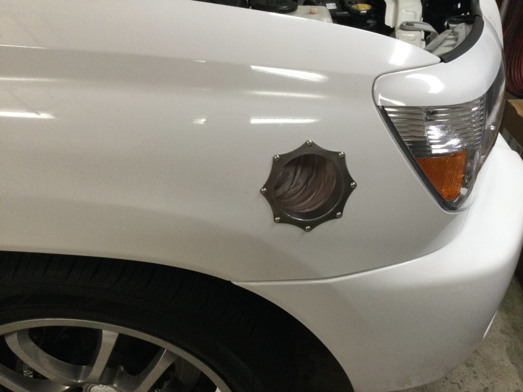

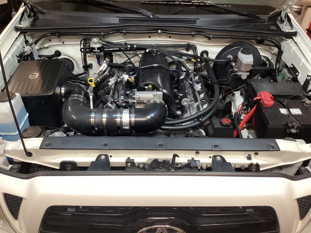

    Bring this back from the dead and if you look at the photo below you may see why. :rolleyes:
    The aluminum L33 5.3 LS w/ a bumpy cam in front of a twin disc, Tremec TKX wide ratio, 3.73 TrueTrec and 275/45-19’s = 28.8” of P7 rubber. This power plant putts out some heat in the engine bay. I even went full “Fast & the Furious” mold for the engine to get cooler outside air. See 2nd pitcher below.
    This mod is a love hate mod. Love that I actually get cooler air but hate the “Fast & the Furious” look. I wanted a NACA duck but I couldn’t find one I could conform to the contour of the front fender. I formed the outside ring and mated it to the stainless tube and had a friends employee weld it. I did find a company that in the process of making color matching powder for powder coating. Color matching would hide mods a little better. I also use 5 x 8mm Stainless Allen button heads with lock nuts to attach no pop rivets here!
    I have a question for the OP, what company did you use for your vents? Sorry to say they look a bit rough around the edges. I like the 316 stainless marine vents but I understand the vents themselves are paper thin and could easily get bent. Also to the guys who said that Toyota didn’t engineer the Tacoma from over heating. You NEED TO KNOW that manufacturers have to build for the masses! I.e. make things child proof!! And yes if you have open venting to the top of the hood you are going to get a dirtier engine bay. The factory would have open venting but you are just asking for more trouble. Owners storing vehicles under trees and etc. Falling debris, would plug the vents, no way of getting around that! Again, manufactures need to make things child proof for the masses.
    Oh, OP the string coming out from your vents and being close to the bottom of the windshield. You need to know that’s one of the highest pressure points on a vehicle. That’s why Cowl CAI are some of the best areas to get outside air from! Now I’m not an engineer but I’m old and have talked to many engineers over my many years.
