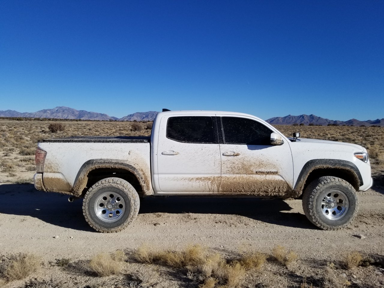

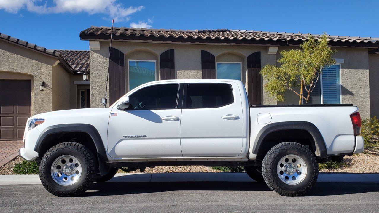

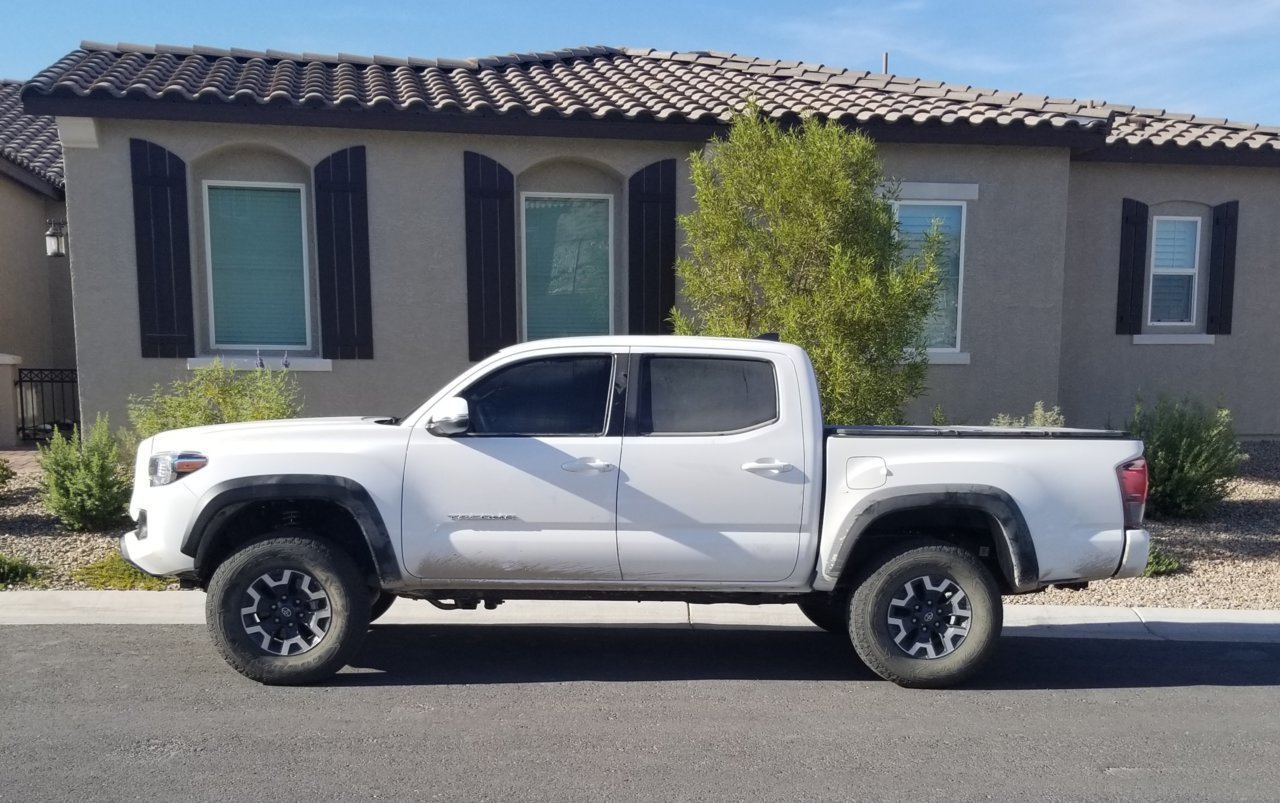

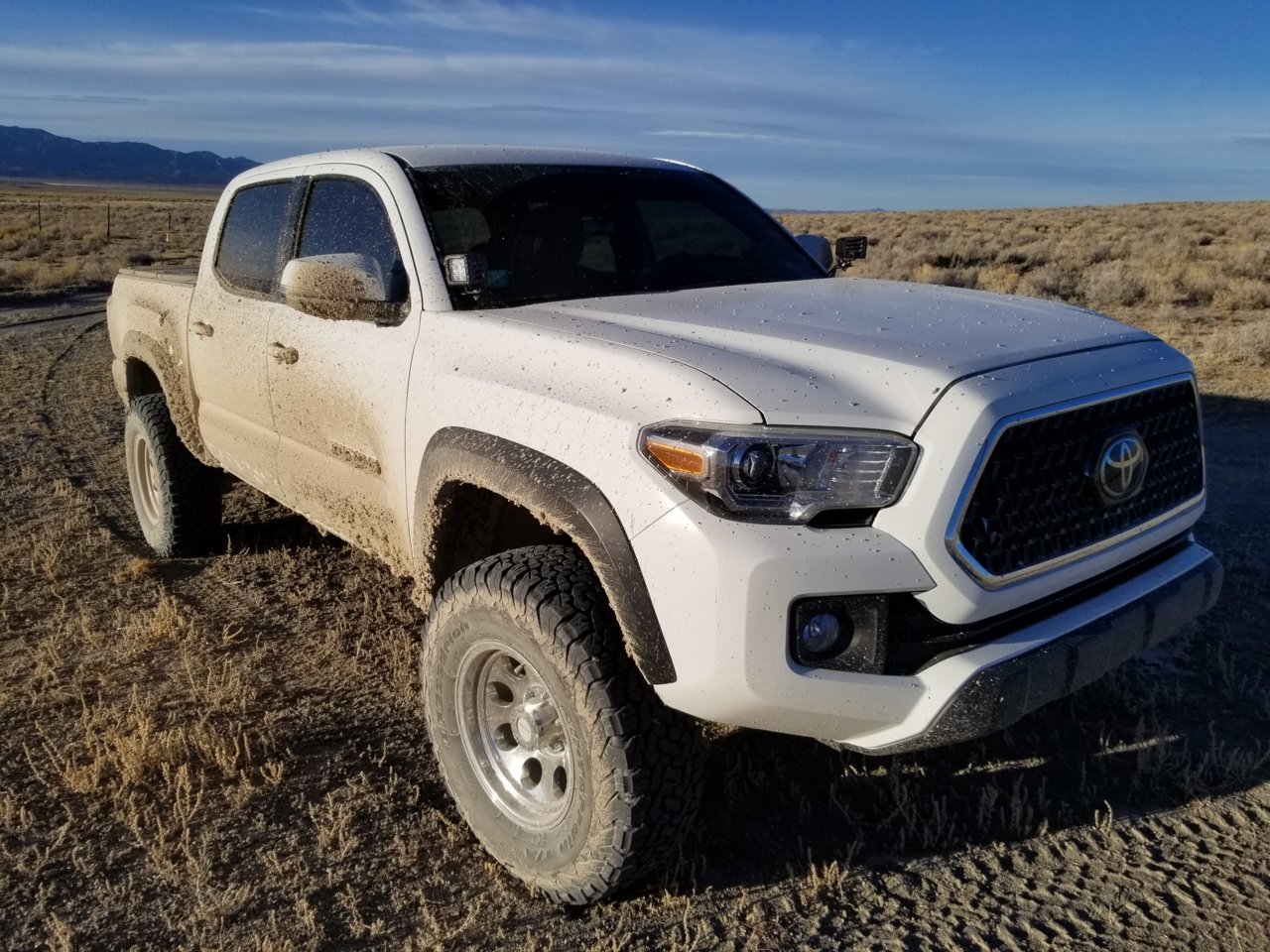

    1.5" Eibach springs, 1.5" Icon add a leaf, Bilstein 5100 shocks, 1" rear blocks.
    Front driver 22"
    Front passenger 22.25"
    Rear driver 23"
    Rear passenger 23.25"
    Bilstein 5100s set at 0
    .25" driver side spacer
    Eibach pro 1.6" coils
    Icon add a leaf 1.5" with 1" blocks, overload removed.
    Thought I would be higher than the stock 21" front 22" rear but now after 8 months I'm only a little over an inch higher over stock.20200316_163820.jpg 20200113_135536.jpg 20200114_154529.jpg
    This pic is with stock wheels right after lift without the 1" blocks. Was too level for me and didn't want to put the overload back in so I just added the blocks.

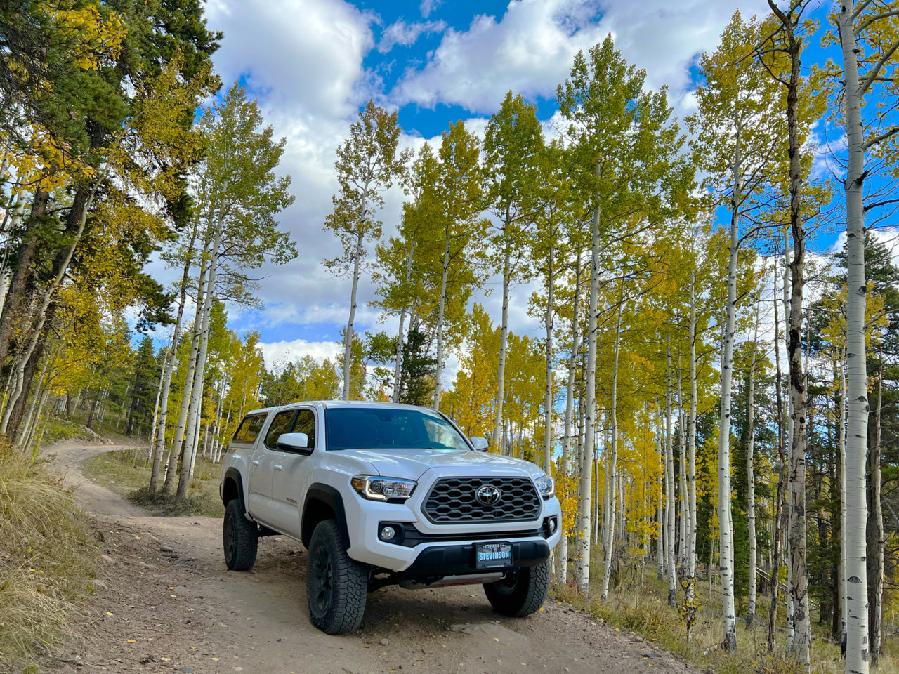

    Bed mat
    DF 22.5 PF 22.75
    DR 24.75 PR 25.0
    Those numbers are with 6112s at 10/8 clips and Icon RXTs leaf springs, stage 3. That is with 275 pounds in the bed (topper, platform and bed mat) and just the aluminum TRD skid plate up front, plus a full tank of gas
