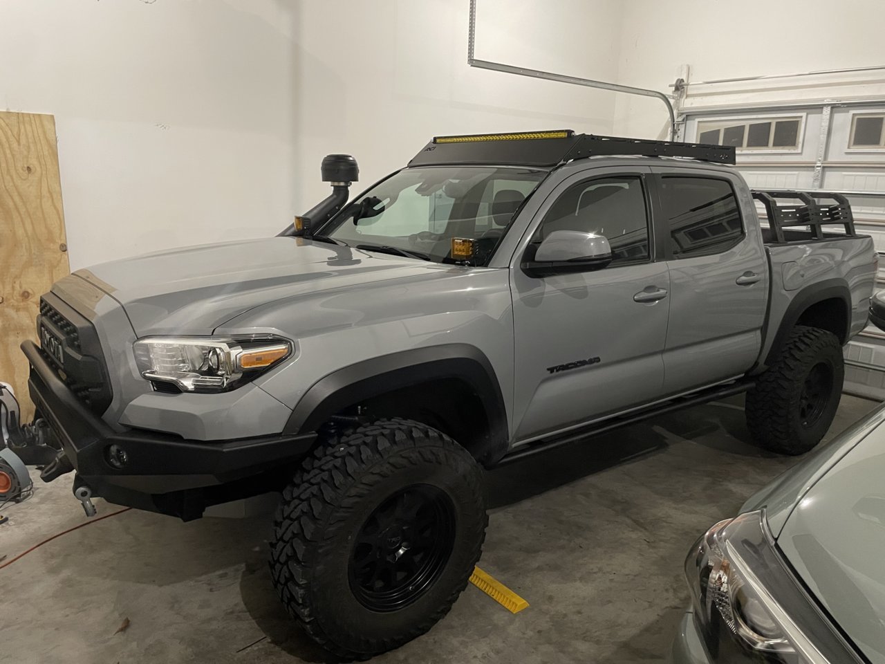

    Had to readjust suspension today after I installed a plate bumper and winch a few weeks ago.
    24 1/8 both sides front
    25 1/4 both sides rear
    Kings with 650# coils, stock leaf pack plus Icon 3 leaf, 1/2” shim to replace overloads, and Firestone airbags
    Wife pulled 4Runner in the garage right after I finished so I couldn’t get a decent picture from the side.

    Any problems with your CV boots? Love the look.

    Thanks! CV boots still look good. I daily drive it about 70 miles a day.
