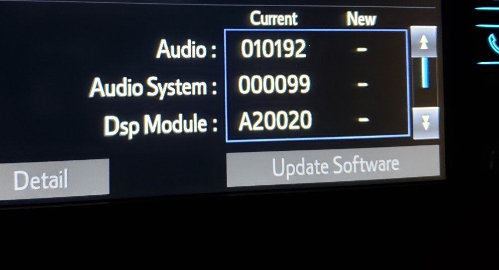

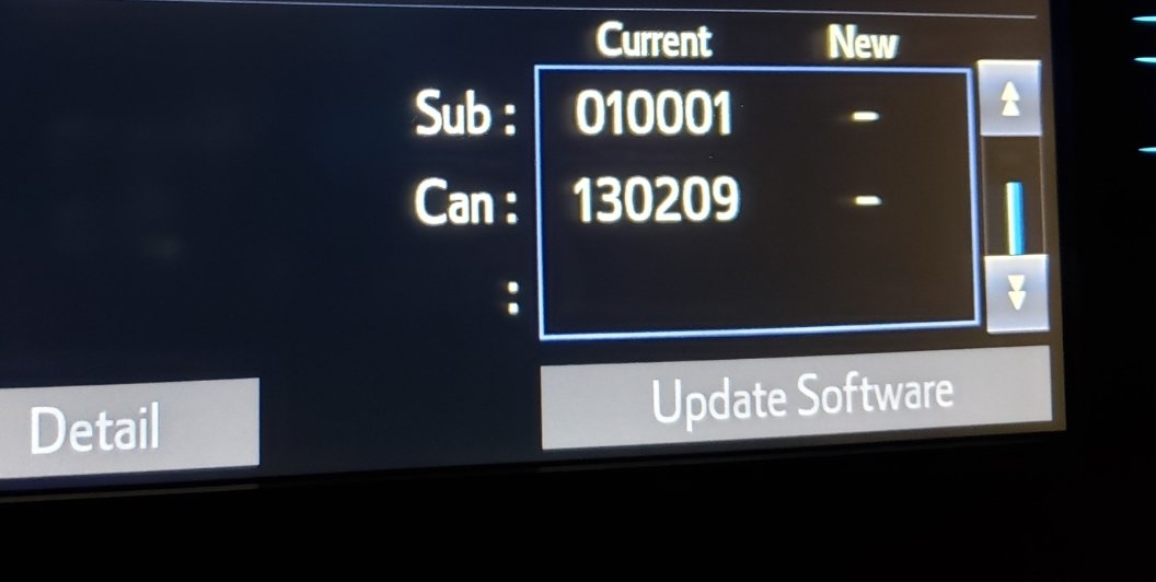

    So I just ran to the store, 5 minute total trip. The radio rebooted 3 times during the way there and back. 4,500 miles on the truck, hadn't ever rebooted up to this point. I have the same phone since purchasing the truck. Wasn't streaming music, just listening to the radio.
    Do I have the most current software on my truck? I do not recall ever updating. It is ghosted out where I would click to update the software.

    I just checked my HU software, it reports one line item different... the current audio shows 01019A. I remember two Over The Air updates since purchase in 10/18. I’ve seen info online that allows for a USB download and update... perhaps check that out first. https://securedp.toyota.com/download-app/downloads

    @toyotatacomaTRD - Tacoma3rdGen has a pretty good suggestion for you. I was having the same problem as you described in my 5th Gen 4Runner. I went to same site as mentioned above (in the link) and I downloaded the update to a USB drive and installed the update. I have been running the update for over a year on my 4Runner and the HU has not crashed and rebooted since. Hopefully the Tacoma update on the site cures your problem.:thumbsup:
