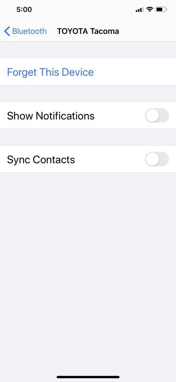

    Think this is an IOS issue. Several updates have come out but haven’t been successful. This is what I saw as a suggestion and I haven’t had any issues. Also, my brother has this same issue with his 4Runner and this worked as well. In Bluetooth settings, toggle off the “show notifications” and “sync contacts” options.

    How old is your iPhone? I have an iPhone 8 and just updated to iOS 13. My gut is telling me it is iOS 13 with an older iPhone. Aka apple wants us to upgrade.
    Literally the second my truck was connected via bluetooth on iOS 13 all hell broke loose. And I mean it freaks out, shuts off every 10 seconds. The way I got my to stop was restarting the iPhone and leaving bluetooth off. It does also tweak with the charging port (front dash not inside console) so its definitely during the sync and/or bluetooth process.
    Im in Oregon too but the lemon shit sounds like a headacheeee. No way would a dealership can fix a computer issue they can barely change my oil right. Im going to try the options listened above for the 4runner first. If that fails I will just then get a new iPhone then upgrade the HU.

    Update!
    This worked for my iPhone 8 on iOS 13 and 2019 TRD OR.

    If this is your second HU it definitely doesn't sound like a HU problem. That should have narrowed that down.
    Try going into your Tacoma and deleting your phone from the bluetooth log. Restart your phone. Repair phone in bluetooth and unselect contact sync. No offense but if your jumping to the lemon law I don't really believe that you tried the fix. Post screen shot.
    I read this "So, finally I had a chat with the service guy and he said that he has seen that happen when people have pictures as part of some of their contacts on their phone. I tried it, and disabled contact syncing, and after driving the car repeatedly I can now say this is not happening to me any longer. I never used the contact syncing anyway, so I do not care too much about it."
    and this "Our 2014 Highlander has had nothing but problems with the entune system. Toyota replaced the head unit once and the CPU once, but since then they have just told us "user error" whenever we experience problems with reboots or just plain old non-functionality. They're patched and updated it numerous times. It'll work for a few days or even weeks, then will stop receiving phone calls or texts, or will even refuse to recognize an iPhone connected via Bluetooth or the hardwire. Toyota told us it's an iPhone incompatibility. Garbage. Replacing the whole thing with a Pioneer system with wireless CarPlay."
    Found those on youtube here https://www.youtube.com/watch?v=0MmmENpOo0E
    This sounds like a fat ass headache for you. Trying to help but seems your mind was made up during your first post.
    Here. Go all the way to 3:03 but turn Sync contacts off.
    https://www.youtube.com/watch?v=gbX-t-eQlVc
