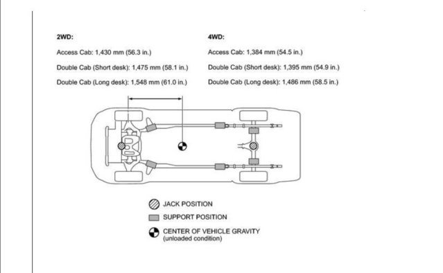

    Here's what the service manual says...

    Lynnwood, WA
    Jack points:
    -- Just about any place on the main frame.
    -- Under the rear diff or just inboard of the leaf springs.
    -- Under the front lower control arms, if you need to. Just enough to get the wheel off the ground.
    -- Under the front crossmember where the protrusion is.​
