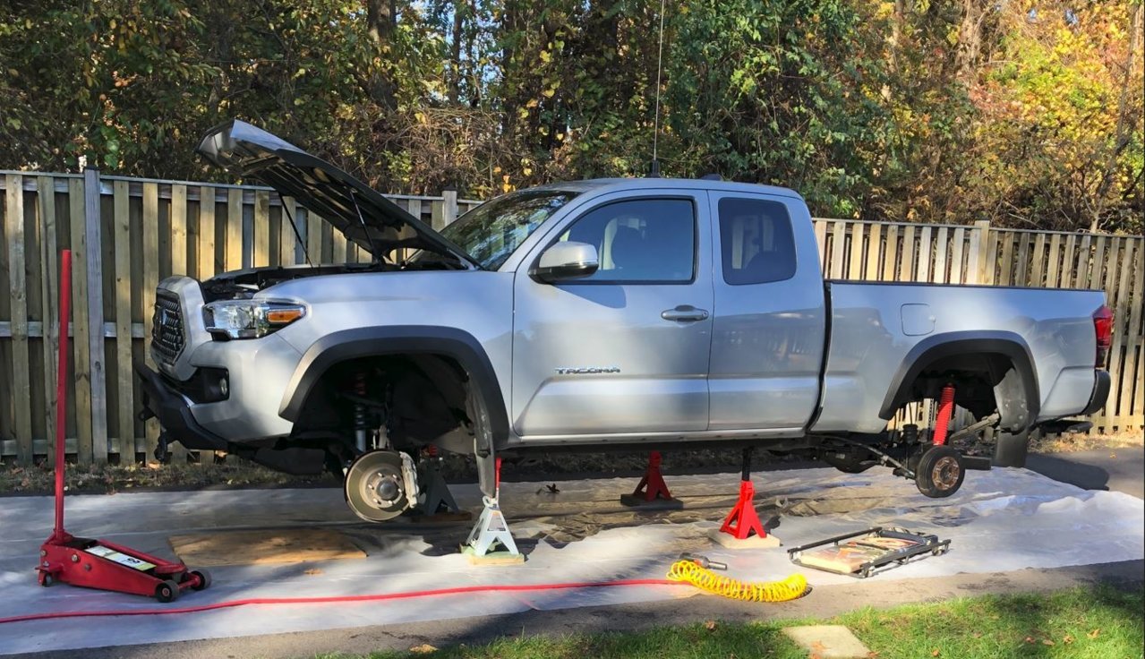

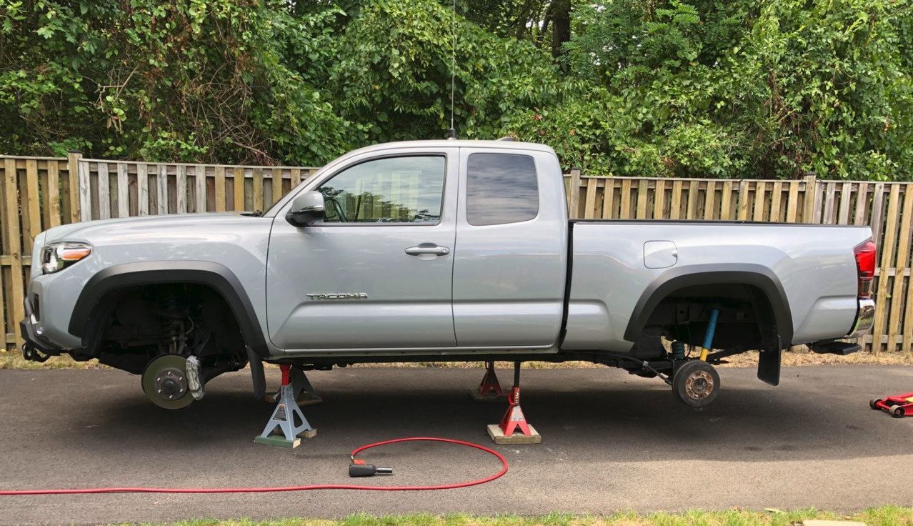

    Capture.jpg Capture1.jpg When I work on my truck. Solid as a rock.
    RJ_MacReady and tcDrew like this.

    I needed rear axle droop for what I was doing. That's why I used the four jack stand points on the frame.
