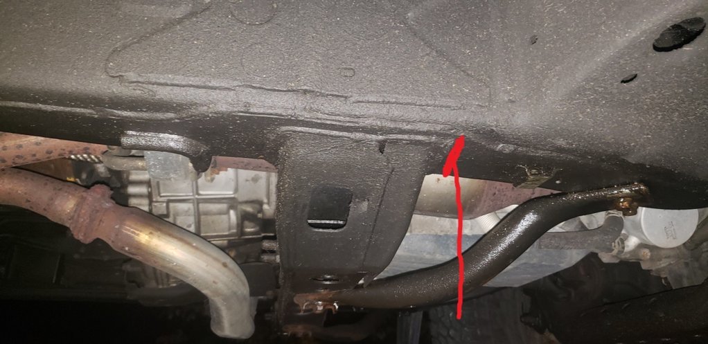

    So this appears to be the front jacking spot referenced in this thread. This is Driver's side, right in front of the "transmission crossmember." I think. Am I in the right place?

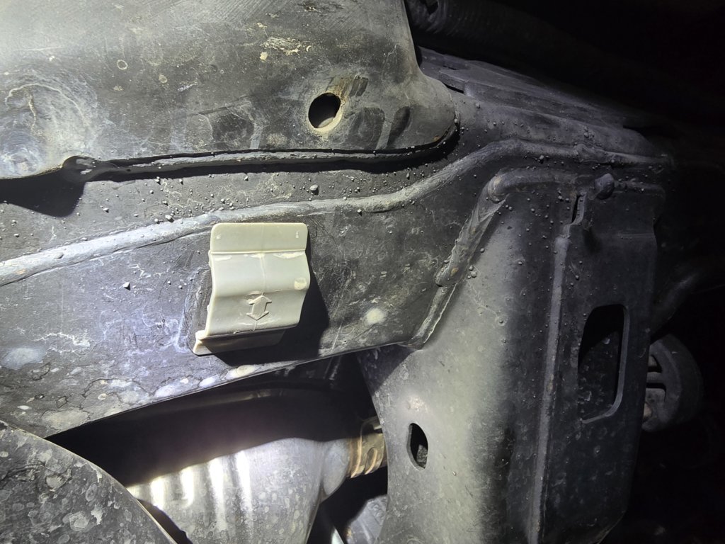

    What the heck is this plastic tab right where the jack stand would go? There's one on the other side, too. But it's half broken, I assume from being put on a lift at the dealer. Do I just rip it out?
    I'd already bought 3 ton harbor freight jack stands. I think they'll be fine on the rear axle. I'm going to get 6 ton stands for the front. If I'm working under it I'm going to leave the wheels on (I just need a bit of "breathing" room so I can use a creeper). I feel like if it goes south the worst thing that happens is it lands on the tires? Not sure how much suspension travel there'd be in such a situation or if I'd be squished.
    When I'm done with the oil I can go straight into removing the tires and rotating them.
    Is this a terrible idea? Anyone else use jack stands just for more room underneath?

    Your picture is a little too close up to say for sure but if my memory serves the support point is on the other side of the crossmember (a little behind where the back of the front tires would be, where the frame straightens out).
    The plastic piece is just a plug for a hole in the frame that is supposed to allow water to come out and not in. I believe there are slight plastic lips / clips so you kind of pry it out gently and it should pop back in. Either way, if you are undercoating / rust protecting your truck, or if you don't live in the rust belt, it doesn't really matter much if you leave it in or not. The jack should definitely not be going where that plastic piece is regardless.

    EDIT: Upon further reflection I went outside to take a picture. (PASSENGER SIDE for reference) This is where I've always put mine and have never had an issue.

    Supposedly that plastic piece provides air flow direction and helps keep dust out of your frame? Your open c channel frame.
