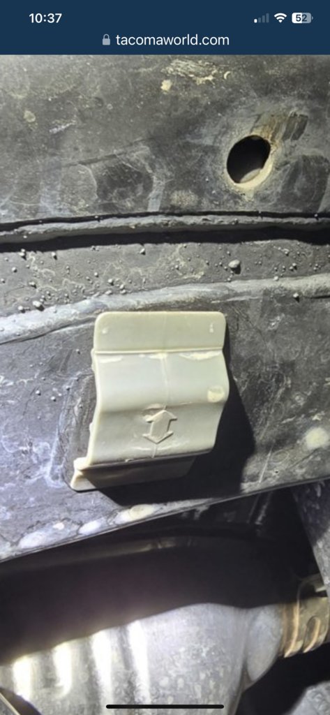

    I don’t want to hijack this thread but I’m missing one of these plastic pieces does anyone know the part number?

    That part has a long history of mystery. I’m not sure it has part number let alone a name. Many mystics have shared their visions of its purpose.
    Personally. as much as a clutz I am, I still have mine. If I had lost one, I would not drown myself in liquor.
    I suspect they are designed to stop crud getting into the frame drain, which is a galant goal in life.
    Sorry, I cannot help you much with the part number, the name, or the purpose.

    I think one of mine was left off during assembly I have never been off road and do all my own maintenance and just happened to notice it missing one day when I was under the truck.

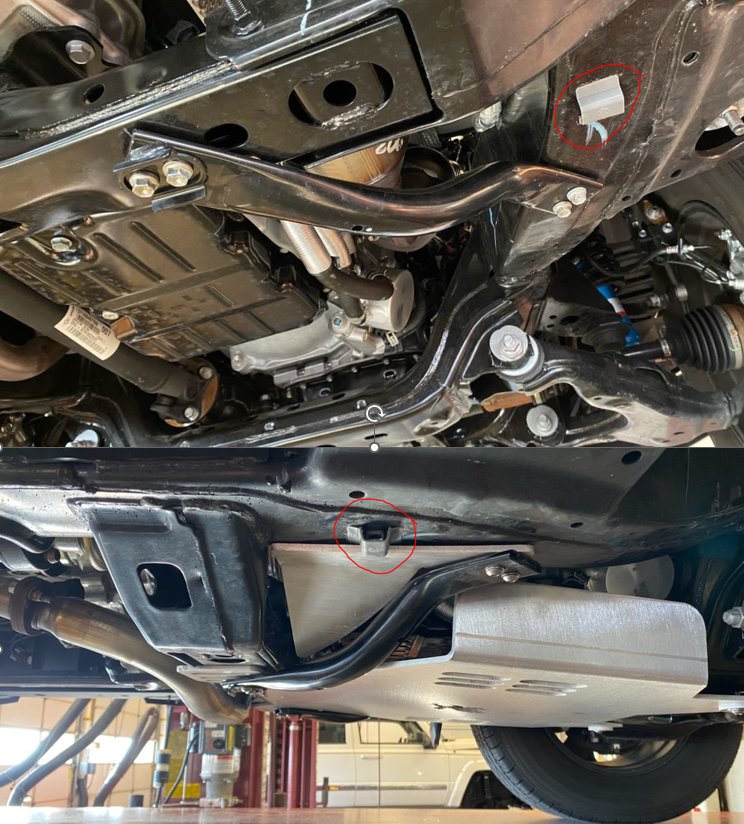

    The TRD Skid is designed to use this center jack point. It typically sits just below the level of the support point. When you go to jack-up, it deflects engaging the support point. It does have a marking so you know where to place the jack. - It works pretty seamlessly.

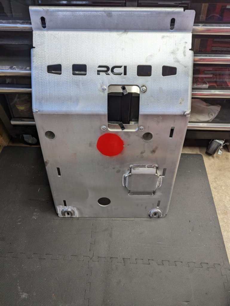

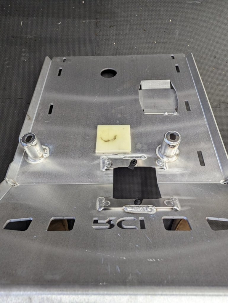

    I glued a piece of HDPE onto my RCI aluminum skid plate to utilize the front jack point. The plastic fills the gap between the skid plate and jacking point so the plate won't bend if you lift on it.

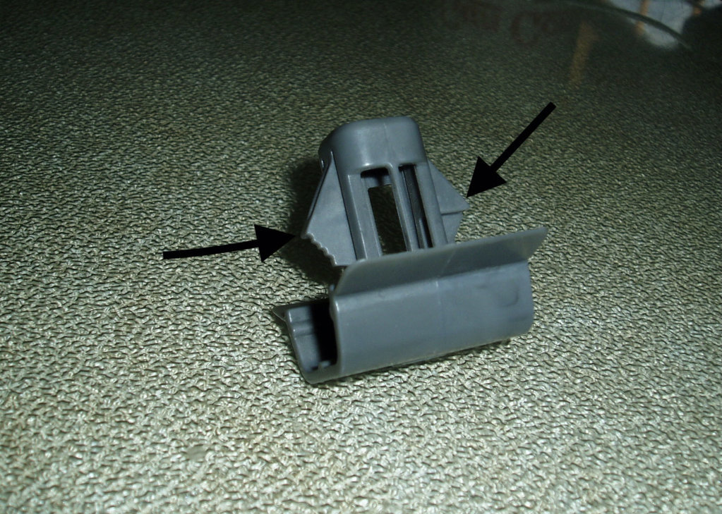

    Plug, Hole, part # 90950-01A24. IIRC there were (3) to a bag and cost around $6. The design is such that I doubt you will remove one without breaking it. Once in the hole you can't depress the tabs (indicated by the arrows) so it's not coming out... I had to replace one when the person doing the yearly inspection lifted on it smashing it good.
    Now I place a florescent green zip tie through it for inspections. No lifting on the zip tie please...

    Thank you @steel wheels I am not sure what happened to mine but now that I know the part number I will order them today.

    They are to prevent water from getting into the frame.
    https://static.nhtsa.gov/odi/tsbs/2018/MC-10152605-9999.pdf
