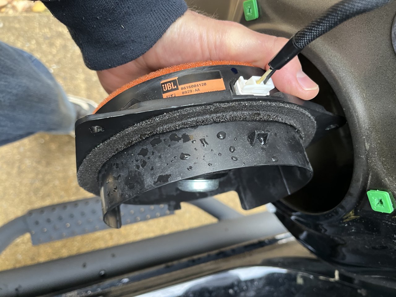

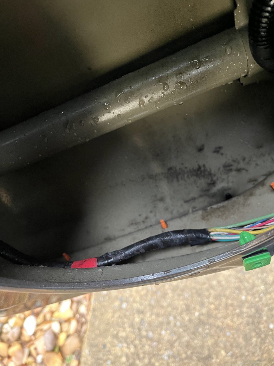

    I was wanting to get some input from everyone, on the inside of my doors, after I took the panels off there is water inside the door and ontop the speaker housing. I also removed the driver rear and it had water inside the door as well. Is this something to be concerned about? tacodoor1.jpg tacodoor2.jpg tacodoor3.jpg

    That's normal, water gets in. There's no way to keep it out.
