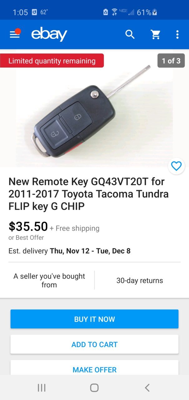

    Make sure whatever key you buy has a compatible FCC ID which is on the back of your fob

    If you look at the link and click on the ebay link (for the flip key) it says its compatible with certain FCC ID
    I think most if not all third party sellers will tell you which ID,s will work

    The GQ43.... is the ID part of it
