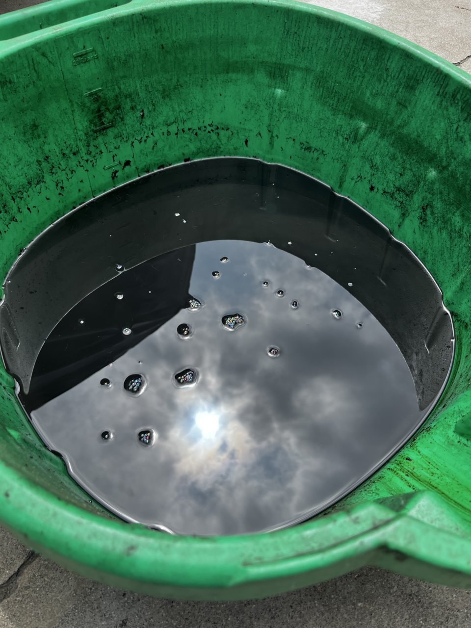

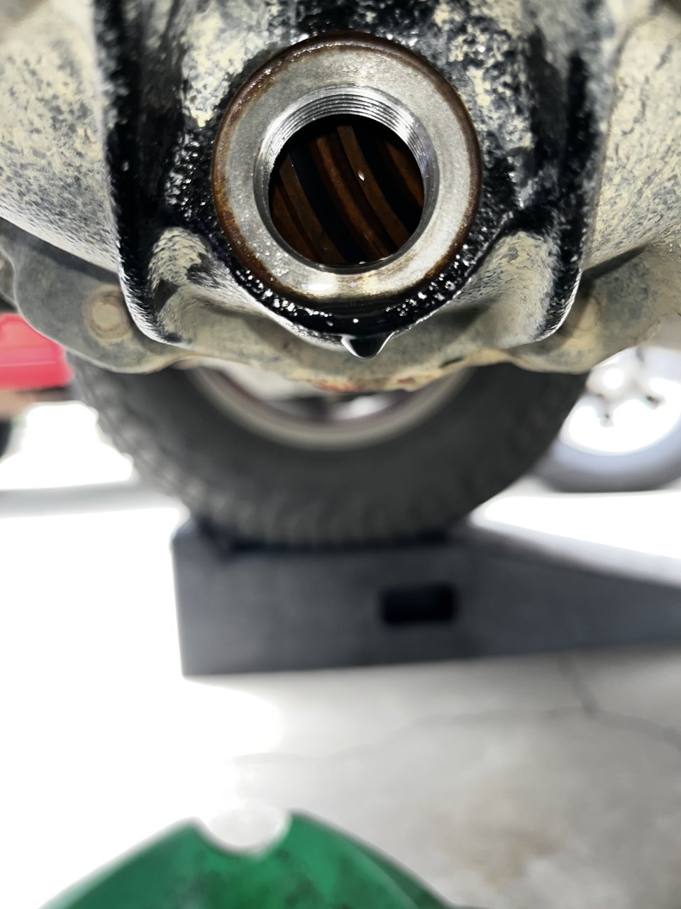

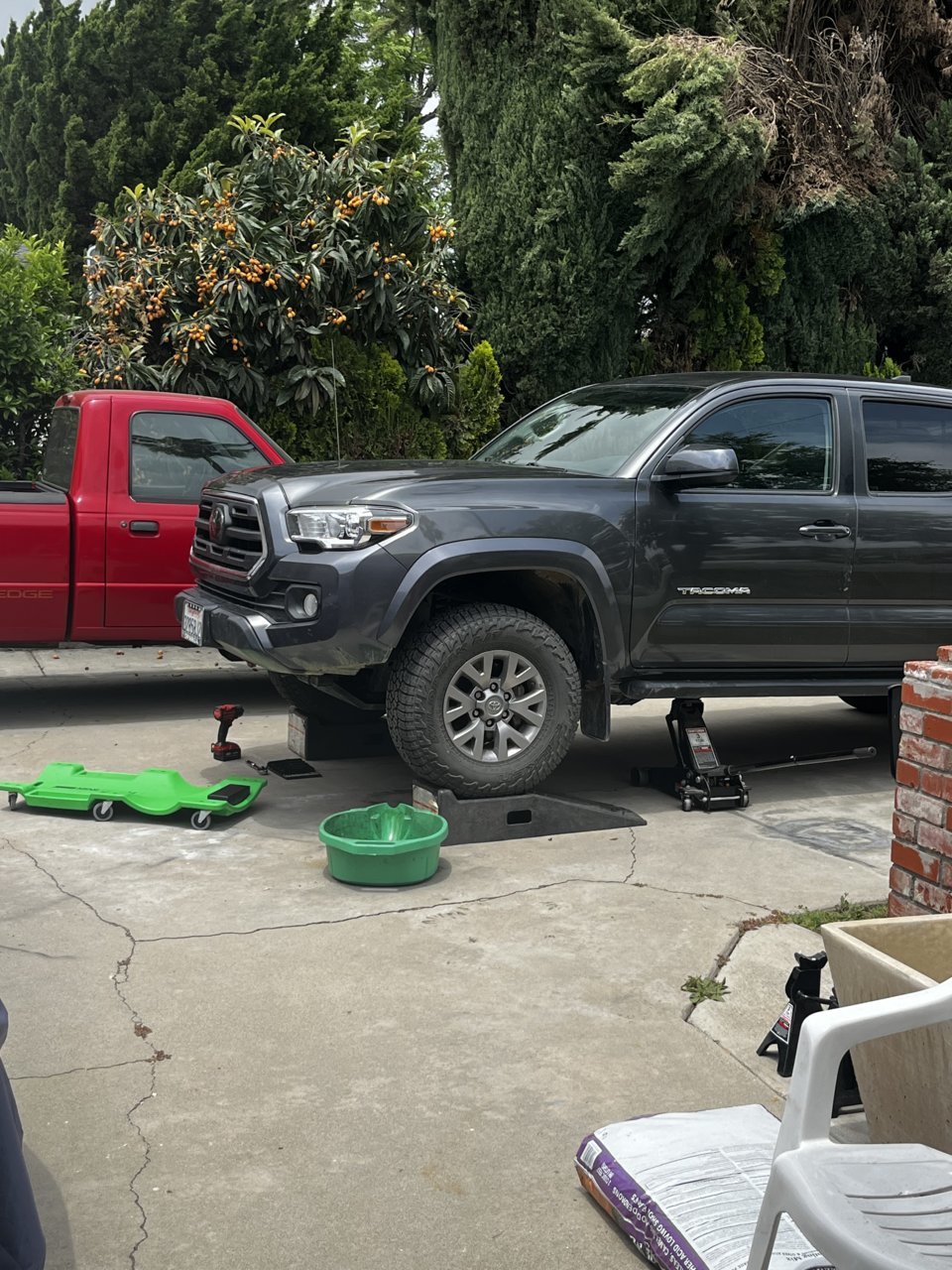

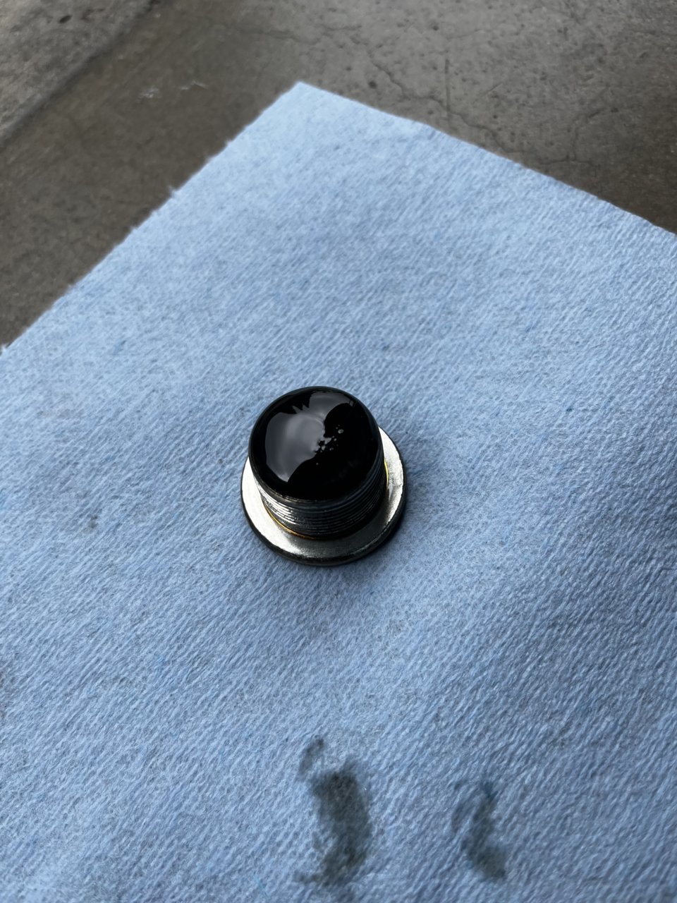

  15. May 24, 2023 at 3:14 PM
    #215
    Topanga Taco
    Topanga Taco BUZZING NITRO
    Jan 6, 2018
    #240465
    2,094
    Rick
    Topanga Strong Southern California
    2018 SR5 4x4 DCSB Harrop rear E-Locker
    The Magic of ALSD RCI-skid RAS-Sumos Bilstein 6112/5100
    Same here! Muchas Gracias yet again hometown.
    And super glad I used me bro’s shop, as my torque wrench wouldn’t allow for the hex bit to sit flush. This Mac did the trick :hattip:
