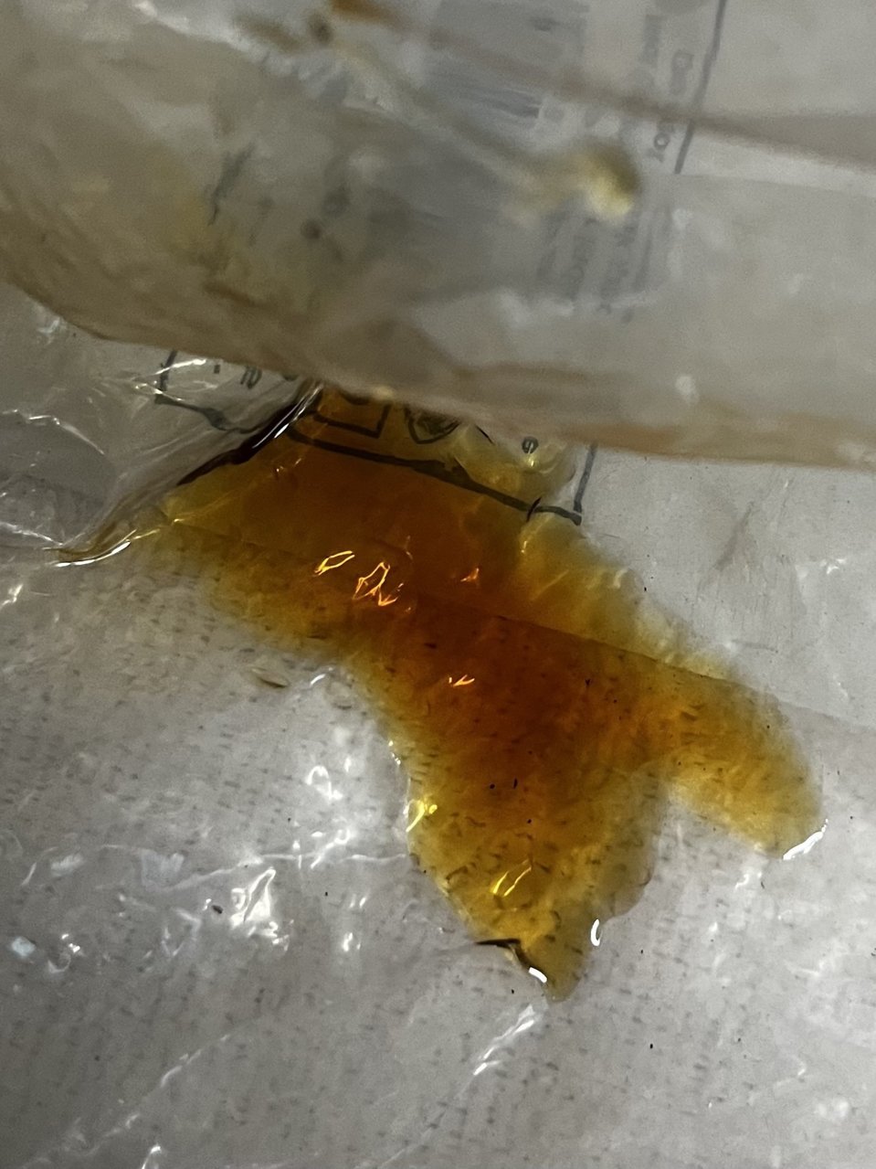

    Transfer case oil at 30,000 miles. Not bad, but glad I did it. $84 total ain’t bad insurance for the next 30,000.
    Yup…Thanks again for the push off the nest!!!!
    Next major one is the trans.
