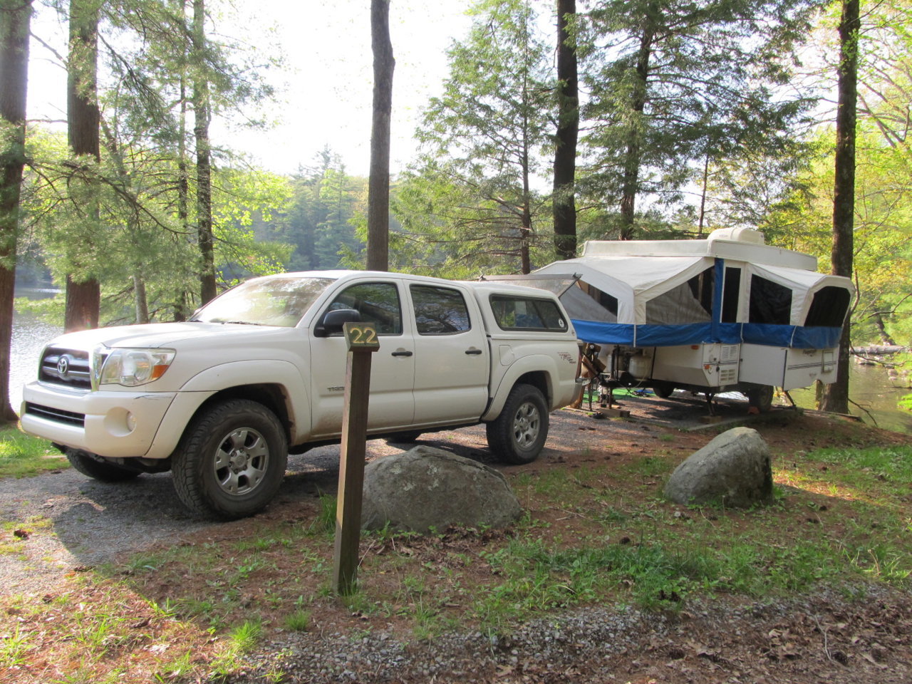

    Maintenance isn't always cheap insurance. If you actually do everything on those lists, and at the mileage they recommend; and if you take it to the dealer to do the work, you'll pay more for maintenance to get to 300,000 miles than you paid for the truck.
    2007 DC 4X4 bought new in August 2007. Currently at 238,000 miles. I have changed the oil myself at 10,000 miles using Costco synthetic and Fram filters. New shocks and struts at 125,000 miles after unusual tire wear. The diff and transfer case oil was changed at 170,000 miles. New alternator at 180,000. New headlight housings at 235,000. The headlight housings cost me $500. Everything else above was less than $1000. I do as much as I can myself, and an independent mechanic for the rest.
    New plugs and serpentine belt at 100,000 and 200,000. New rear brake pads at 200,000. Front pads have been changed 4-5 times. Still have factory drums and rotors but will need new rotors at the next brake job. Somewhere around 250,000. I've bought 5 sets of tires and 4 batteries. But all of those things are consumables.
    That's it. Never touched the transmission fluid and IF it goes bad I'll have it rebuilt for less money than I'd have spent on fluid changes. The hoses are still pliable; when they go bad, I'll replace them and the coolant at that time. I plan to take it to 400,000 and would drive it from GA to California and back starting tomorrow.
    Everything still works, it shifts into and out of 4X4 easily. The driver's seat is worn badly and there are some stains on the carpet and seats. There are a few dings and scratches and there is some minor paint peeling. But it still drives like new.
