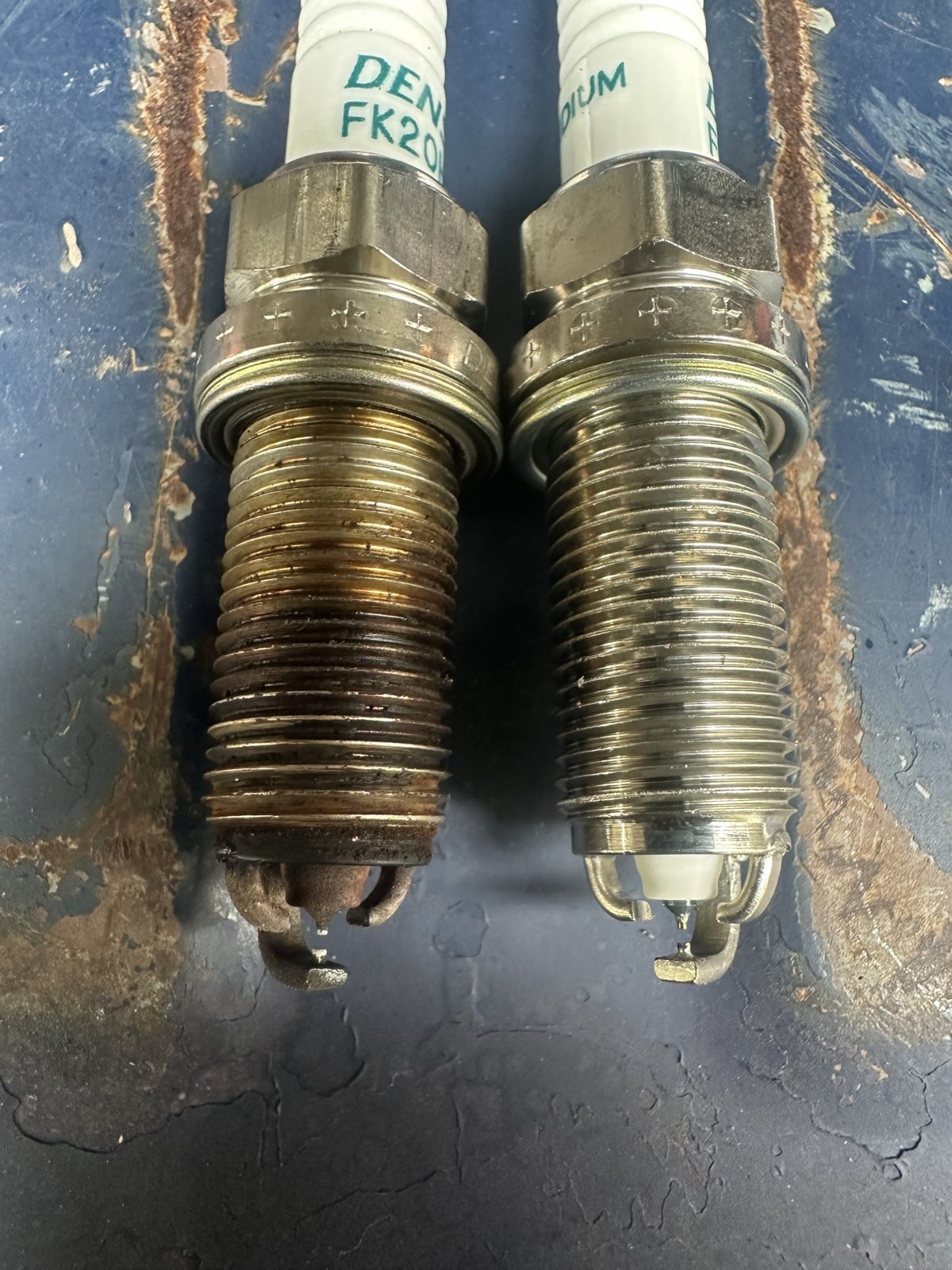

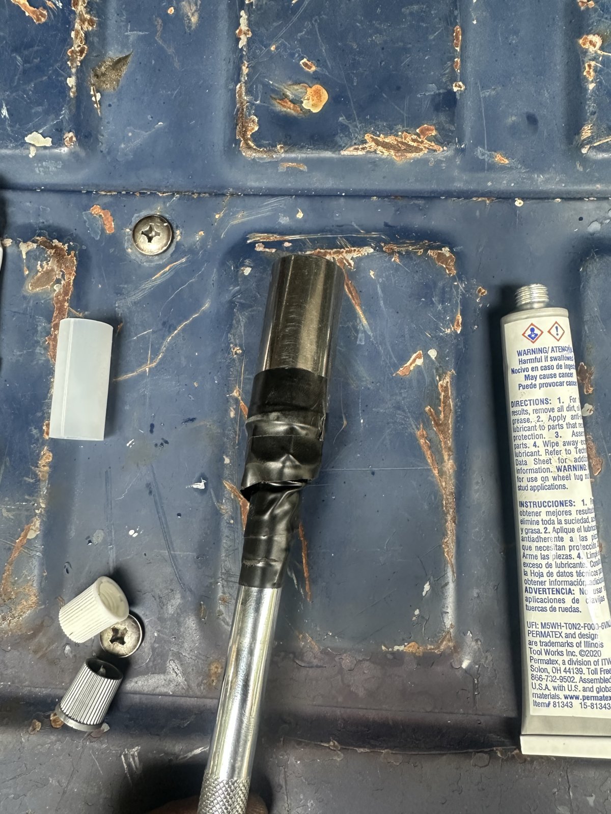

    Did my spark plugs today with the help of the video in post 1. Saved so much time knowing the tips on how to get to everything on the drivers side. Here’s 90k on original plugs and my trick to not loose the socket when you put new plugs back in.

    Awesome work and pics showing the difference between old and new. I'll tell you, I also used electrical tape... I just didn't wrap mine as tight as I should have that time and it left the spark plug socket down there when the extension pulled free. Had to go source some long needle nose pliers and a little bathroom drain grabby claw to get it out...
