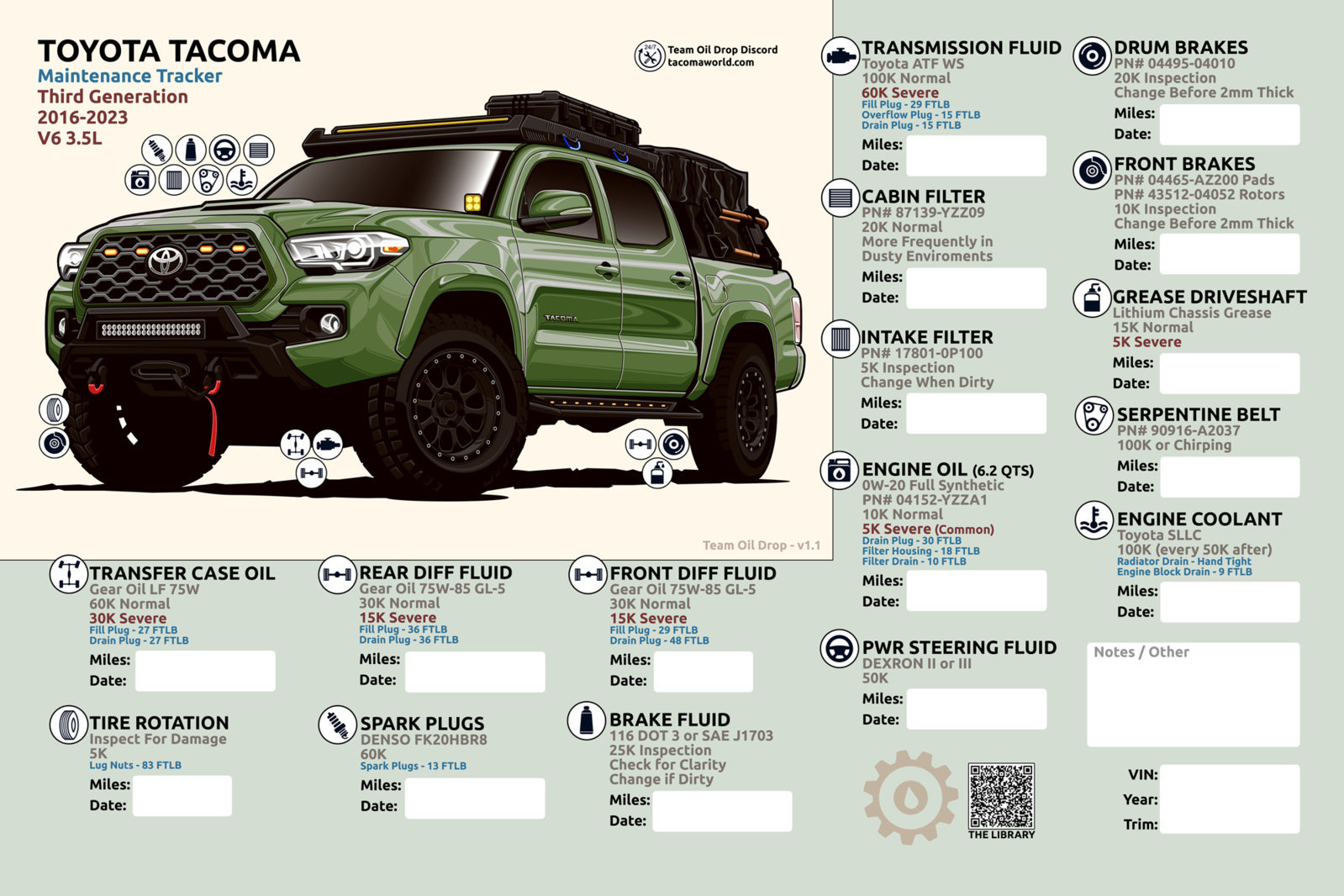

    How much gear oil should the rear differential take for a refill? I put 4 quarts in before it started to weep out the fill hole a little and if I put my pinky finger in the fill hole it felt level with the threads. Should I call that good to go?

    Weep hole is your max fill point! You did good. Fill until it leaks then seal it up!

    Excellent! I'm now done with my Tacoma maintenance for the day.
    Today I changed these items:
    Engine and cabin air filters
    Engine oil and filter
    Front and rear differential oils with SuperTech 75w90 synthetic. 6 quarts was a good amount to buy, I used all but 6 or 8oz. of the 6th bottle.
    Transfer case fluid with red line MT-LV
    I'm at just over 30,000 miles so I didn't seem to have any trouble with the fill and drain plugs like you say can happen in the videos. I did spray the plugs on the front differential with WD40 as those seemed like they might be trouble but came off easily.
    The videos were very helpful. Removing the spare tire is a good tip, it makes so much room to work and good time to check the pressure in that spare, mine was down to nearly 20 psi.
    I did the front fill with a hand oil pump for a quart bottle that worked well for me.
    Thanks for this thread and videos it saved me a lot already. Now time for a beer run.

    Outstanding! Love to hear the success stories. Remember to check the notes in the description when you get around to trans fluid since you are a 2020+. A six-pack of miller high life plz and thank you, I'll send my address in eastern Europe. (just messin, yall don't owe me nothin'. Brake fluid video SOON!)

    as for conversion, not exactly an easy thing honestly as the map is paced out entirely by miles. Unfortunately I recommend simply flipping your truck to miles to check or converting miles to km on your phone every now and then.

    Fresh out the oven, 11 colors to pick from, yours for free on the original post.

    not enough.
    Oh....I like this. all in one spot with all the links and everything. Major kudos and thanks!
