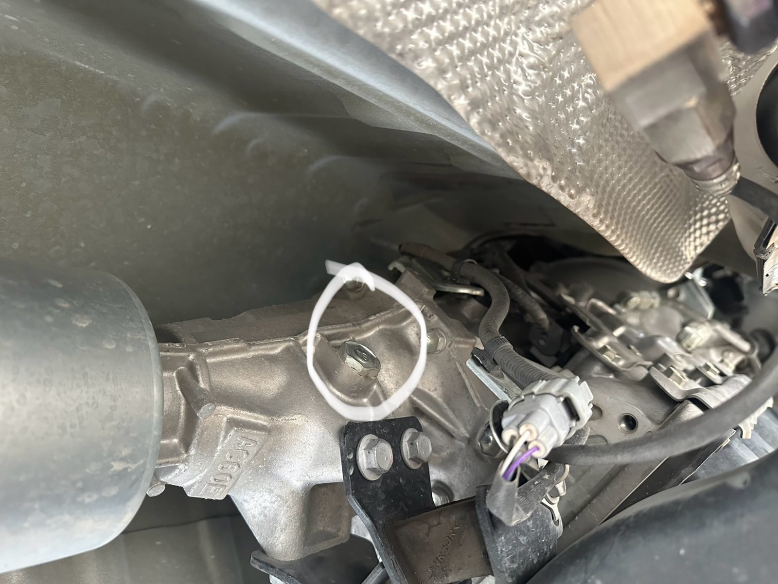

    @Soft Taco, do you know where the drain plug for transmission fluid is locate for a Tacoma 2021 4cl 2.7 SR is?
    I got this picture I think is this one that have WS bun unsure.

    That's the fill plug for the transmission. I'm not 100% sure where it is on the 2.7 but it should be on the black pan just below this. There should be a drain and a check bolt.

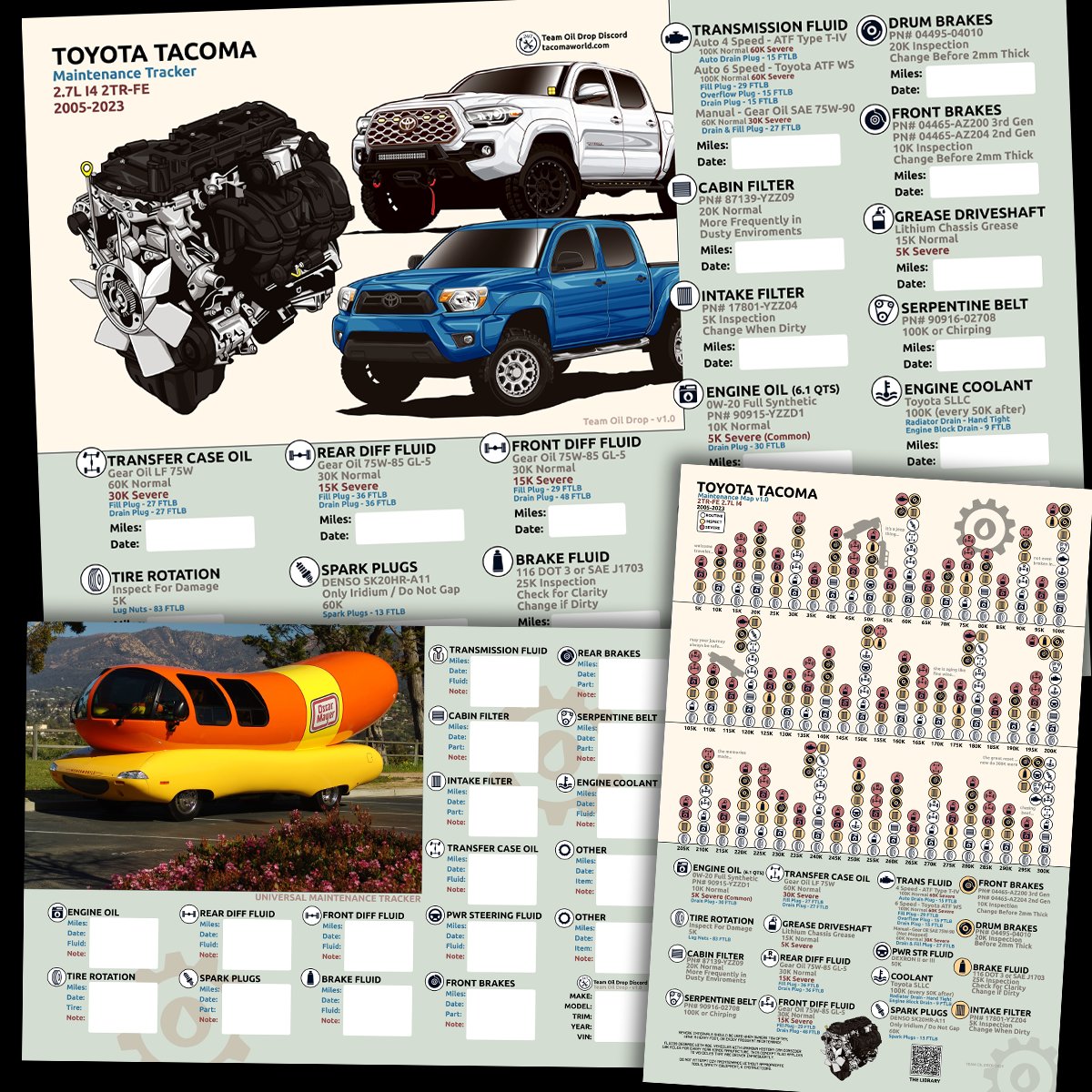

    2.7L Tracker and Map now available. Tracker HD download in original post. Also now have "Universal Tracker" available. Thanks everyone and sorry for the delays - Tyler
