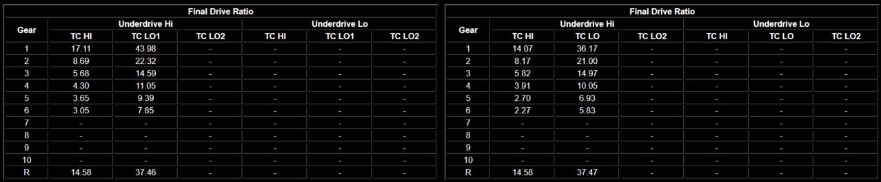

    The number of times this has been posted (a lot) is far greater than the number of times it has been true (zero)
    The differential gear ratio is lower on the manual but it also has proportionately higher transmission gear ratios, the overall gear ratio is negligible. Math is hard.

    Well . . . We only need to look at the first two gears since they'll both hit 60+ in 2nd.
    MT on the left, AT on the right:
    All stock numbers punched into http://www.grimmjeeper.com/gears.html
    I can do 8.0s runs pretty consistently. I did get a 7.2s once. I haven't tired on the new tires yet since good places (safe, no traffic, good sightlines, no cops) are not close by.
