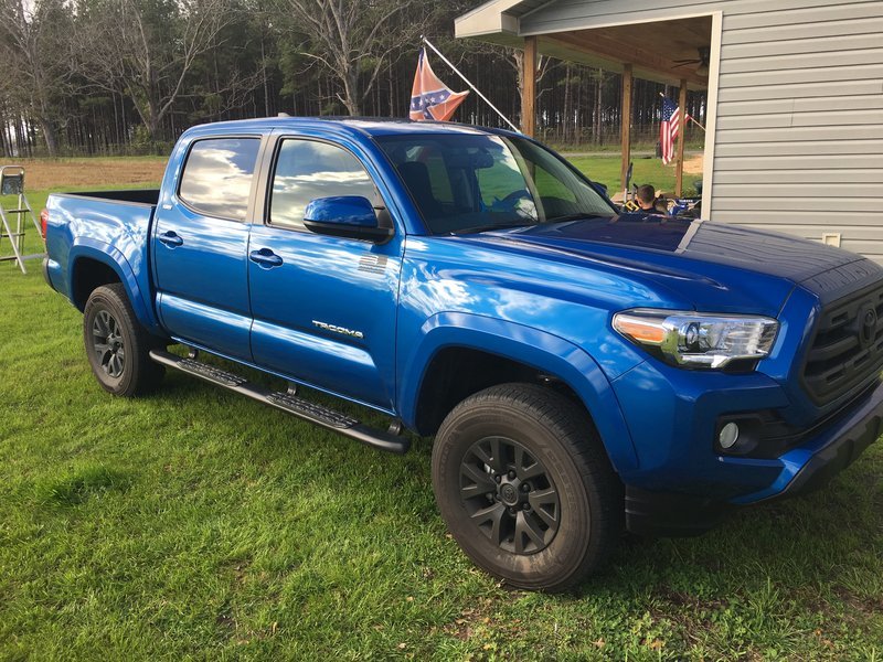

    IMG_0509.jpg bath, vinyl and picked up the rockstar 2's today, next kit and tires

    Nice! Looking forward to this!!!
