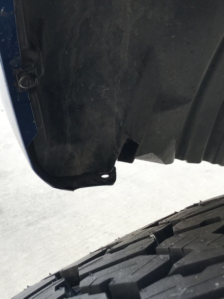

    @TacoMaxxxx Well I don't see any rub marks on the cab yet it's mainly on the corner of my fender well/bumper. I also rub when I come off a driveway too quick and turning left or right. I'd still like to go up to a 6.5 though, the 4" now feels like I'm at stock height lol here's a pic of what's rubbing up front, it's that tab where the screw is supposed to be.

    Would you rather go through the trouble of lifting the front and back and all that comes with it or take a dremel to that spot? Do you like the way a 6" lift looks better than a 4"?

    I've always wanted a 6" lift. Lifting won't be an issue or a lot of time wasted. The hard part (spindle install) is over. It won't take but 2 hrs at the max and get it done for a case of beer.
    The 4" was good for me at first and with my original wheel setup. Now that I have my new setup, the 4" isn't clearing well and isn't the look I want. Going up 2 more inches is good with me and will be exactly what I am looking for. I still plan on taking a dremel to it and knocking that piece off. Also heating up the plastic on the well and pushing it in some more.
