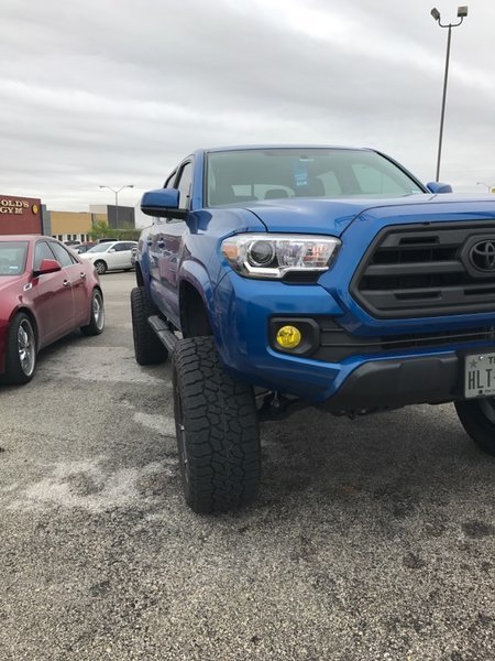

    3rd gen here...When I had my 4" spindle lift I fit 285/70/17 with no issues. I had barely enough spindle clearance just because I was still using the stock tss wheels (note: don't reuse the dust pan/shield). If you are keeping the stock wheel then I'd get .75" wheel spacers for front and 1.25" or 1.5" for the rear to make front/back even. (Note: spindles kick out front wheels .75").
    I now have 20x10 wheels with a -12 offset and 1.25" spacers in the rear only and they stick out even with the front.
    I had the spindles, 5100's front w/stock coils @ 0, extended length rear shocks, and Dakar pack. Truck sat leveled. I will post a pic in a bit. Now I went up to 6.5" lift. I love it.

    Pic on left is with new wheels and 4" lift. Middle and right pic is 285's and 4".

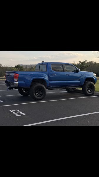

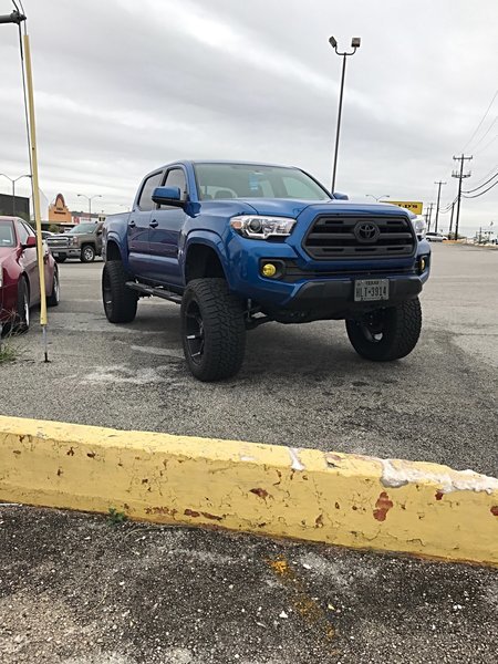

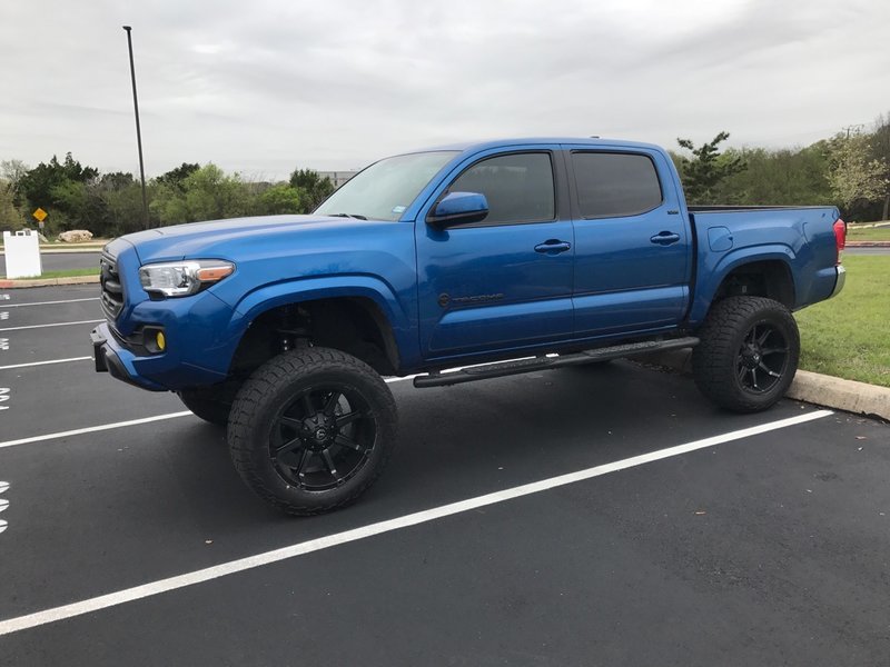

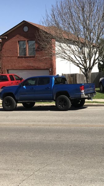

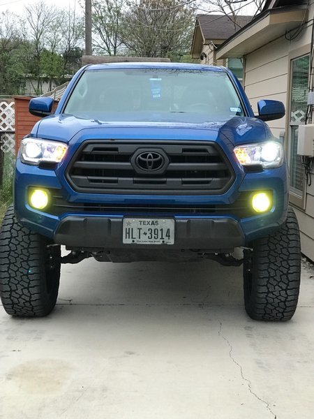

    Haha it's all good man I just passed another BBP trd on a 4-6" I believe and some ko2s lol looked good. But I actually got a full 3" out of the leaf pack believe it or not when I had just the 4inch lift lol I found my stock measurements and re-measured and I gained a total of 5inches (now with my 6.5" lift) in the rear with 2" blocks. With the spindles and the leaf pack only I was dead leveled. Now I have a sliiiight lean but can't even tell lol.

    lol I'll pm you. Here's pics of the truck now :)
