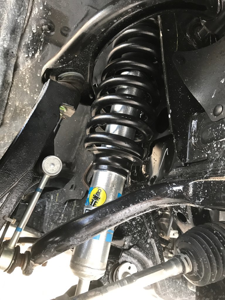

    Alright so got the 4" spindles installed today with the 5100s all the way around and a 2" block for the back but it definitely doesn't look right someone wanna help me out with why this leans so bad?The guys trying to tell me HS may have sent me a 6.5" spindle and i told him they don't even make em. But this lean is significant he said something like 5" and the shocks looked like they were still on the stock setting though. Also gonna need shims but he will let me know what degree tomorrow when he measures but thats normal. He also said that my lugs aren't deep enough so they aren't really grabbing the studs enough and i need some deeper ones. Anyone else have this problem, trying to find some deeper ones but not having much luck at the moment.

    Are you using factory tacoma springs ? if yes, your spring seat on the 5100 might be flipped upside down (happened to someone in this thread), giving you more lift on the front, also the clip should be set at the lowest position to only give you 4" from the spindle. Is the rear lift block 2", do you have the box, part number, or did you check the measurement ? It almost looks like no lift in the rear. The lugs you are looking for are called et lugs (extended thread) common problem for tacoma.

    Damn my lean wasn't that bad!! You're ring might be on the top notch to be having that bad of a lean. It needs to be set on the very bottom notch and make sure the spring seat is the correct way.

    Spring seat is on upside down and its on bottom notch surprisingly looks like the 2" block isnt even there

    X2. Have the spring seat flipped and all will be good.

    Yupp exactly what it is. And if you want change out the 2" and get a 3" and that'll get rid of the lean look.
