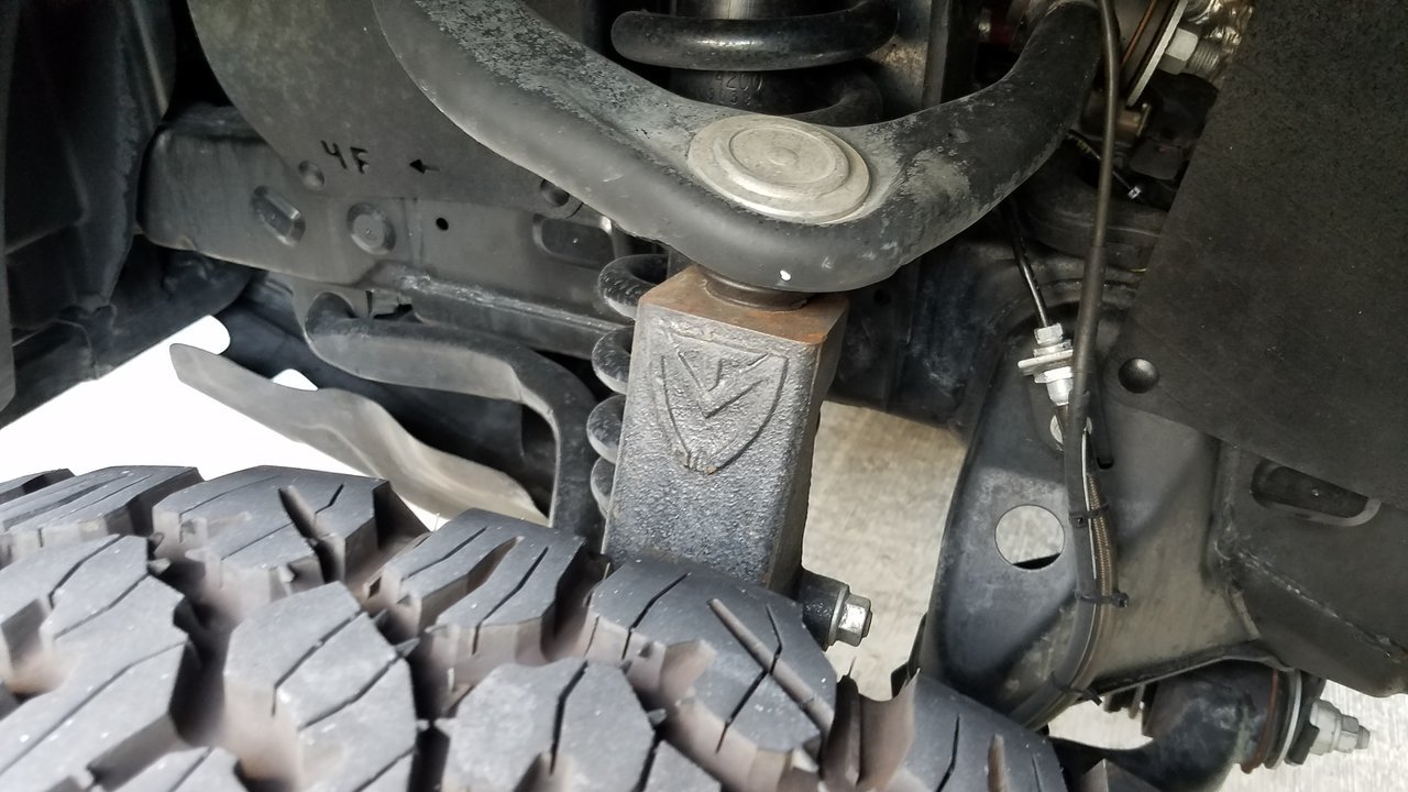

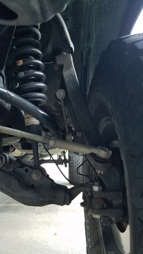

    Has to be a taller spring, likely OME as mentioned earlier. I went with the 885's myself because I don't plan on doing a plate bumper.
    Forgot a couple crucial things.
    1) The Maxtrac spindles will rust like a mofo (as you see on that guys truck). The coatings that come on them are crap. Lightly sand/scuff the shine off then paint in the color of your choice, and/or clear coat the shit out of them.
    2) Use anti-sieze on everything. When you pull apart the front, you'll likely find rust. I had rust and I only had like 7k of road driving on the truck. It's like Toyota doesn't use any...whatever.
    Godspeed.
