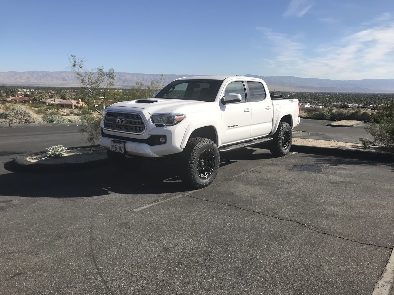

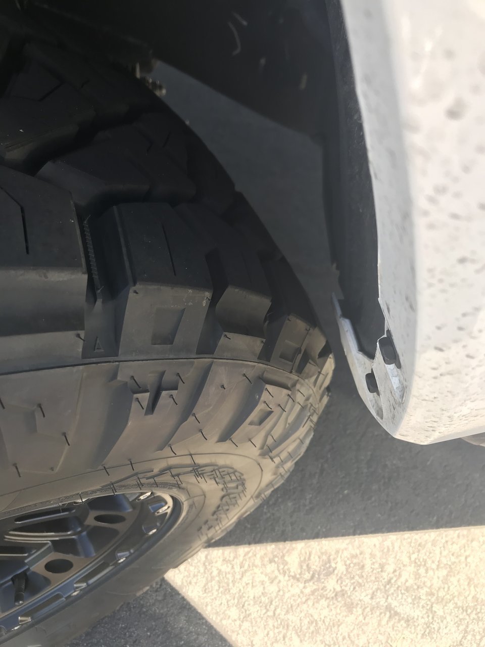

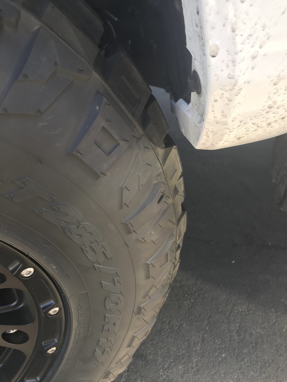

    My friend! I just put my Maxtrac 4incher on the Taco with some 285s. Are you rubbing at all? I seem to be cutting it a little close. Been a little hesitant on the tight turns in case I rip something up.

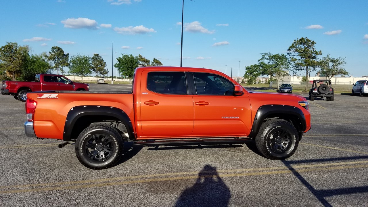

    Looks like I can officially join the club!

    Looks awesome!!​

    Ahh my man! With the 4 incher on 285s you’re going to be cutting it really close without any trimming. Sometimes I will catch some rub as I’m reversing out of a driveway in full lock. This doesn’t happen very often though, especially once you get the feel for it!
