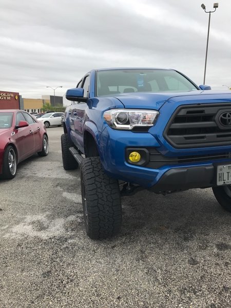

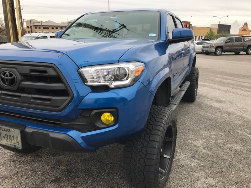

    Maxtrac spindles OME 885s Bilstein 5100s all around (adjustable front/extended length rears) Maxtrac rear blocks Headstrong Taco lean spacer OME CBD SS brake lines InsaneFab CMC 18x12 Fuel Hostage 35x12.50 Maxxis AT 1.25" Spidertrax spacers in the rear Llumar Ceramic Tint (5% Rears & Back / 18% Fronts / 50% Windshield) Toyota Tri-Fold bed cover and OEM bed mat Triple Black Clazzio seat covers WeatherTech laser fit or whatever the fuck they call em Probably other stuff...
    #TBT to my install...a picture says it all.

    I would like to keep my stock 17" rims (just like the black ones you had) but go to 285's-
    - will they rub AT ALL if I only go 4"? -
    Can't do it, you'd at least need spacers. You need 4.5" of backspacing to clear.
    - do I need new struts for the front with 4" spindles? - Not sure here. I don't think so, but 5100's are so cheap I'd never skip out on this.
    - do I need Dakar heavy duty or regular for the back + extended length Billies? - No idea. Marie should know this.
    - do I need CB drop with only a 4" lift? - I think so. Marie can verify.
    - basically what's my optimum set up for keeping my 17" and going to 285's? - Gut feeling says 4" spindles on stock springs with an AAL in the back and you'd be dead level and clearing 285s with minimal trimming.
    If I decide to go to 6" (or is it 6-1/2")-
    - will it look stupid with the 17" + 285"? I believe you ran this setup for a little while correct? -
    Yes. Never skip leg day, bro.
    - good idea to add Billies to the front with the HBS strut spacers? - Skip the spacers, just get springs. You're already in there, and springs are a couple hunnit.
    - all I will be adding is a 2" block to the Dakars in back correct? - Not sure here, I'm on 4" Blocks on stock springs for now. Custom leaf packs will come later.
    - CB drop? - Mandatory.
    - drive shaft spacer? - Mandatory.
    - anything else I'm missing? - The HeadStrong Maxtrac 6" "Kit" will cover you. From there it's a matter of do you want to add springs or change shocks.

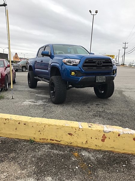

    I know your photo from this post is a year old, but what size wheels/ tires are you running with your 4" in this picture?

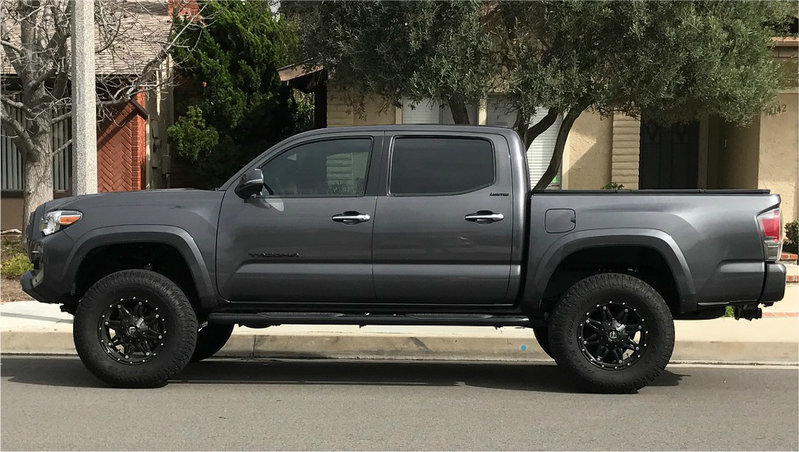

    Leo4x2, when you first did your 6" didn't you run your stock 17" TSS for a bit? All you added to your 4" to get to 6.5" was HBS 2.5" spacer in front and 2" block to the Dakars out back, correct?

    I'm around 6.5" in the front, 4" in the back currently. I used OME coils (from Marie), I hate suspension spacers.
    If you scroll back through this thread I probably put more details. It's been a while so I may not remember everything off the top of my head, but I believe this thread is the place to be.

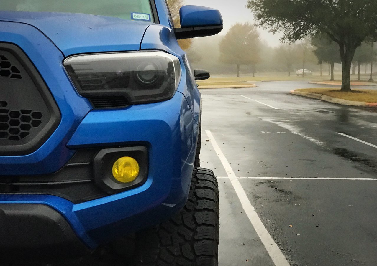

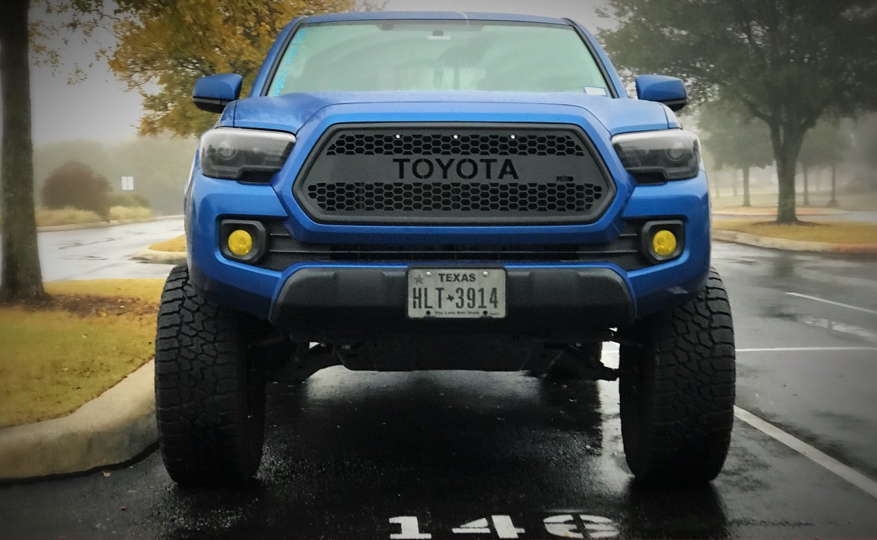

    Maxtrac/Bilstein suspension 16x8 Pro Comp 69 315/75/16 Dick Cepek Morimoto Profile Prism RGB Halos & Demon Eyes
    Needed updated pics :cookiemonster: will take more this weekend after a good wash/detail

    Pure awesome right there. Is the one on the right from a 1975 tercel or what lol! :p

    If I just looked at that pic at random, I would never guess that dinky little thing was from a brand new truck. It looks like it needs a sandwich.
