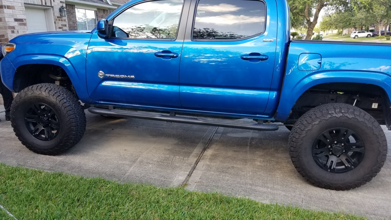

    Here are the photos...

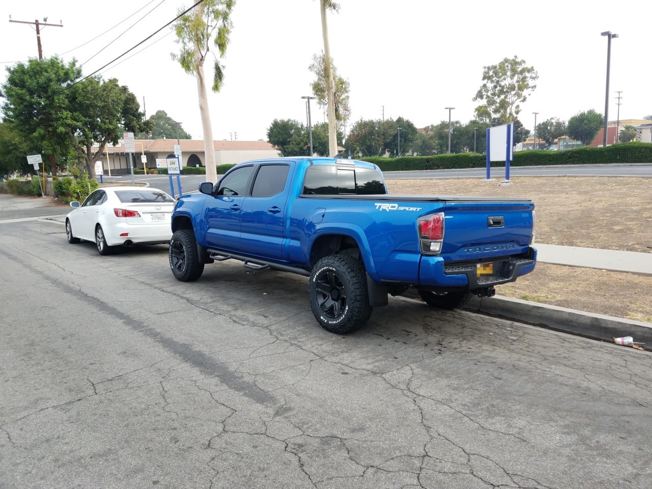

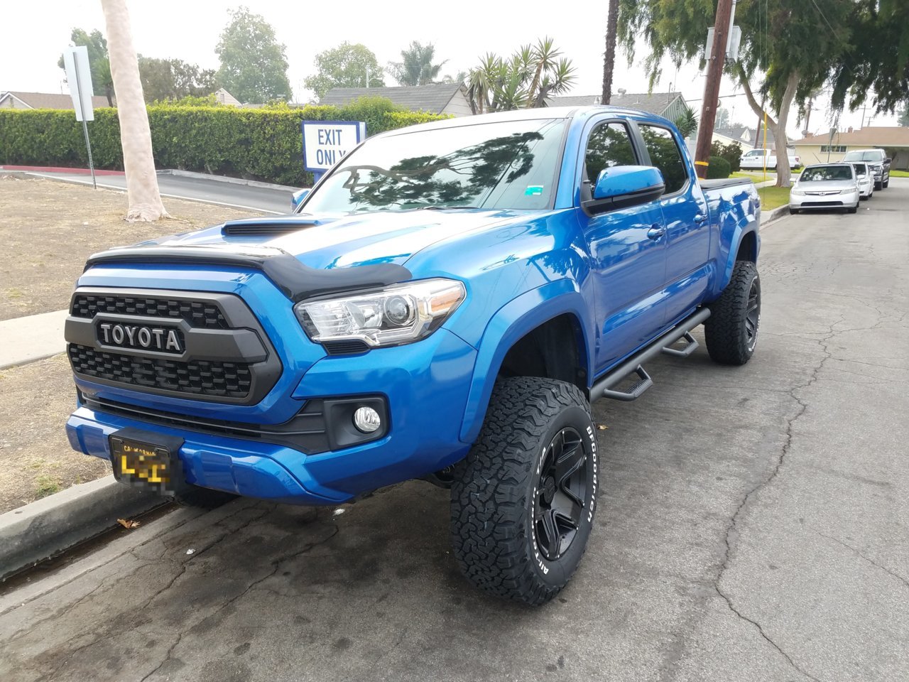

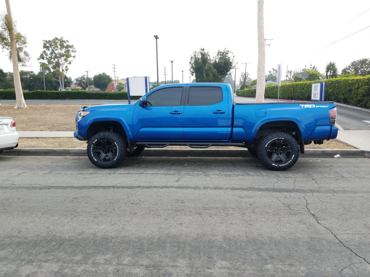

    20180805_074442.jpg 20180806_084415.jpg 20180805_213340.jpg A coupe days ago I installed Maxtrac 4" spindle lift kit (I used the extended brake lines, U-bolts, and included hardware), medium duty OME Dakar full lift replacement leaf packs (I did not use the Maxtrac lifting blocks from the kit), leaf spring bushing kit suggested by @HeadStrong Off-Road , Bilstein 5100 struts set at 0, 5100 extended length shocks (instead of the Maxtrac rear shocks from the kit), Maxtrac kit 616800 (carrier bearing drop, rear brake line extension, and parking brake cable extension), and BF Goodrich LT 265/70R17 KO2 tires, and 3/4 inch wheel spacers on the rear wheels to even them out.
    I feel the truck the the truck drives like a dream now. Wouldn't change a thing. Now the suspension feels nice and firm, but not too firm. My friend has the complete Maxtrac 4" lift kit installed, and I have to say that the OME leaf packs and Bilsteins make a huge difference.
    Big thanks to @HeadStrong Off-Road for answering all my questions and giving me a great deal on all the parts.

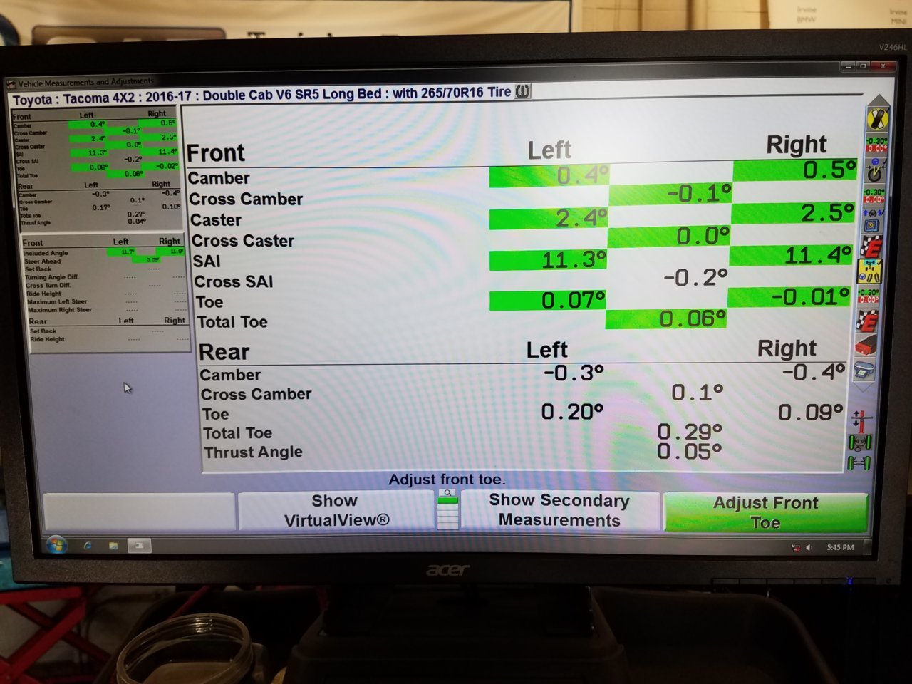

    One thing I forgot to add about that 4"spindle lift kit is that my caster and camber didn't even need to be adjusted. I just had to set the front toe and everything looked good.20180804_180248.jpg
