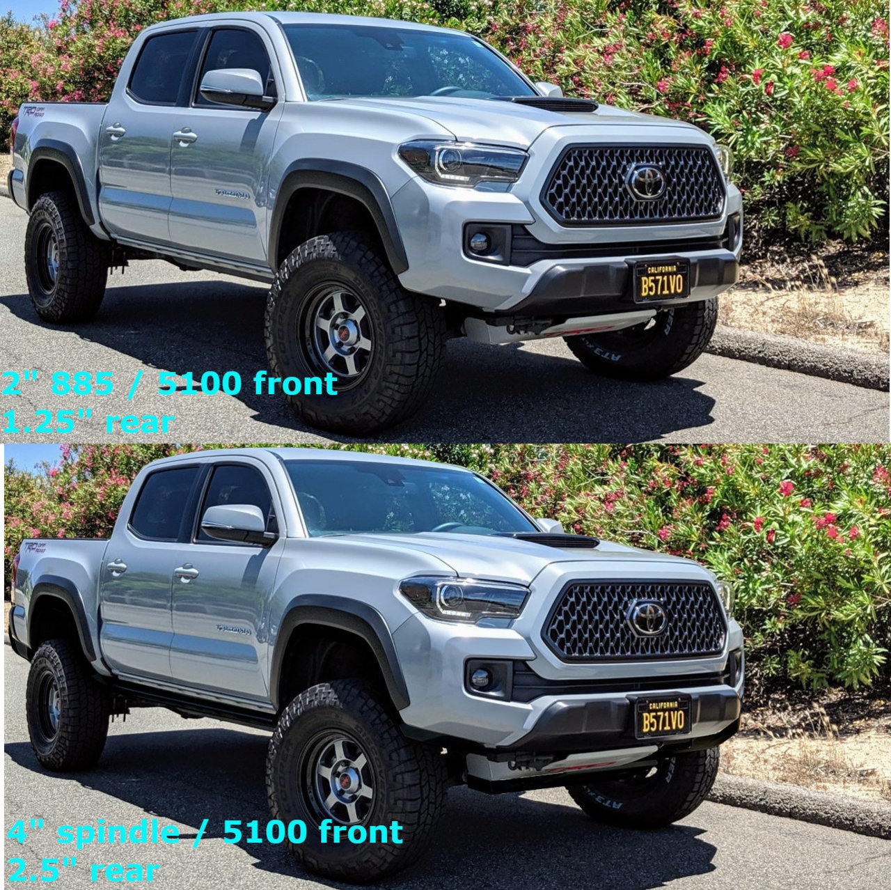

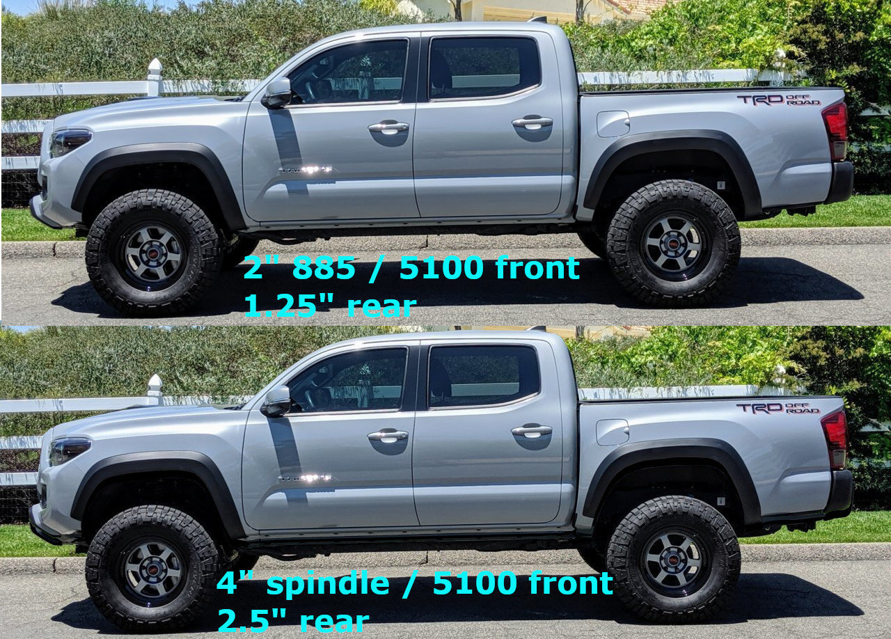

    My RWD TRD OR is sitting on 2" front (885/5100) and 1.25" rear. I've priced it out and I'm just about to pull the trigger on going to 4". Definitely hit up Headstrong if you are getting the spindles, especially if you are in SoCal and can pick up- it's worth it. After I sell off some of these parts, my net costs are only a few hundred.
    I photochopped what the truck looks like currently versus what it will look like with 4". It looks more proportional to the 285/75s with the 4" for sure. This is for anyone deciding between 2" or 4".

    Are you gonna keep the 885 springs on when you add the spindles? Or go back to stock? I currently have the 885 as well on my longbed. They settled way too much and I’ve been considering the spindles.
  20. Jun 13, 2019 at 9:54 PM
    #620
    dal3_gribble
    dal3_gribble Well-Known Member
    Apr 14, 2018
    #250494
    1,201
    Crew Cab SB TRD Offroad
    I agree the 885 springs have settled. I'm going back to stock springs. I would be really happy with the 4". I might keep the 0.25" strut spacers on (.5" lift) butb that's it.
