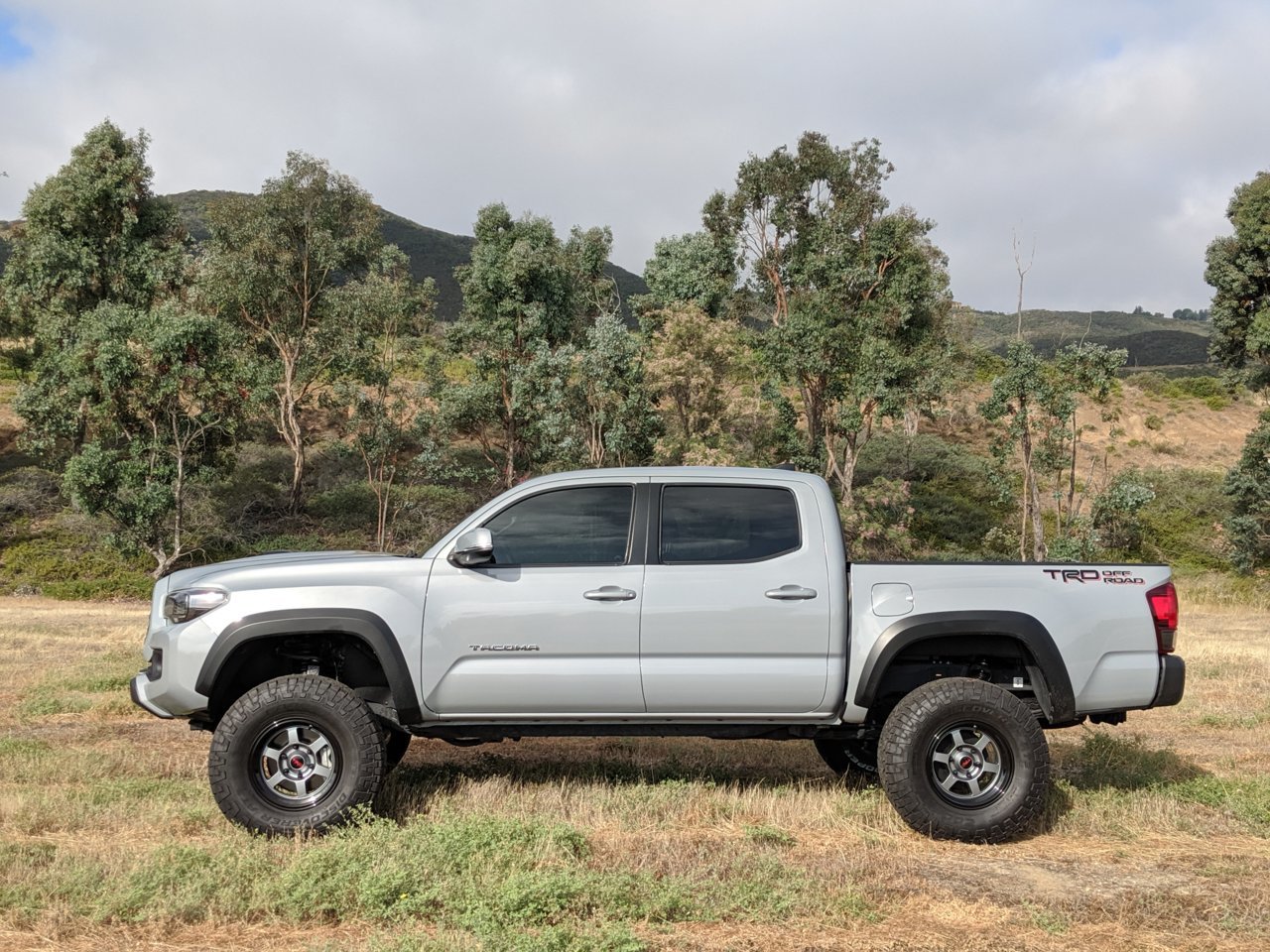

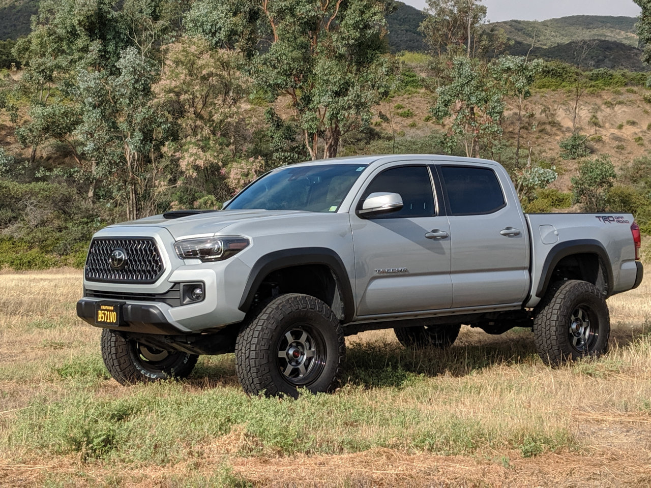

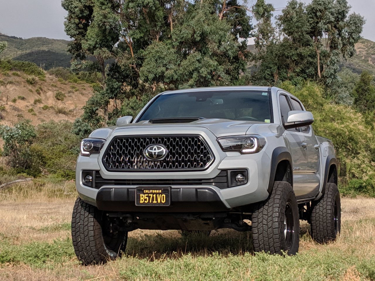

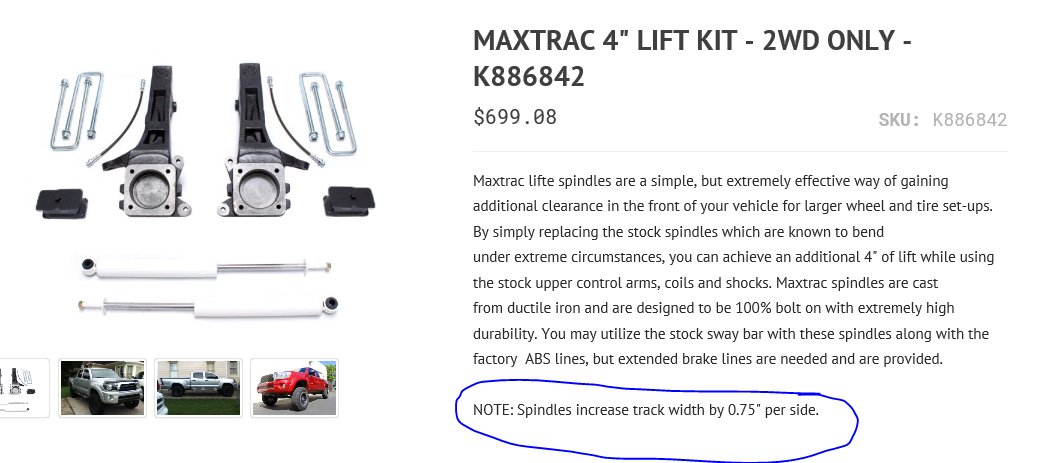

    Here's my final pictures. Again, 4", 5100s at 0 on stock springs, rear 2.5" (block and add-a-leaf), 285/75R16. It looks so fawking good. That extra inch and stance really make the truck stand out and the driveability definitely went up versus the 2.5" lift before. 0 regrets. Also, there's no way I'm going higher than this, 4" is perfect for me. Also personally, I would run as close to 0 offset of a wheel as possible (right at the 4.5" backspacing), because that 0.75" track width kickout will push the tires out pretty far by itself. All 2WD guys wanting to go 3" should definitely go this route. It will cost less and it looks amazing.
    Edit: I also put 0.75" wheel spacers in the back to even the track width out.
    VR812, 13txtaco, SubCultureNM and 5 others like this.

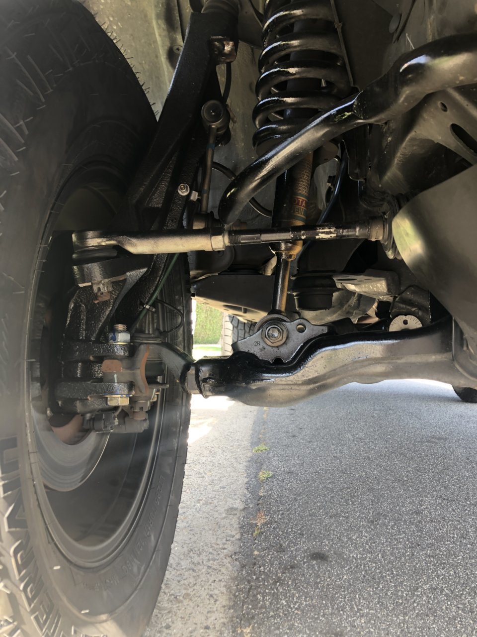

    Hey guys I just had the maxtrac 4inch spindle installed a few weeks ago and have had 2 alignments done and still have the bump steer issue. Has anyone else had this problem with the maxtrac spindle lift?

    I don't have anything like that. What's bump steer feel like on this?

    It wants to go slightly right and over bumps it jerks a little bit. I have to take it to get retorqued would that fix the issue?

    Definitely have them go back through everything. I wonder if they put the steering ends upside down or something...

    Yeah idk the whole reason I went with spindles is so it wouldn’t change the ride quality or mess with the geometry but it definitely feels like it has

    Mine felt 1,000x better than 2.5" from springs after spindles. Something is wrong with install.

    Maybe take some pictures, specifically of the steering ends and how they bolt to the spindles.

    I am also wondering if this happened. If the 3rd gen spindles are like the 2nd gen ones, then the outer tie rod ends need to be inverted during install @Tjw30

    Also, what is the width/offset on your wheels? I wonder if they are rubbing the a-arms?

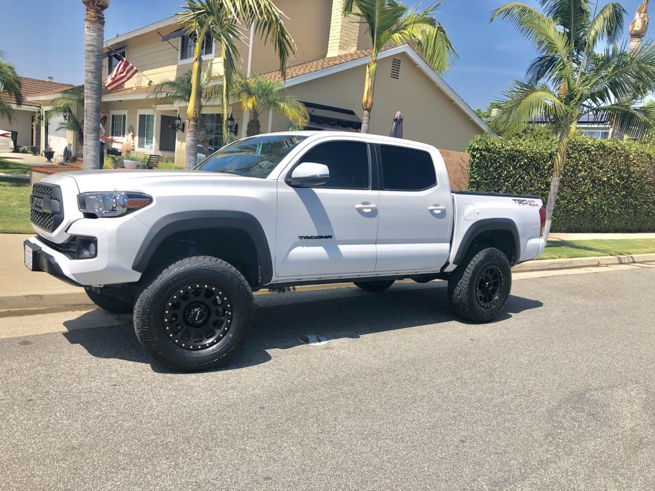

  14. Jul 3, 2019 at 3:58 PM
    #654
    Tjw30
    Tjw30 Member
    Jun 6, 2019
    #295581
    24
    Trent
    2017 white Toyota Tacoma Trd off road
    No mods yet

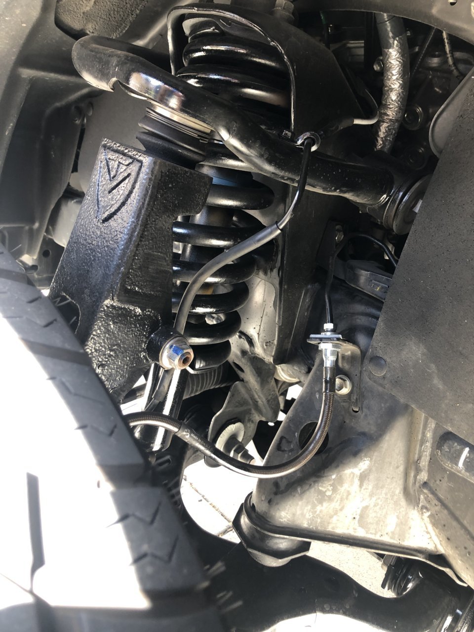

  15. Jul 3, 2019 at 4:07 PM
    #655
    dal3_gribble
    dal3_gribble Well-Known Member
    Apr 14, 2018
    #250494
    1,201
    Crew Cab SB TRD Offroad
    Take a picture of the steering links from the front
  16. Jul 3, 2019 at 4:15 PM
    #656
    Tjw30
    Tjw30 Member
    Jun 6, 2019
    #295581
    24
    Trent
    No mods yet

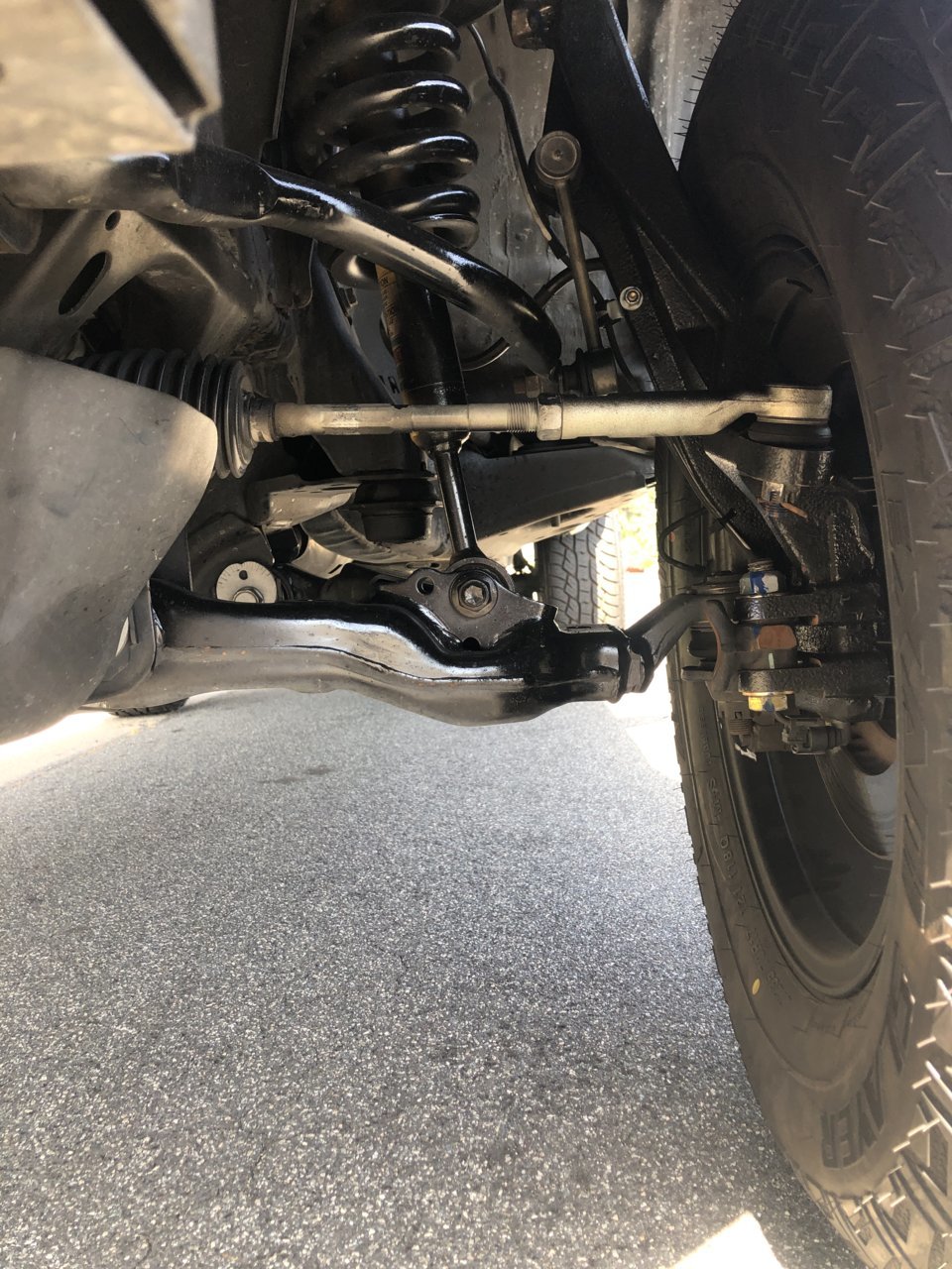

  17. Jul 3, 2019 at 4:21 PM
    #657
    dal3_gribble
    Apr 14, 2018
    #250494
    1,201
    Other side?
  18. Jul 3, 2019 at 4:23 PM
    #658
    Tjw30
    Tjw30 Member
    Jun 6, 2019
    #295581
    24
    Trent
    No mods yet
    Does that side look right? I’m sorry I’m new to all this that’s why I was hoping the spindles would cause less of a headache I appreciate your help man
  19. Jul 3, 2019 at 4:23 PM
    #659
    dal3_gribble
    Apr 14, 2018
    #250494
    1,201
    So far, nothing is jumping out at me. Let's see the other side.
