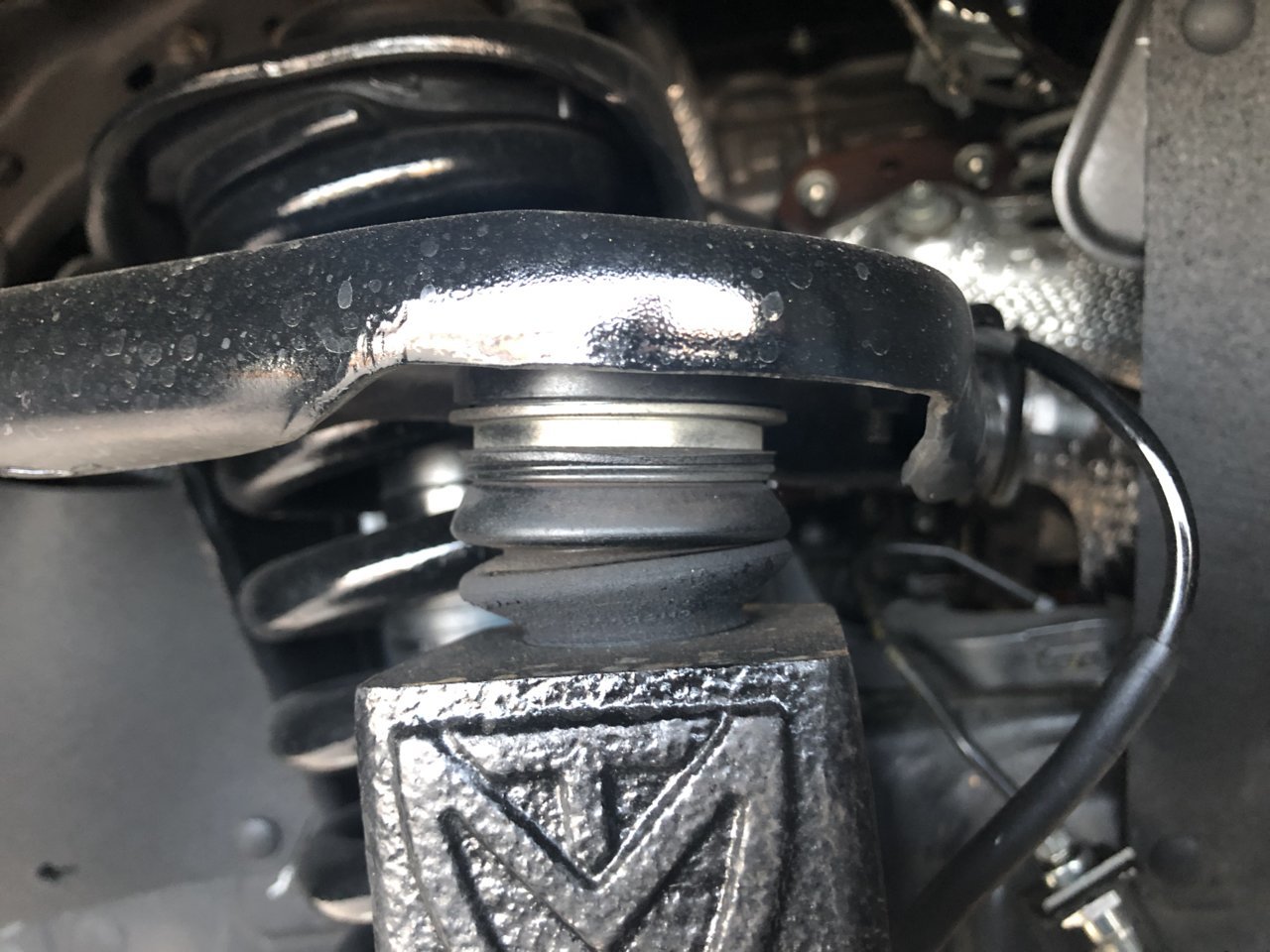

    I studied the pictures. Nothing is jumping out at me at all... Every piece of the suspension needs to be checked/re-torqued of course.
    Do you have a copy of the alignment specs after the spindles were installed?

    Yes I do, it also hasn’t been retorqued yet he said to wait after 500 miles so I’m going back for that tomorrow. Would that fix the issue?

    I don't think it's going to fix bump steer unless something wasn't tightened right. Anyways, just FYI, the maxtrac spindles don't cause any bump steer by themselves. They should feel exactly like stock since the suspension and steering geometry is all stock. That's the beauty of them.

    Yeah that’s what I thought going into it that nothing was going to change. Hopefully the tightening fixes the issue otherwise idk what it is

    In your opinion does it look like they were installed correctly?

    I didn't see anything obvious. Steering links were right. Why is it all spray painted black?

    To match my whole black and white look I was going for. I’m gonna replace the front suspension with fox 2.0 to match the back anyways

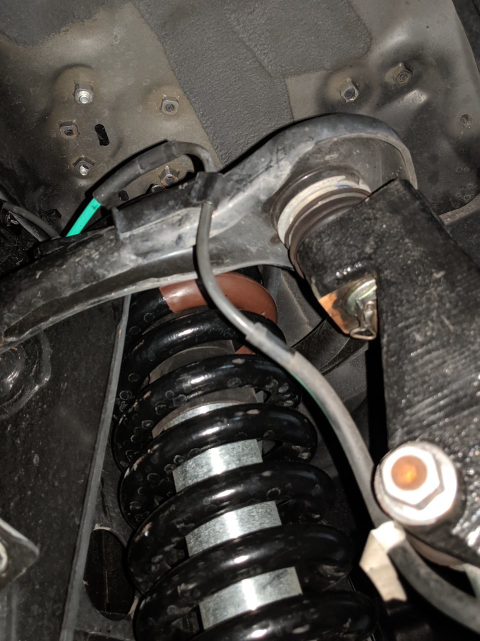

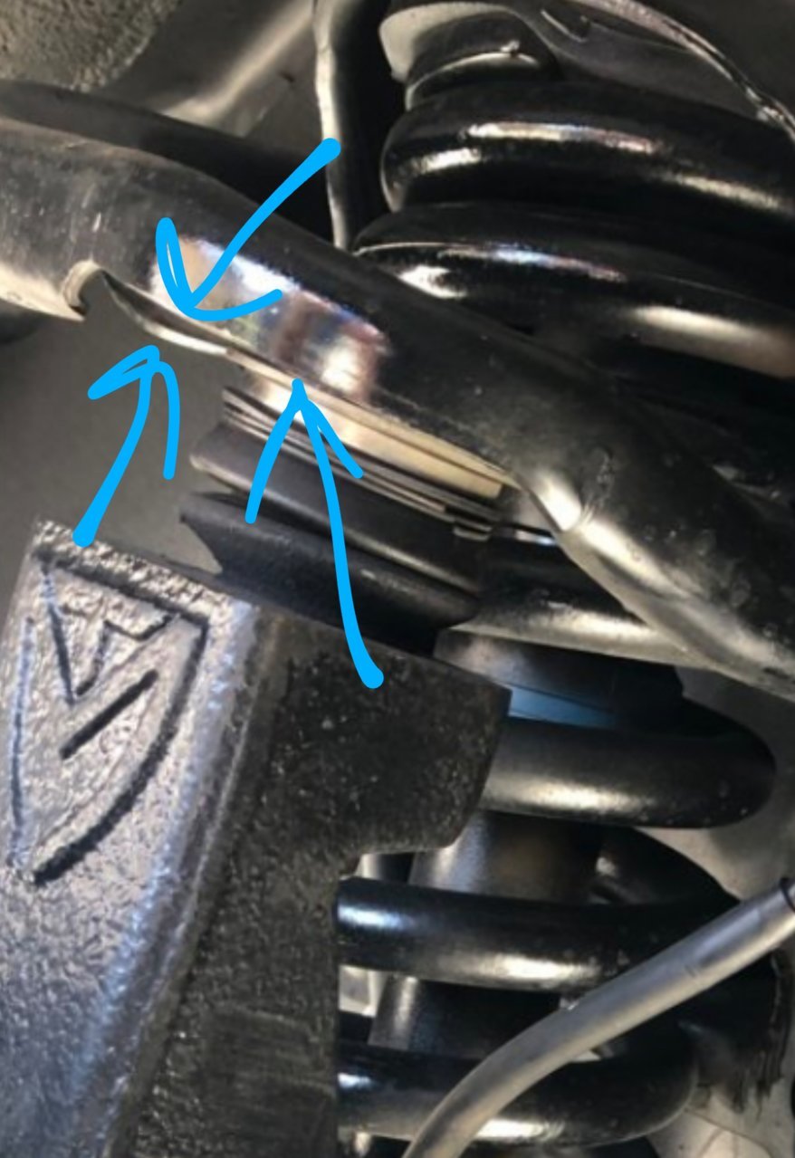

    There is definitely something weird about your upper back joint on driver side. What is up with that plate between the ball joint on bottom and upper a arm? Look at mine. Mine doesn't have a plate there.

    Dafuq is that plate?

    That’s just the angle I took it at I think
