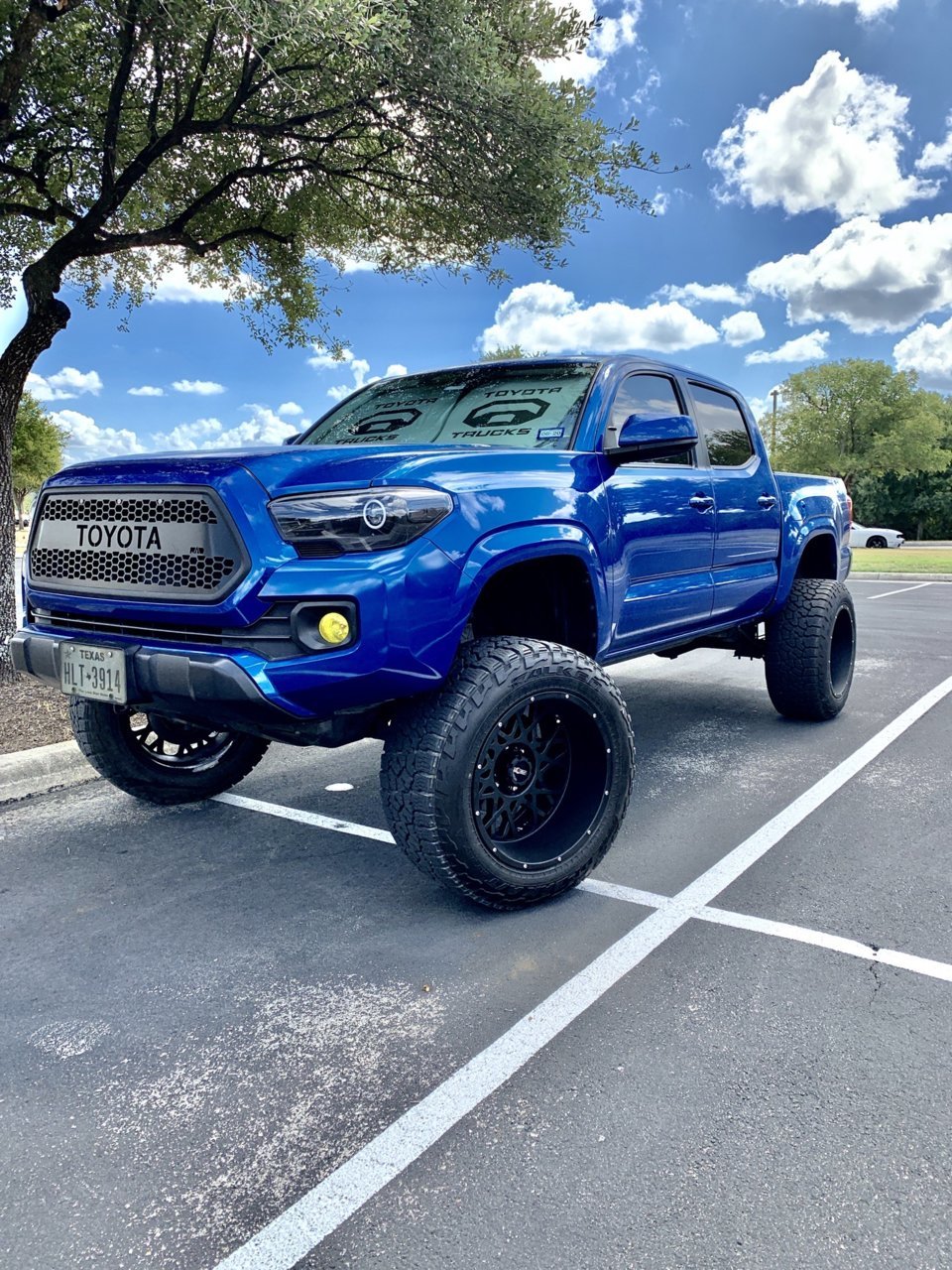

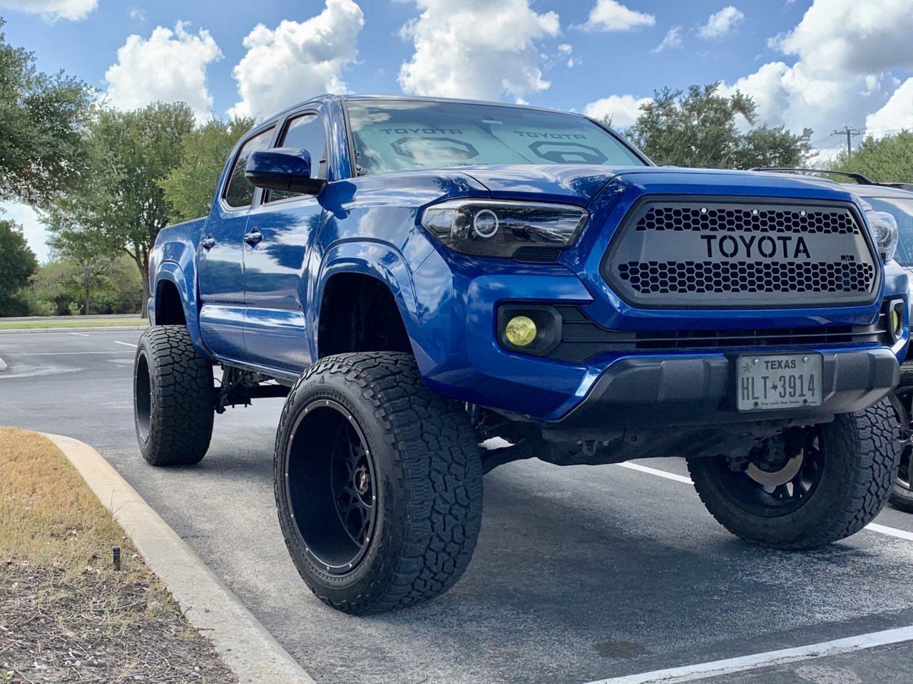

  15. Nov 1, 2019 at 7:27 AM
    #695
    Leo4x2
    Leo4x2 Well-Known Member
    Jun 29, 2016
    #190855
    1,418
    Leo
    San Antonio, Tx
    2016 Toyota Tacoma SR5
    Maxtrac/Bilstein suspension 16x8 Pro Comp 69 315/75/16 Dick Cepek Morimoto Profile Prism RGB Halos & Demon Eyes
    20902111-26A4-41E3-B5D6-86151D0CEB8E.jpg 5F987B15-E087-40F9-8A49-714A722BEDE2.jpg

  16. Nov 1, 2019 at 7:30 AM
    #696
    FTXDon
    FTXDon Member
    Jun 11, 2019
    #296077
    9
    Your truck looks sick man! What part of Texas you from? Fort Worth here
    Leo4x2[QUOTED] likes this.

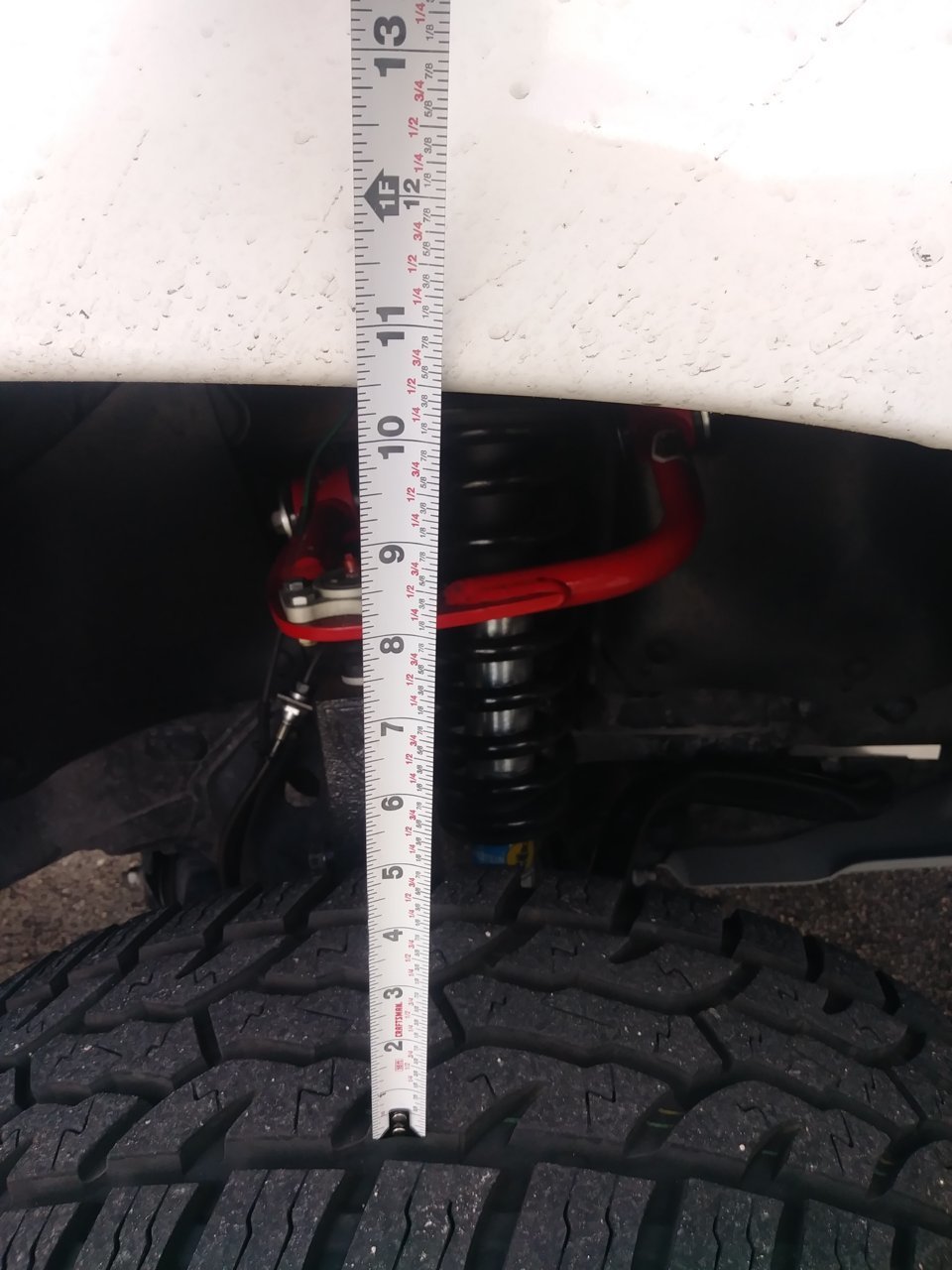

    Anyone know what’s the biggest tire I can fit with the 4inch lift?

    WOW! Awesome truck, man! Can you please take the measures from the top of the tires to the fender on the front end? Like in this photo! Thanks, man! And again, beautiful truck!
