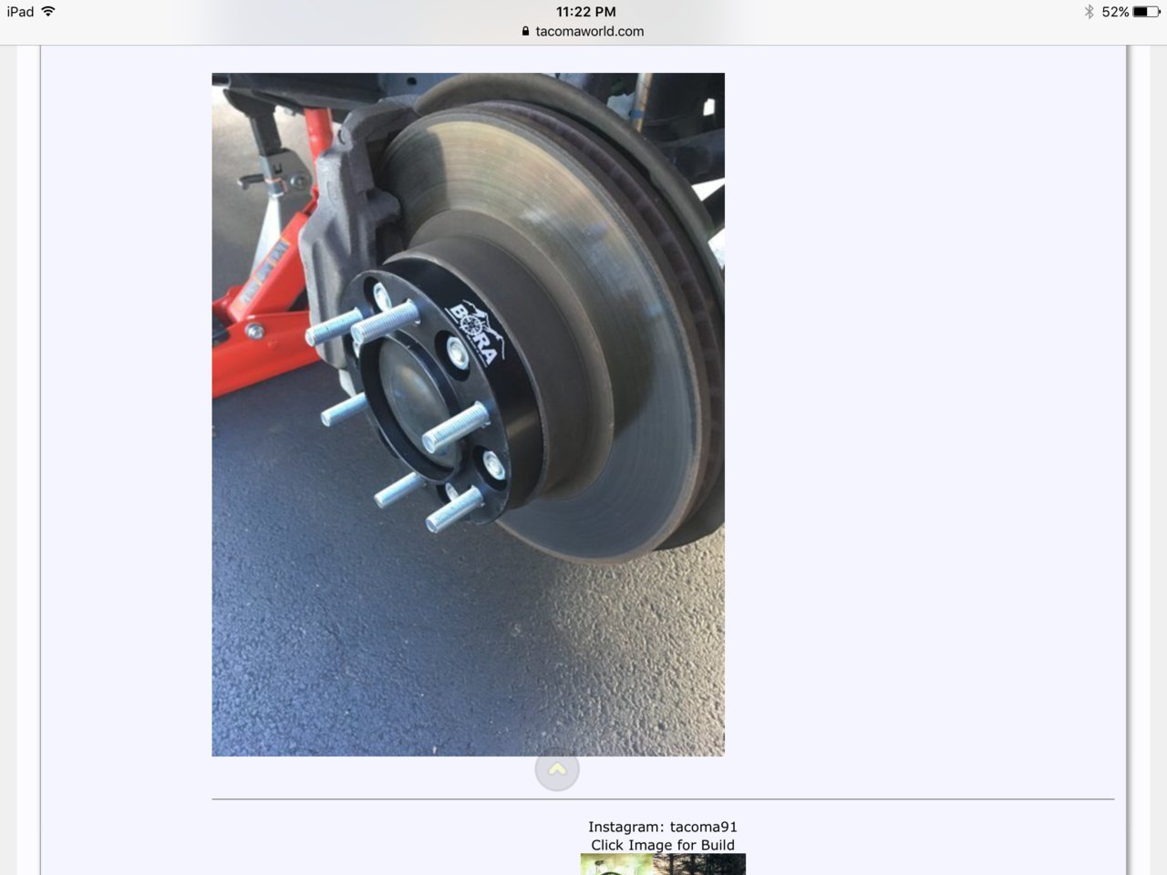

    Did you need to trim your stock studs in order to fit the .75 wheel spacer?

    I’m on 305/55/20 wheels and they were pretty close to the spindles. So I put on some 1.25 wheel spacers and now they rub on the cab mount. If I get the .75 wheel spacer will the rub go away? I did not have any rubbing before the wheel spacer but now I do.

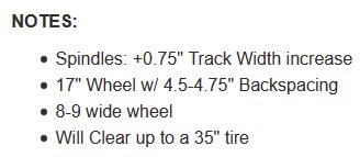

    “MAXTRAC SUSPENSION DOES NOT ADVISE USING WHEELS WIDER THAN 9" OR WHEELS WITH LESS THAN 4.5" BACKSPACING. DOING SO WILL RESULT IN VOIDING ANY AND ALL MANUFACTURER WARRANTIES”
    I was assuming they only put that for warranty purposes. They clear just fine.

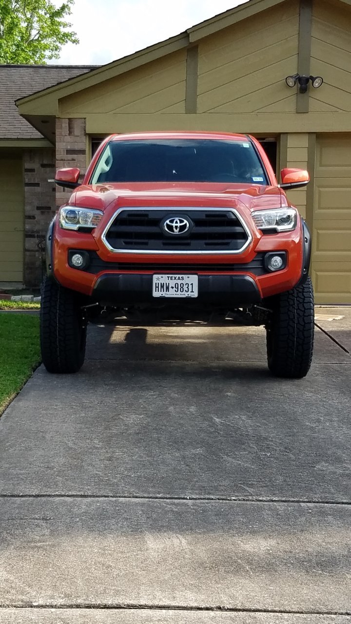

    I did a thing
    Maxtrac Spindles
    285/70/17 Falken AT3K With KMCKM541 wheels
    JBA UCA's and 5100's set for 0" lift
    Now I just gotta order a new AAL to even out the back!
