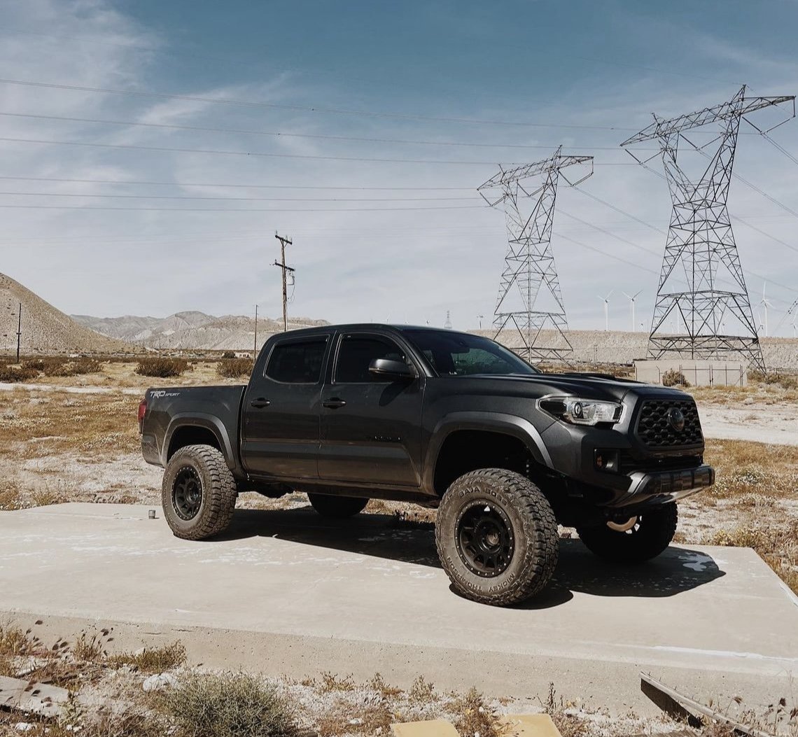

  13. Mar 14, 2024 at 9:37 PM
    #933
    joms
    joms Well-Known Member
    Feb 8, 2024
    #443406
    54
    2021 Super White Tacoma SR5 2wd
    Bone stock baby
    upload_2024-3-14_21-35-29.jpgAm I the only one digging this cali lean spindle lift? lol checked out his ig and looks like his setup works for high speed dirt runs. Is this type of lean bad for the truck? Asking for a friend

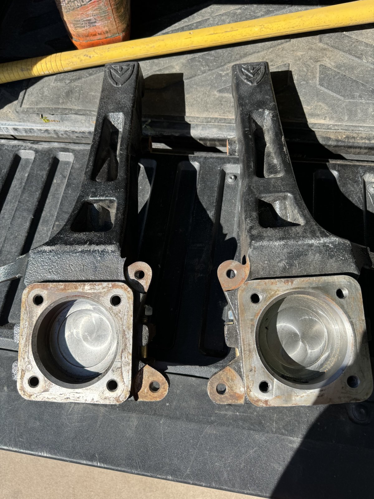

    Picked these up locally for $150!!

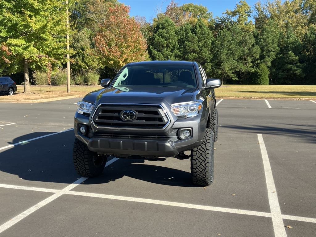

  15. Nov 5, 2024 at 11:44 AM
    #935
    fastprostreet
    fastprostreet Well-Known Member
    Oct 11, 2008
    #9893
    71
    Pete
    Lancaster SC

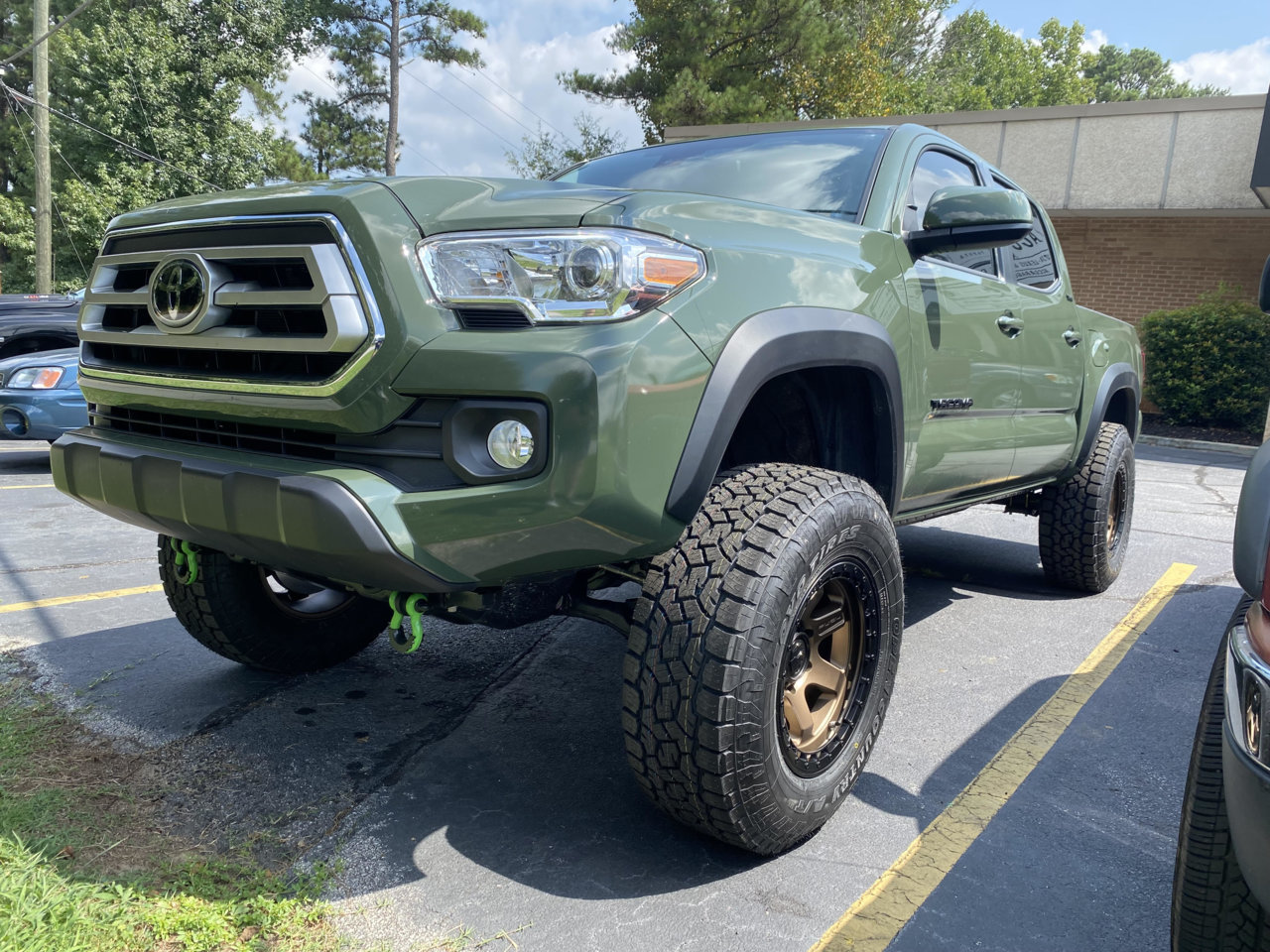

    My new to me 2023 SR5 access cab. Added lift / wheels tires.

    Super nice truck! I have the exact same combination in my hands and I wonder how you did with the JBA's in alignment? Supposedly the JBA's have too much caster for the spindles keeping the factory suspension geometry. I know this is from a while back and I apologize for that, but can you remember what the alignment numbers were? The camber should be about -0.2 or - 0.3 I would imagine.

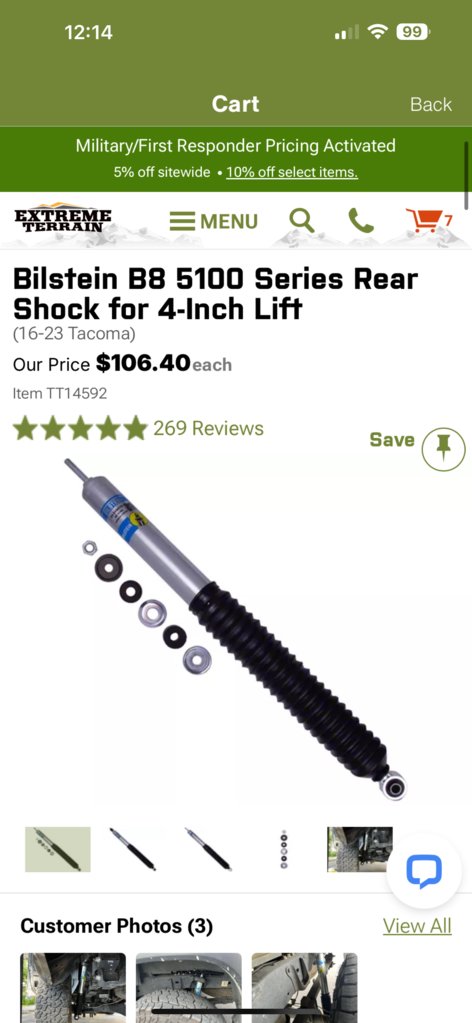

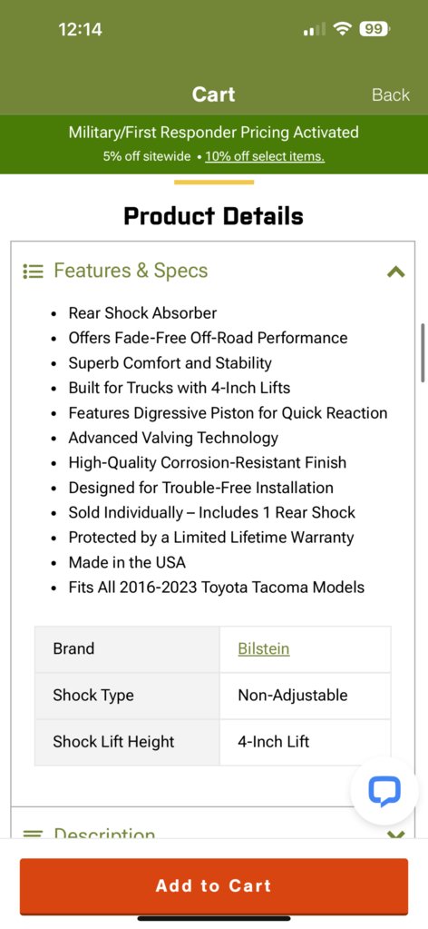

    For a 4 inch spindle has anyone used these 4inch lift 5100s? Supposedly it’s made for a truck lifted 4 inches? Just haven’t seen anyone that’s really using it.IMG_1758.png IMG_1757.png

    Assuming those are Bilstein 5100 part #F4-BE5-B110-T5, they should work well (4-6-inch rear lift, 27.28" ext. length, 16.34" coll.).
    They should fit without any other mods if you're simply lifted with the MaxTrac blocks in the rear.
    If you have lifted leaf springs and/or add-a-leafs (and blocks shorter than 1.5" or no blocks at all), it's possible you'll need to extend your rear bump stops to avoid the (longer) shock from being damaged when the suspension compresses.

    Thank you for the help! Essentially this is non compatible with the stock rear end? Looking at ways to level out the rear

    Not quite sure what you are asking... ?
    If your rear suspension is not lifted at all, then no, those shocks won't work. You need to have the rear lifted 2.5" up to a max of 6" for those shocks to work.
    Keep in mind most suspension lifts don't actually lift the rear as high as they do the front (which is true of the MaxTrac kit as well). I believe the 4" MaxTrac kit's blocks are 2.5", so yes, those shocks should work. If you are wanting to restore the factory rake (rear being a slight bit higher than the front when unloaded), a pair of 2" lift leaf springs would work well for that (this while keeping the Maxtrac blocks in place). I have Icon RXT leafs myself, but there are other quality options available too (Dobinsons and Deaver come to mind).
    I forgot to mention in my last post, you'll also need extended brake hoses to go with the longer shocks as well.
