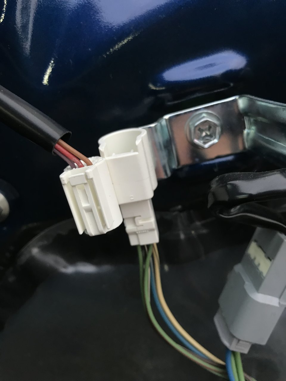

    Here is a picture of my plug on my 2015
    How would attach the 3rd gen plug into this?

    You have to depin the plug on the old mirror side and put it on the new mirrors.

    Ahh I see what your saying. I have to depin the 2nd gen mirror plug and place those wires into the new 3rd gen mirror plug after I depin that one.
