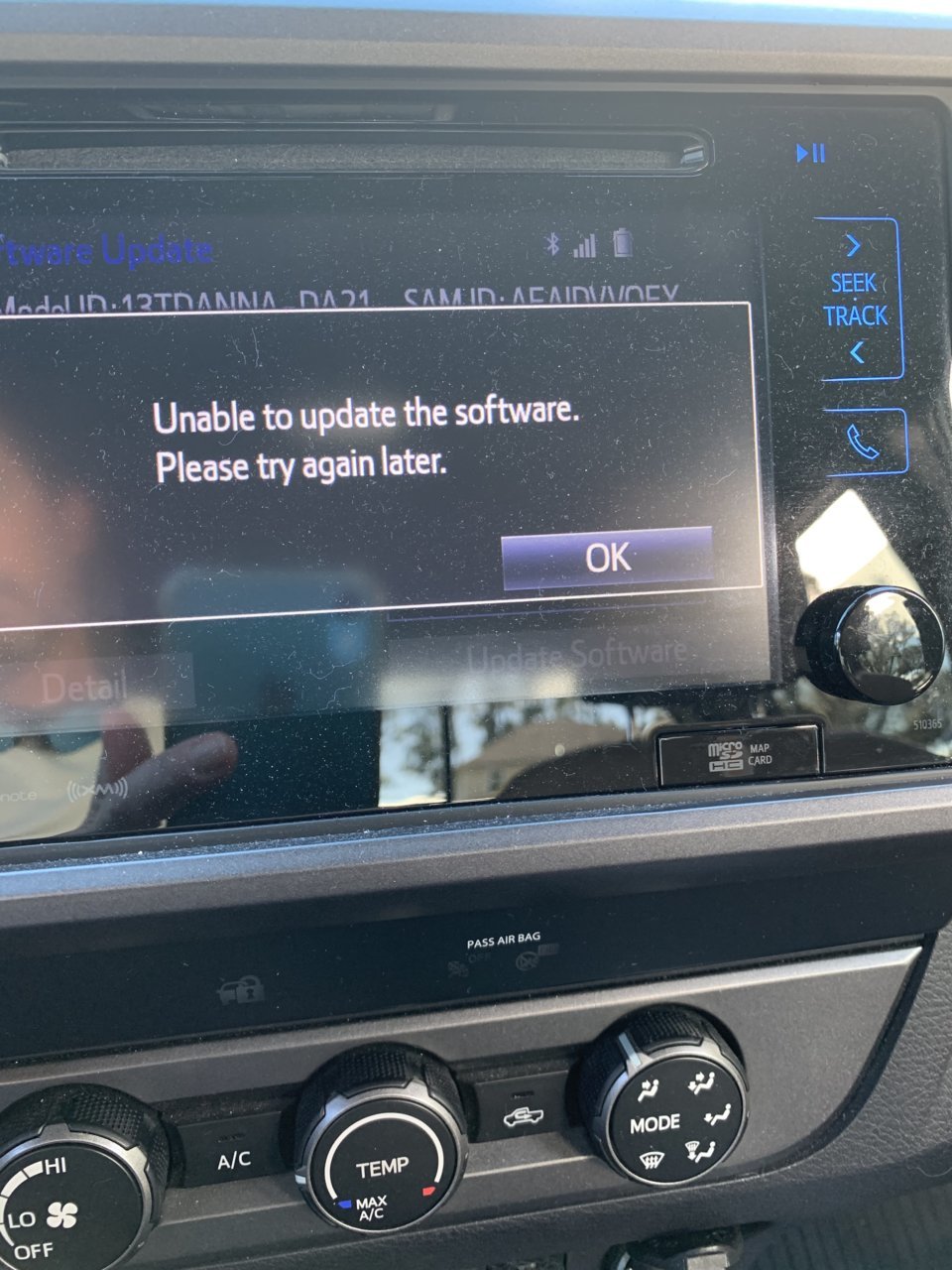

    Well crap! Software update appeared to go well and I was prompted to turn vehicle off and then back on to complete the update. Then this. The screen before said to contact dealer. Any ideas?
    2019 premium entune using the 165 kwi
    tcjacado likes this.

    That stinks. I was getting similar with the old version, except it was dying about 1/4 of the way through.
    My only suggestion is waiting to see what other 2019 folks post up?
    Skydvrr and G8R_Taco[QUOTED] like this.

    I couldn't find a 2.0 USB stick. That shouldn't matter right? Formatted FAT32

    Nah. As long as your formatted like that and are of decent size it should be fine. Getting that far, the USB stick shouldn't matter.
    There are instructions if a FW update doesn't take, but it ain't pretty.
    One was to try the update again with the Map SD card out.
    The other was to wipe the H/U and disconnect the battery.
    Neither worked for me. It was surprising how long it to get all the options set up again.

    According to this link here (about ⅔ down), it says:
    "There may be times that the software update cannot be performed due to communication device or media is still preparing, such as trying to perform the software update right after the navigation system has started up, so perform the operation after a while"
    Maybe let the truck sit at idle for a bit before initiating the update?
    G8R_Taco[QUOTED] and tonered like this.

    Funny you mention that. I recently got a new map sd card off ebay and was wondering if that might be an issue. Put the OEM one back in and no joy.
    And I have the battery unhooked now and on a charger.
    The radio still works so its not bricked or anything... weird :annoyed:

    Try it with the card out.
    Yeah. The updates are generally foolproof, so you won't have any issues if the update doesn't take. Here even more so as earlier versions were publicly available on the Downloads website.
