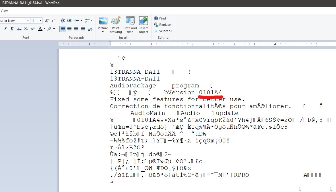

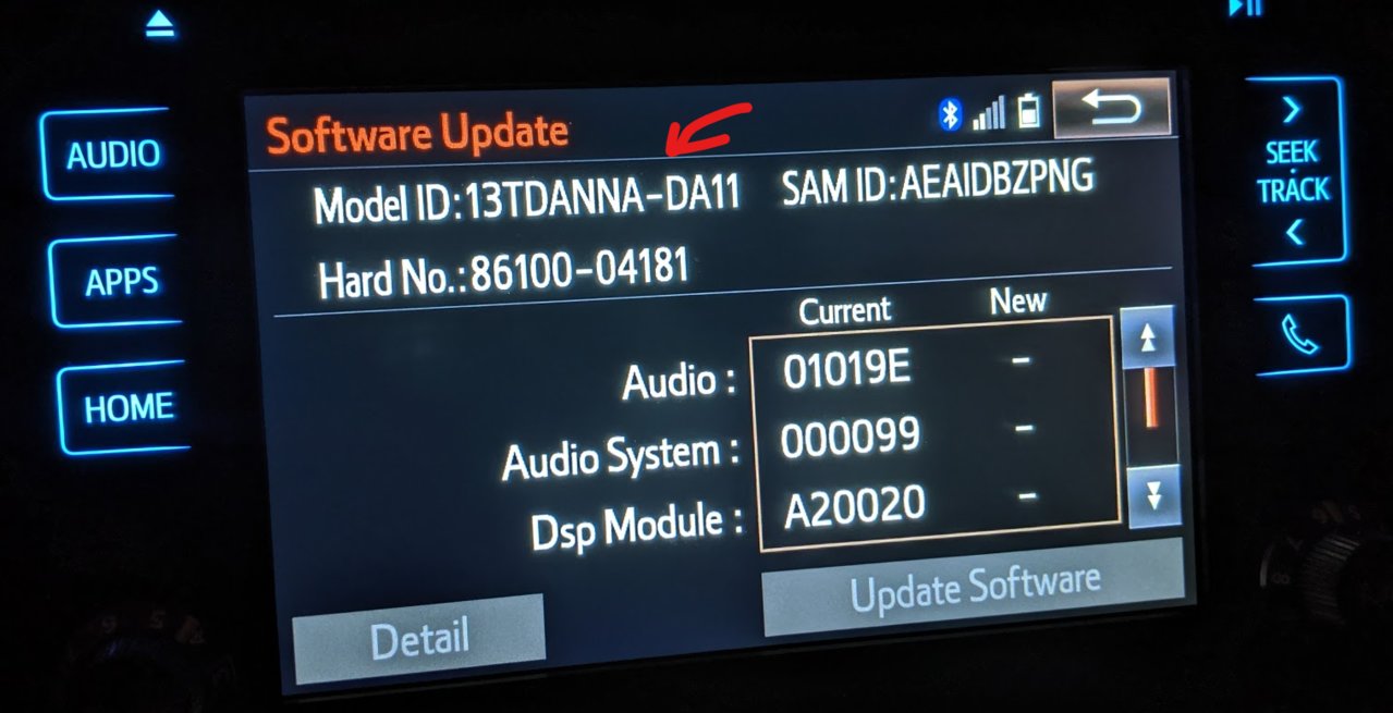

    I suppose that it should be mentioned. You can load up all of the KWI files on a USB drive and the H/U will pick the proper one to flash.
    Also, there is no obvious relation between the KWI files names and the Audio version. This is how you tell:
    KWI file is the Model ID that you see in the Software Update screen. Audio version 0101A4 is a higher version than 01019E, so this will be a valid update for me:
    The Audio version after the FW update can be seen by opening the KWI file in WordPad. It will take a while for the file to display:
    The H/U update instructions explain the Audio version numbering.

    Thanks for that. I have never attempted that before, as I wasn't sure if the HU was smart enough to ignore the non-applicable files.
