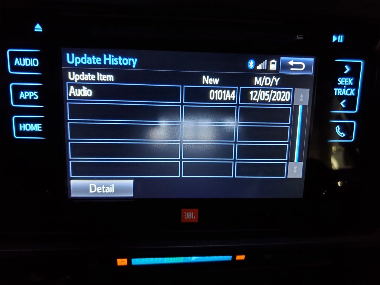

    @ktbell444 thank you for the update file!! Worked like a charm for my non-updated 2017 JBL. AWESOME!!!
