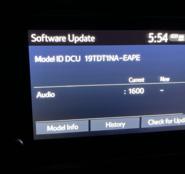

    EBBA10C1-5C59-40E3-82CE-24213D101F06.jpg The Nov. 19 file on the Toyota website, 17TDT1NA-DA30_0006.kwi did not appear to update what I already have. Maybe it’s the latest or I’m doing something wrong

    You made some incorrect choice? The Model ID is not the same.

    Load all the available .kwi files onto the USB and the head unit will find the file it needs. The other files will not present a problem.

    @tonered @crbr ive got all of the kwi files from OPs zip + 17TDT1NA-DA30_0006.kwi on my USB and get the prompt that says I’m up to date

    I'd venture to say, you are up to date. Look in the area on the unit where records are stored (not yet that familiar with the specific buttons). Maybe that is what your photo is. The up-to-date flash version will be there IF it took an update. If not, I say your good to go.
    In your photo, under the NEW column, there is a dash. I suspect that is the fact that the current version is up-to-date and no new flash version has been accepted.
    I say all of this with reference to the non-JBL premium unit in my tiny truck.

    Ah, you have a 2020. The T-SB did not cover the 2020 MY. @mattleg found an update file that he pointed out in this post here. His head unit was already up to date as well.

    thanks, will sit tight then!
