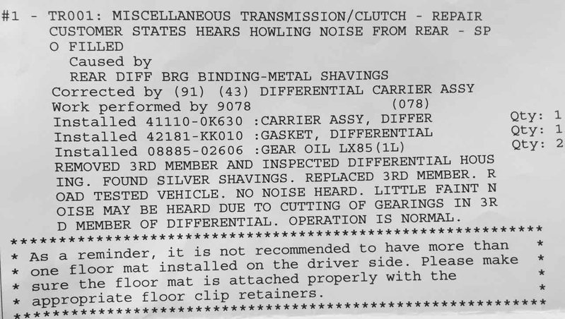

    Thought this was interesting. SILVER SHAVINGS?!?!?! That's just great to hear about your new truck. Oh yeah. And the OPERATION IS NORMAL.

    well little tiny filings is normal for a differential usually.
    if its big pieces i'd be more concerned.

    When the hell was this done? Recently? Are they really still replacing random diffs even though it clearly doesn't fix the problem? Two people, same problem. One gets new diff, the other is told it's normal deal with it. Toyota WTF?
