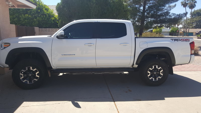

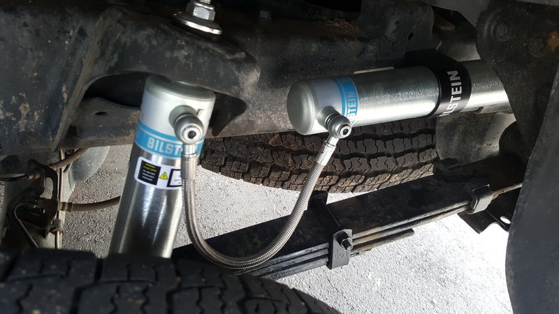

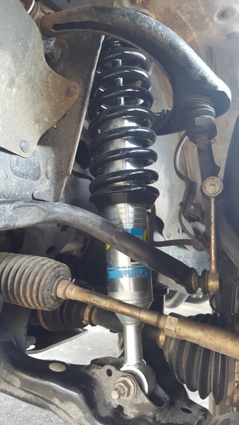

    Yeah my service manager told me as long as I kept it below 2" I'd be OK as my case is very well documented. The 6112 /5160 combo with progressive 3 leaf AAL is actually an upgrade in performance and ride over my stock TRD OR suspension. I was very skeptical going in but I've been super impressed by it so far. It does maintain control and absorb bumps better off road. It also seems to hold better in cornering on the road. Interestingly enough I also cannot hear any diff whine now that the rear end is lifted slightly. I feel like this further supports theories of driveline angle playing a role. Update: I can still slightly hear the howl.

    Wheelers 3 leaf progressive pack and 5160s for rear, turd gen 6112s for front, all pro flip kit with wheelers superbumps that go with the all pro kit. Superbumps for front too. Bought a tub of energy suspension grease for the leaf springs based on GPSEVINSIXX advice. Set the 6112s to 5th notch on driver side 4th notch on passenger side for 1.5" lift in front based on the bilstein instructions.
    Got the 6112s from race consulting agency for like $559 on sale. Killer deal couldn't pass up. PM me and I can send you some links and stuff if you want. Very mild lift. Parked next to a stock limited the other day.
