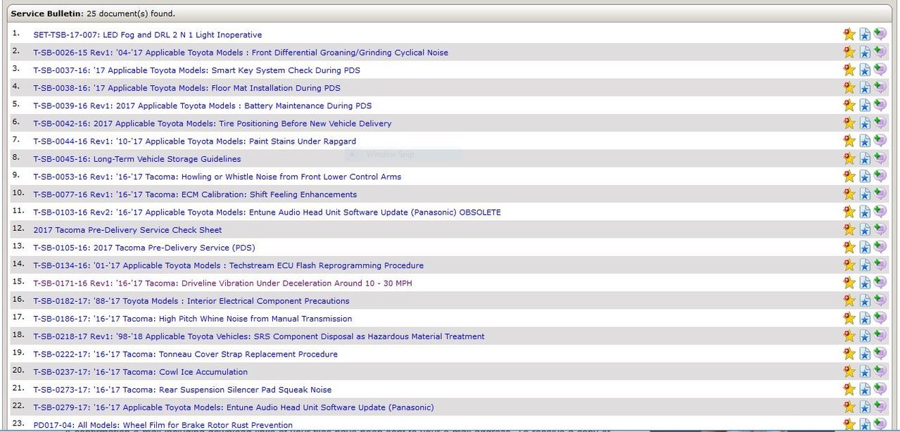

    All current TSB's still no mention of rear differential whine or howl.. From Toyota TIS.
