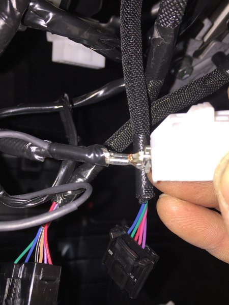

  14. Dec 31, 2016 at 10:00 AM
    #734
    PJnc284
    PJnc284 Well-Known Member
    Mar 6, 2012
    #74326
    690
    Garner, NC
    2016 Tacoma TRD Off Road 4x4
    It's also been mentioned that you can pull the 12V plug from it's connector and solder to the crimp for an easily reversible solution. @GoGoStAm has a good picture of the connector removed.
    https://www.tacomaworld.com/threads/detailed-review-nickjs-kbvoodoos-remote-start-kit.465105/
    Should be able to find them on ebay. Product # is PTA2426
  15. Dec 31, 2016 at 10:05 AM
    #735
    gpb
    gpb Well-Known Member
    Aug 24, 2016
    #195408
    6,082
    Atlanta
    2017 White DCSB TRDOR 4x4
    Here's the end of the same connector; you'll insert a stiff metal object on the right side to disengage the locking tab holding the metal socket inside the white connector. A *small* jewelers screwdriver works pretty well.
