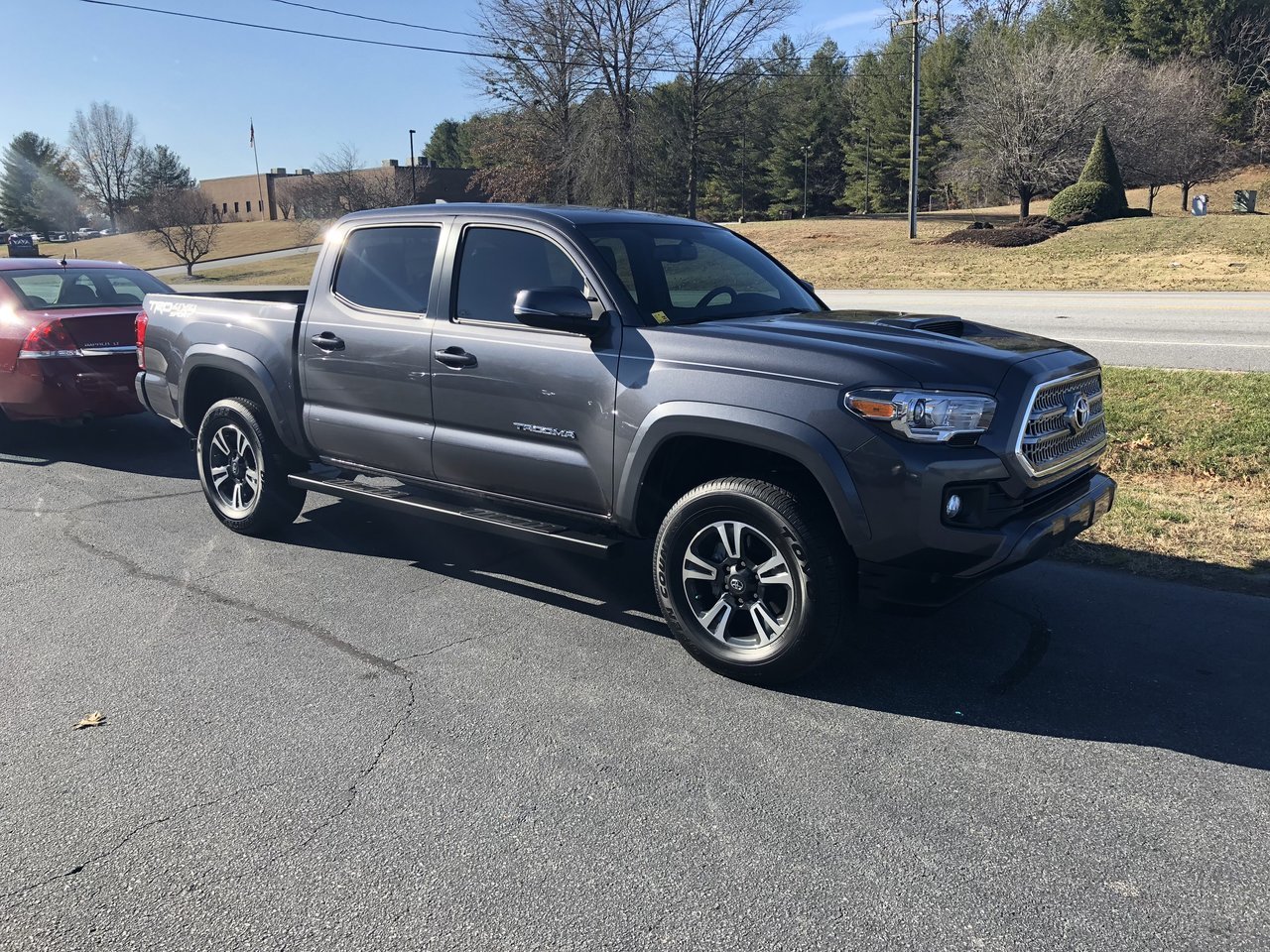

    Taco.jpg Hey guys,
    New member here. I have done a ton of reading on this site, what a great resource! I just took the plunge and after many years of drooling, bought my first Toyota.
    I know this is a common topic on TW but haven't found anything specific to the Gen 3 Tacoma's so here we go. Feel free to give me a nudge the right direction if there's already a thread going.
    I live in the mountains of NC. My truck has 6k miles on it and NO rust. The roads are covered in salt and being in the mountains, this happens a dozen or so times a year.
    I asked my dealership and they said they don't have anything to offer.
    What would you do?
    Thanks for your thoughts!
    Edit: Just ordered some "Fluid Film". I'll keep you guys updated on how it works. Thanks!
