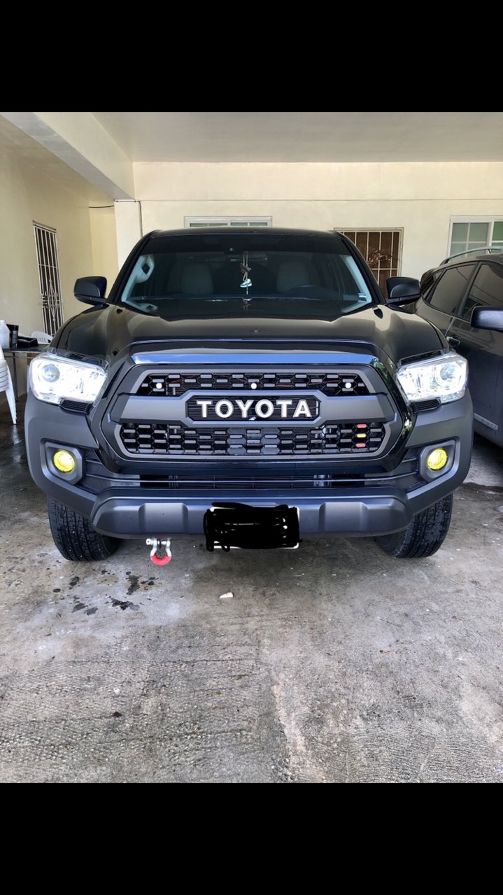

    8E8083D2-50DD-4EF6-B937-1D7D8D9FB834.jpg Just installed my fog lights the other day.

    Where did you get those yellow fog lights I want to get some yellow for my sr
