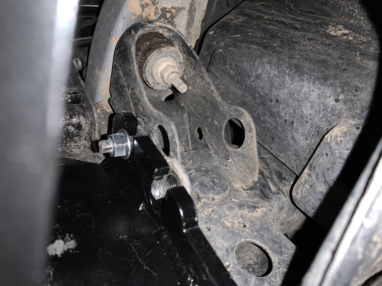

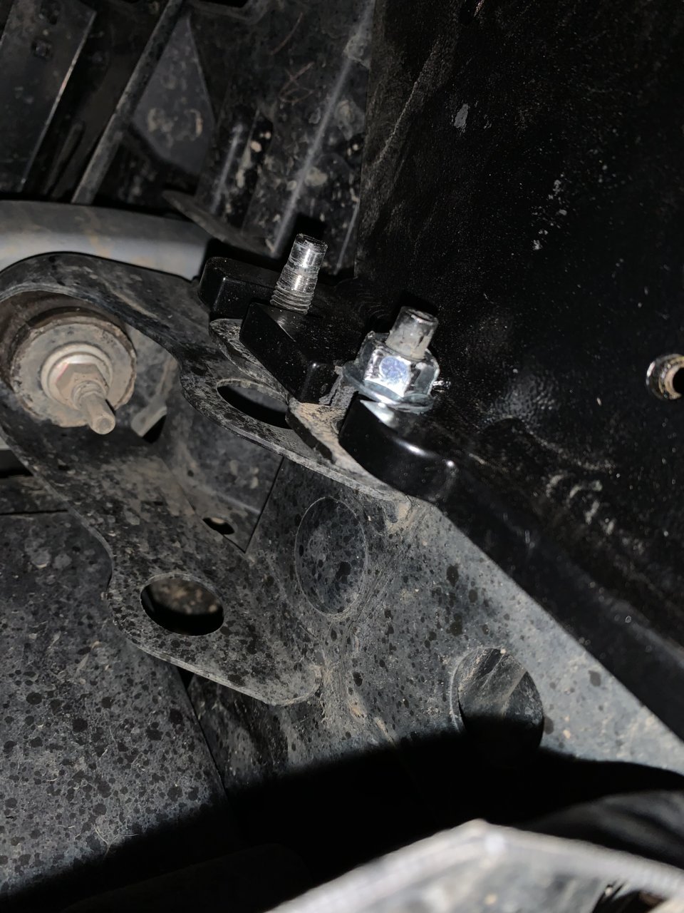

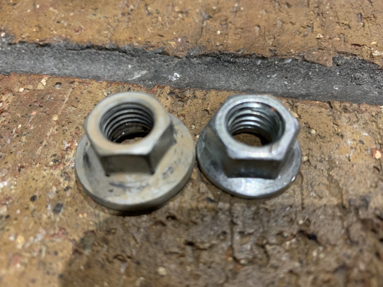

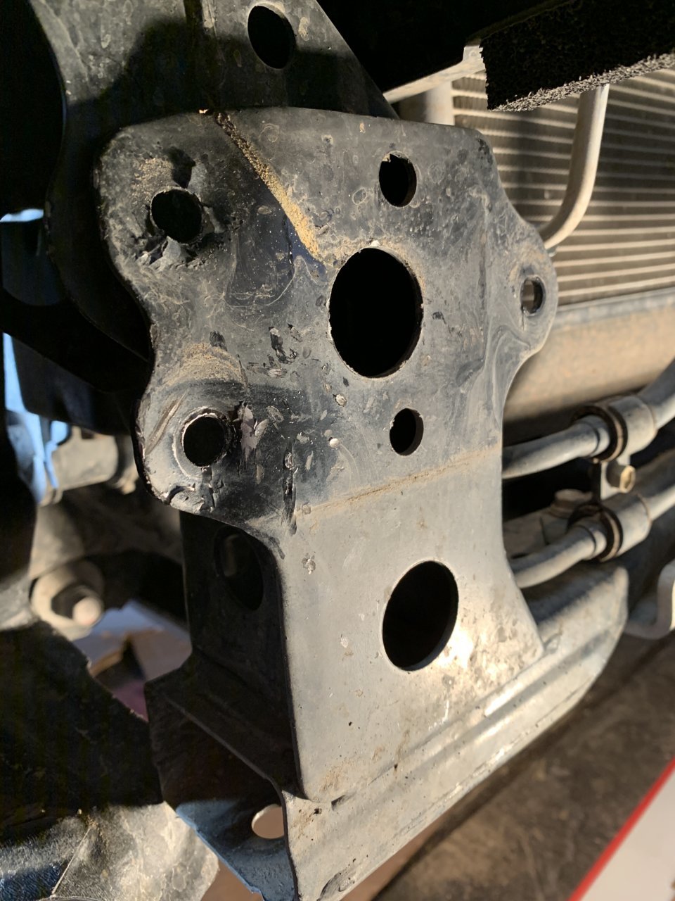

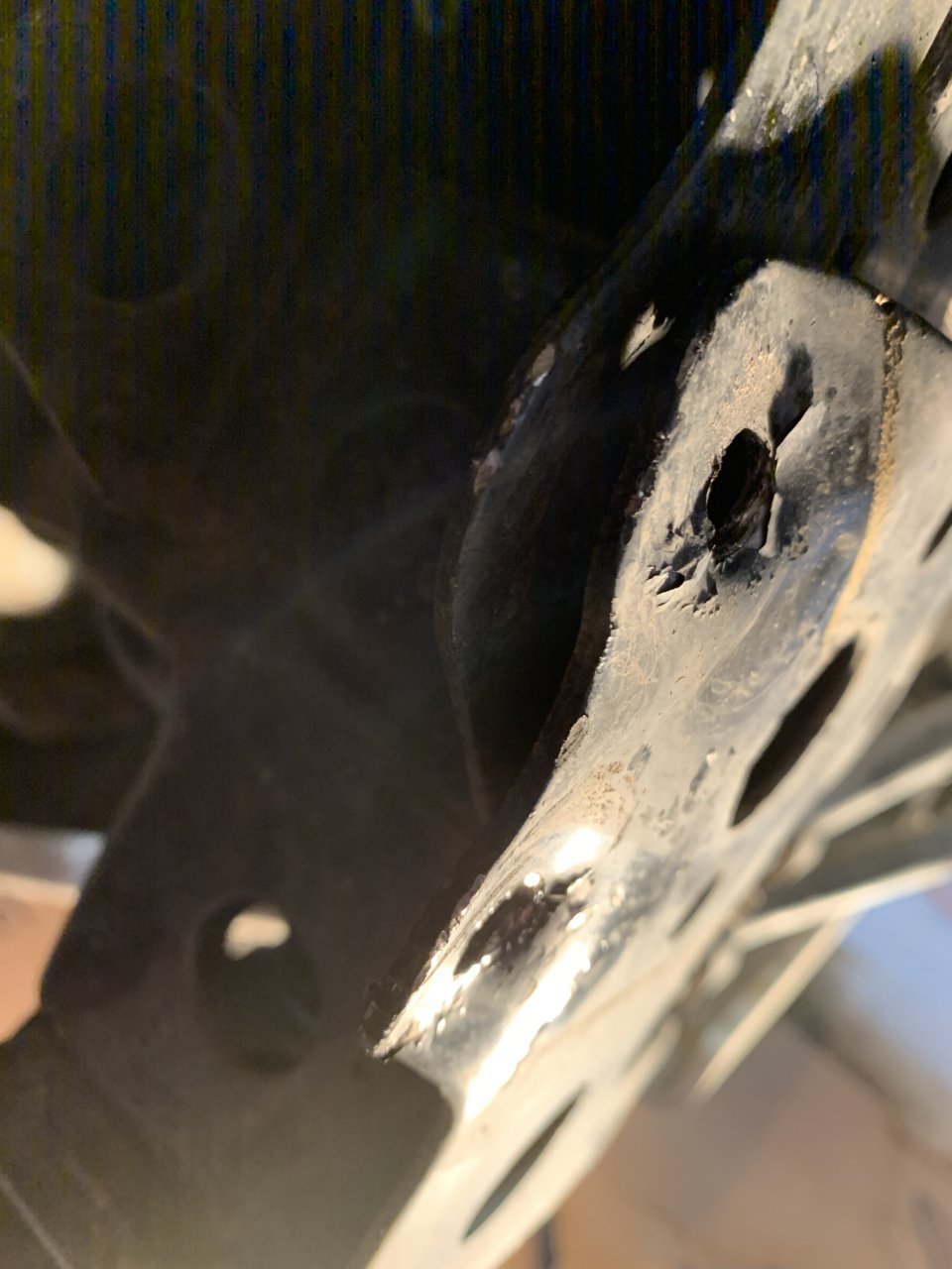

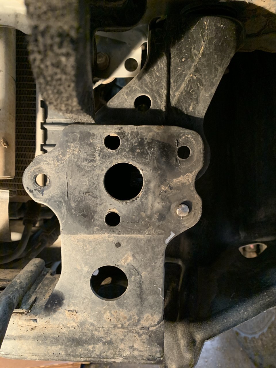

    Crossposting here.
    (And thanks to OP for this super helpful install tutorial!)
    TL/DR - CHECK YOUR HARDWARE:

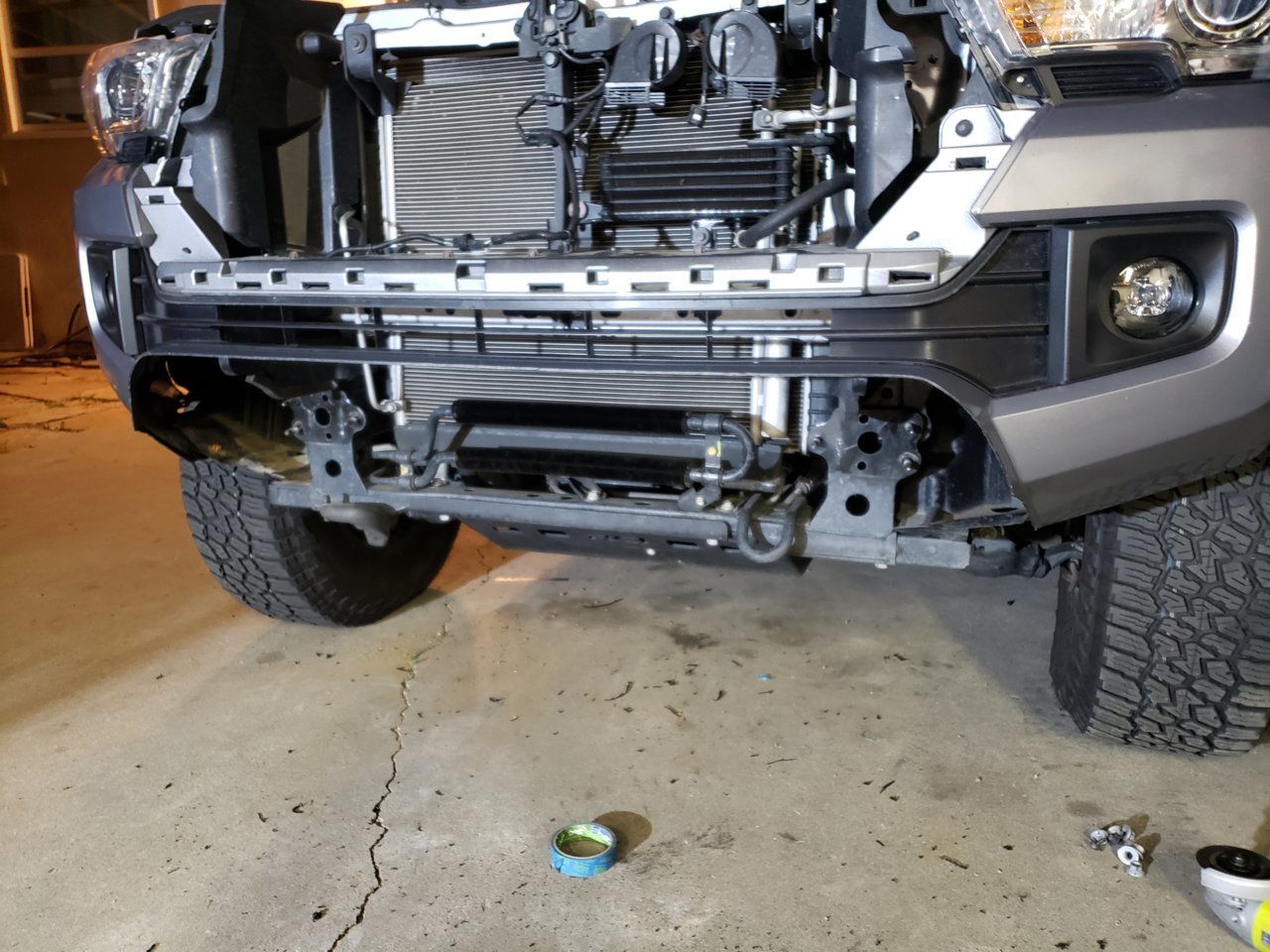

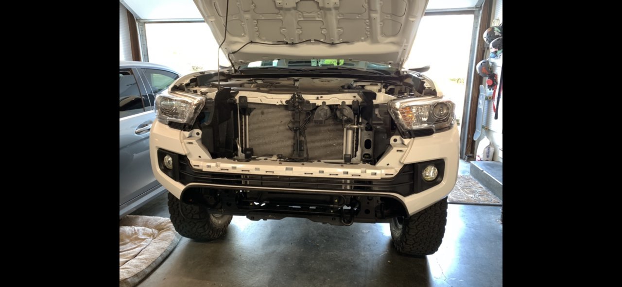

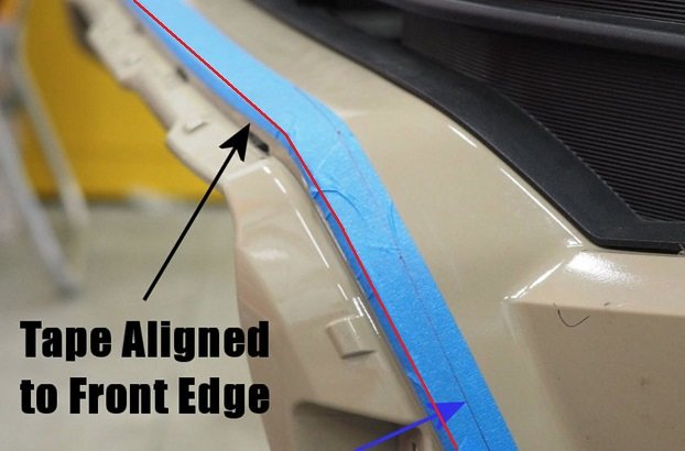

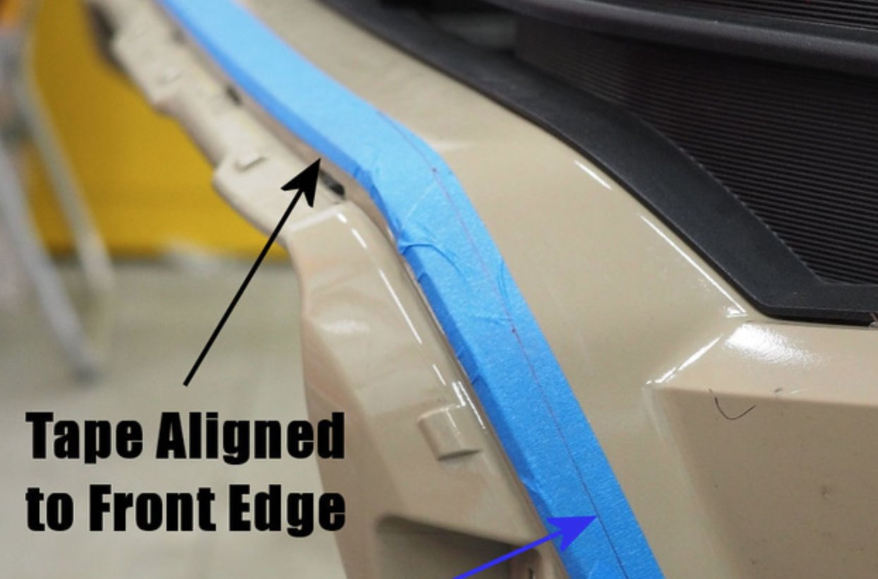

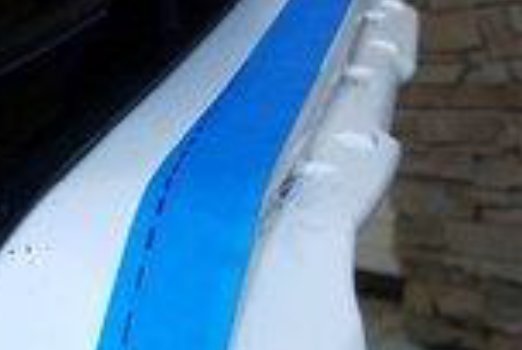

    Getting ready to install my bumper in the next few days. One question about the bumper cut. Various instructions state to use 1" blue tape. @Hodakaguy shows the tape rolled over the top edge about 1/8"-3/16" (Quicksand) but others show the tape not rolled over the edge (Red, White). What's the right location for the top edge cut? Cut off a full 1", or less like Hodakaguy? (Not asking about the cuts down the ends / sides.) Thanks. Screen Shot 2020-01-30 at 5.37.46 PM.jpg Screen Shot 2020-01-30 at 5.41.37 PM.jpg Screen Shot 2020-01-30 at 5.42.18 PM.jpg

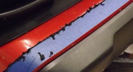

    Did you get the bull bar? I opted to not have it on my bumper, so I cut it right at the leading edge., (red line in picture).

    I do have the bull bar on mine. So, I need to cut enough to have clearance for that. But, I'd like to not cut more than needed.

    Looks up the sso YouTube install video from
    Southern style off-road. The guy that shows you gives exact measurements. Makes it way too easy.

    Keep in mind though when you try to follow the video, when cutting the sides of the bumper don’t add 1/8”, add 1/2” or possibly 3/4” closest to wheels. Reason being is it’s extremely easy to trim more but you’re screwed basically if you cut more than the trim can cover. I added 3/8” and had to add some shims because it was cut too high and the factory setup bolted together was leaving a nice gap that the trim didn’t cover. Shins were simple fix just added time to the install.

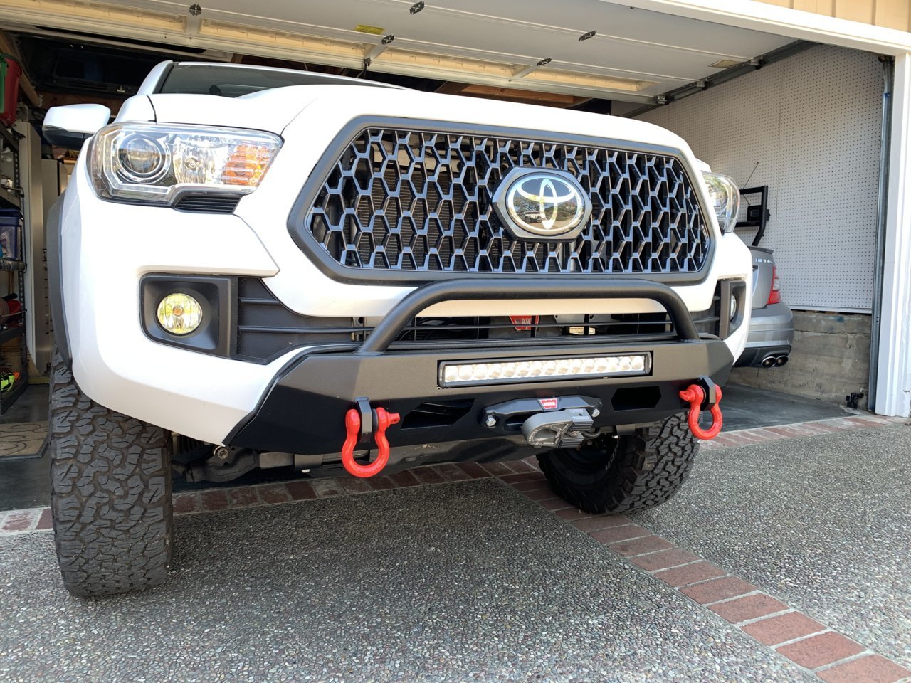

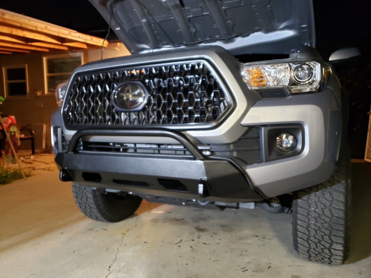

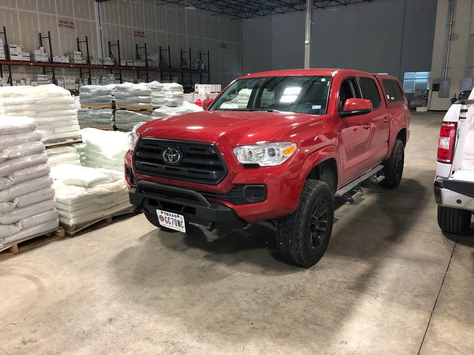

    Pics of my install

    Ah, the video for the Slimline Stage 2 has it. I hadn't watched that one because I am only installing the Slimline, not the Stage 2. But, you are correct. They say 3/4" cut from the black lower grill piece, along the top. Thanks.

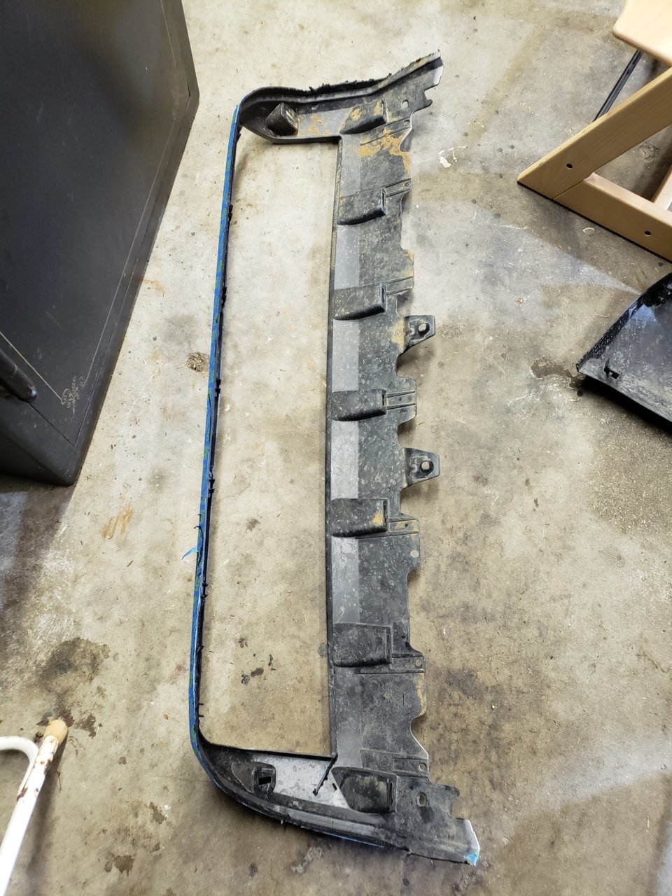

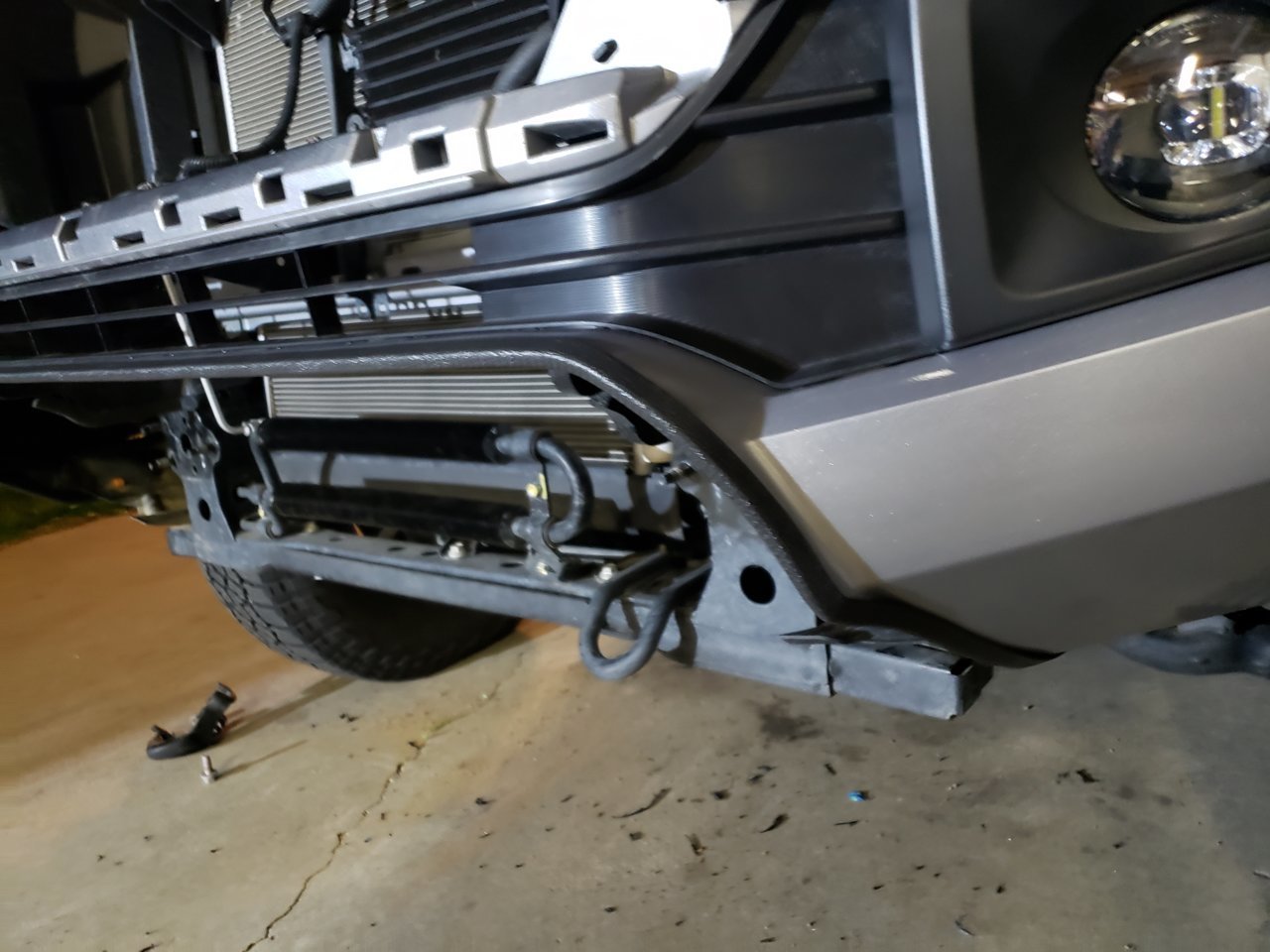

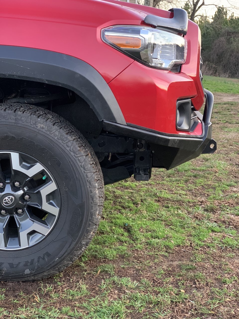

    Just installed my SSO bumper last week. I was nervous to do the cutting. I did not measure at all. Just eye balled it compared to the photos in this thread and the instructions by SSO. Came out fantastic. It took 20 minutes to lay down the tape, 2 minutes to cut with a 4 1/2" angle grinder.
    20200215_192154.jpg 20200215_195335.jpg 20200215_190927.jpg 20200215_190920.jpg

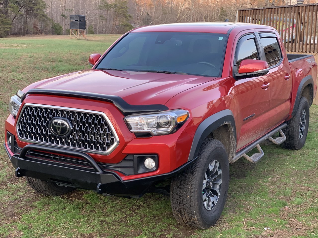

    Thanks for the instructions in this thread. Very helpful! Not a difficult job at all, just a heavy bumper (w/winch). That's the toughest part, although I also wrestled with the little side brackets that support OEM bumper. Hard to access the bolts. Very happy with the result!
