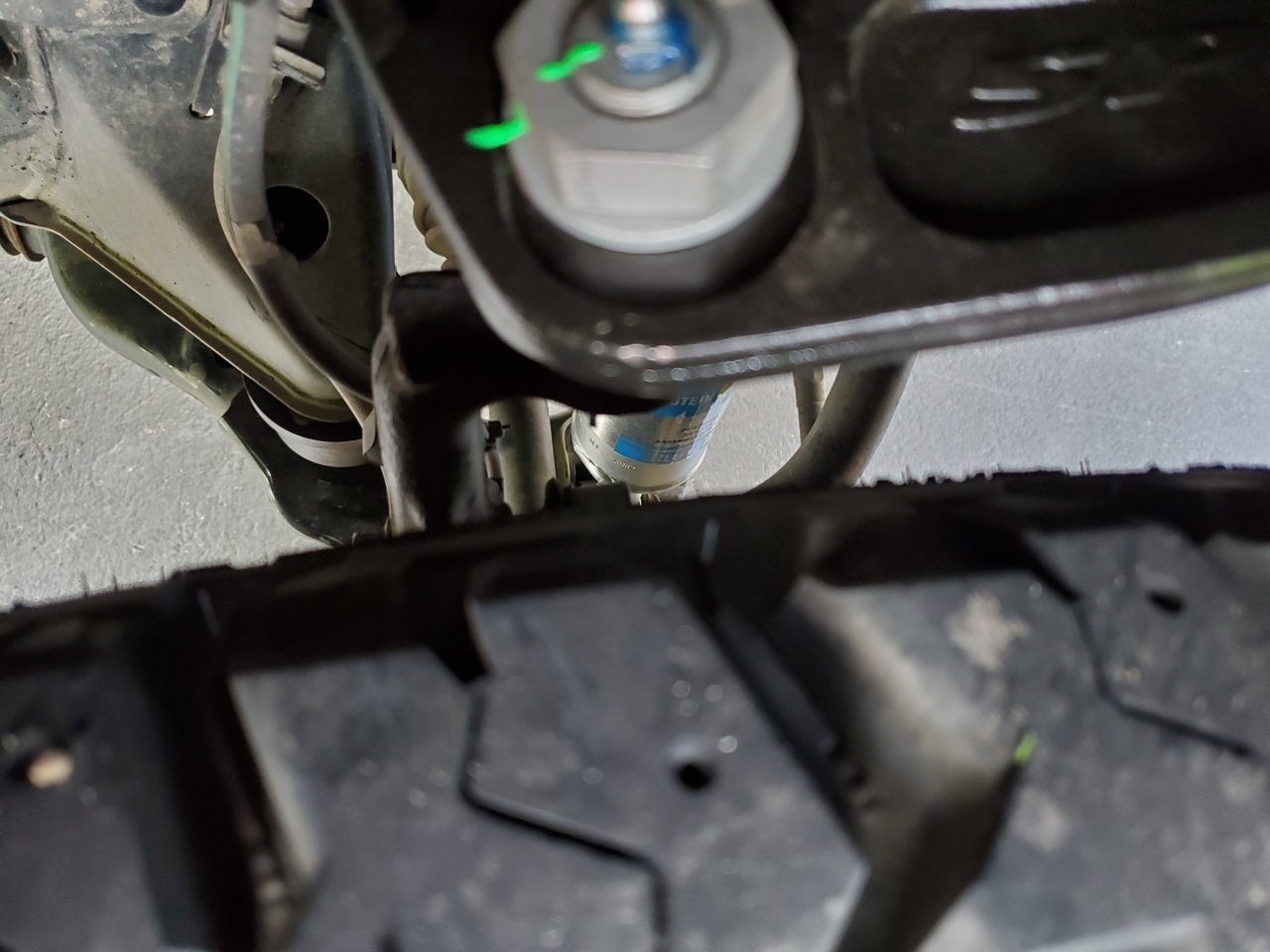

    I've got 255/85 R16's on stock OR Wheels. As we know, they don't rub anywhere (except mudflaps at full turn and crunch). That said, they are pretty close to the Stock UCA.
    I'm getting 6112's installed at the end of the month and was contemplating have them install SPC UCAs.
    I'm concerned that the new UCA will be bigger (or differently shaped) in a way that makes them rub.
    I could do spacers but then the tires will rub.
    Has anyone run this set up or have thoughts on if this will work?

    Just providing a 100% confirmation. This configuration has no rub.20210701_071933.jpg
