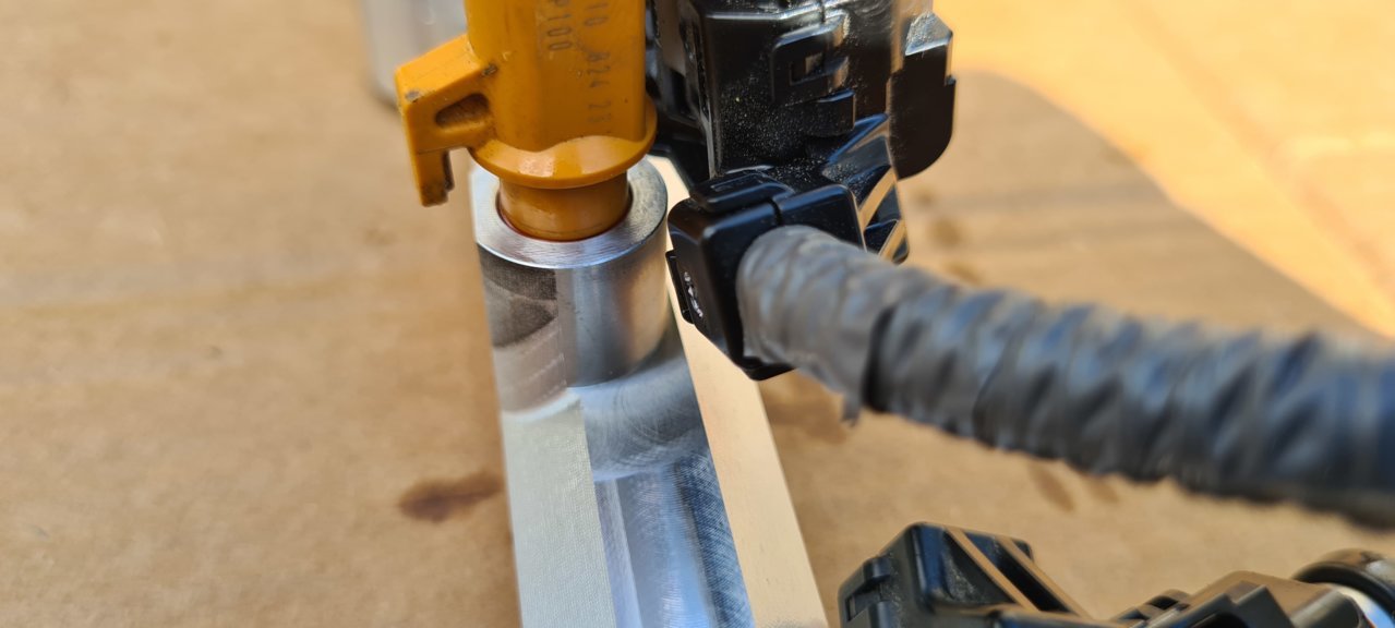

    Installed these over the weekend (for Supercharger application). Install wasn't too bad at all. Only needed to remove the top part of the SC. Bad thing is I crushed one of the o-rings on one of the injectors and didn't notice it. Put the whole thing back together and on start-up it gushed out fuel. Took the whole thing back apart, rails back off and replaced the o-ring. Then put it all back together again.
    My suggestion would be: Be very careful when putting the injectors in the rail, watch the o-ring go into the boss correctly. Also would be a good idea to have a couple extra o-rings on hand before doing the work. It took me a couple hours driving around to different auto parts stores to find an o-ring that would work.

    Apply clean motor oil to the seals before installing and carefully twist and rock the injector as you seat it into the rail to ensure it compresses properly. All of the rails have a lip machined into each injector boss to assist with installing the seal.

    If only I had followed that guidance (as detailed in the install instructions) I could have saved myself several hours of work.
    My issue was that I didn't visually confirm the injectors were going in without pinching the seal. I guess I got lucky on 5 of them, since those worked without issue.
