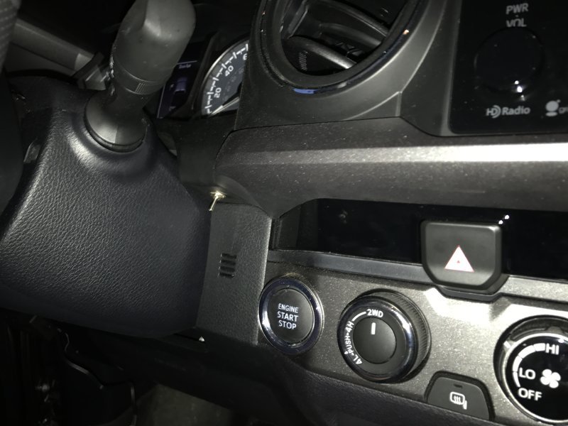

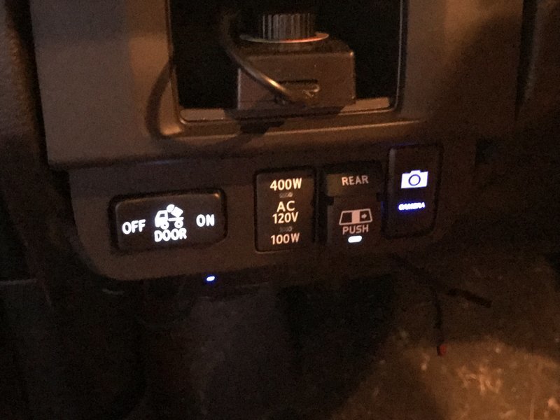

    After MUCH deliberation I chose to install my SW2 switch a bit higher than the OP for easier access. I'm a big guy with serious back problems so the less bending I do, the better. I really like it because it's pretty much "hidden" in plain sight.
    SW2 switch
    S1 switch.
