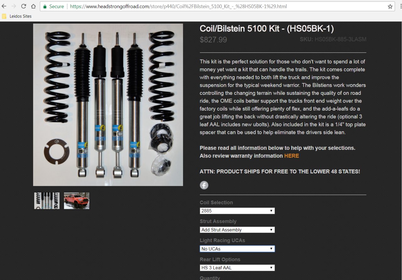

    would leveling out my Tacoma with billstein 5100 and Camburg UCA's be a good idea? Looking to only lift the front, but also looking into Fox 2.0 series front coil overs but not sure if using Billstiein 5100 would be a better better decision (cost why's). Looking for something affordable but at the end of the day I guess I shouldn't cheap out on a 35k truck.

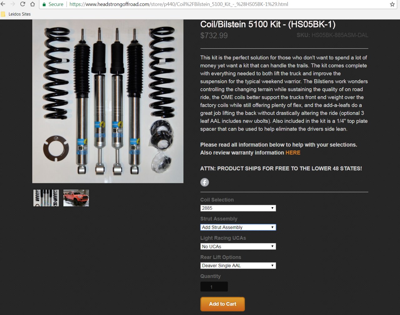

    This is the most cost effective way to level/lift your truck AND improve it's performance....you don't need UCA for leveling/small lift (under 3 inches).
    Use this link to determine what OME coils you need based on how much lift you want in the front.
    https://www.headstrongoffroad.com/uploads/1/1/8/4/11846658/lift_guide_shock_and_coil_selection.pdf
    You can actually get it for $643 if you can install the coils yourself, but I think it's $90 well spent to have thecoils pre-assembled. Personally I would call Marie a at Headstrong and tell her what you want your truck to be able to do and your budget and she will set you straight.
