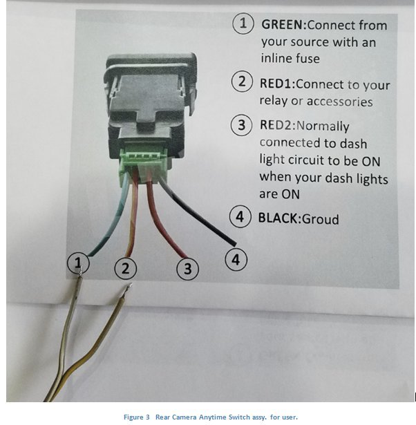

    I finally have everything to install. 1 question. For the 2 black wires does it matter which one goes to the green or red switch wires since they are both the same color? What is the difference in the 2 black wires?
  18. Dec 19, 2017 at 8:27 AM
    #218
    Skydvrr
    Skydvrr IG: @kalopsianick
    Sep 13, 2017
    #229889
    12,653
    Nick
    YMH
    Black '17 OR
    Naw it don't matter. You're just connecting both sides of the black wires. If u twist the wires together you'll get the same effect of pushing the button. Then the other two wires from the switch are for the illumination side of the switch. To power the LED.

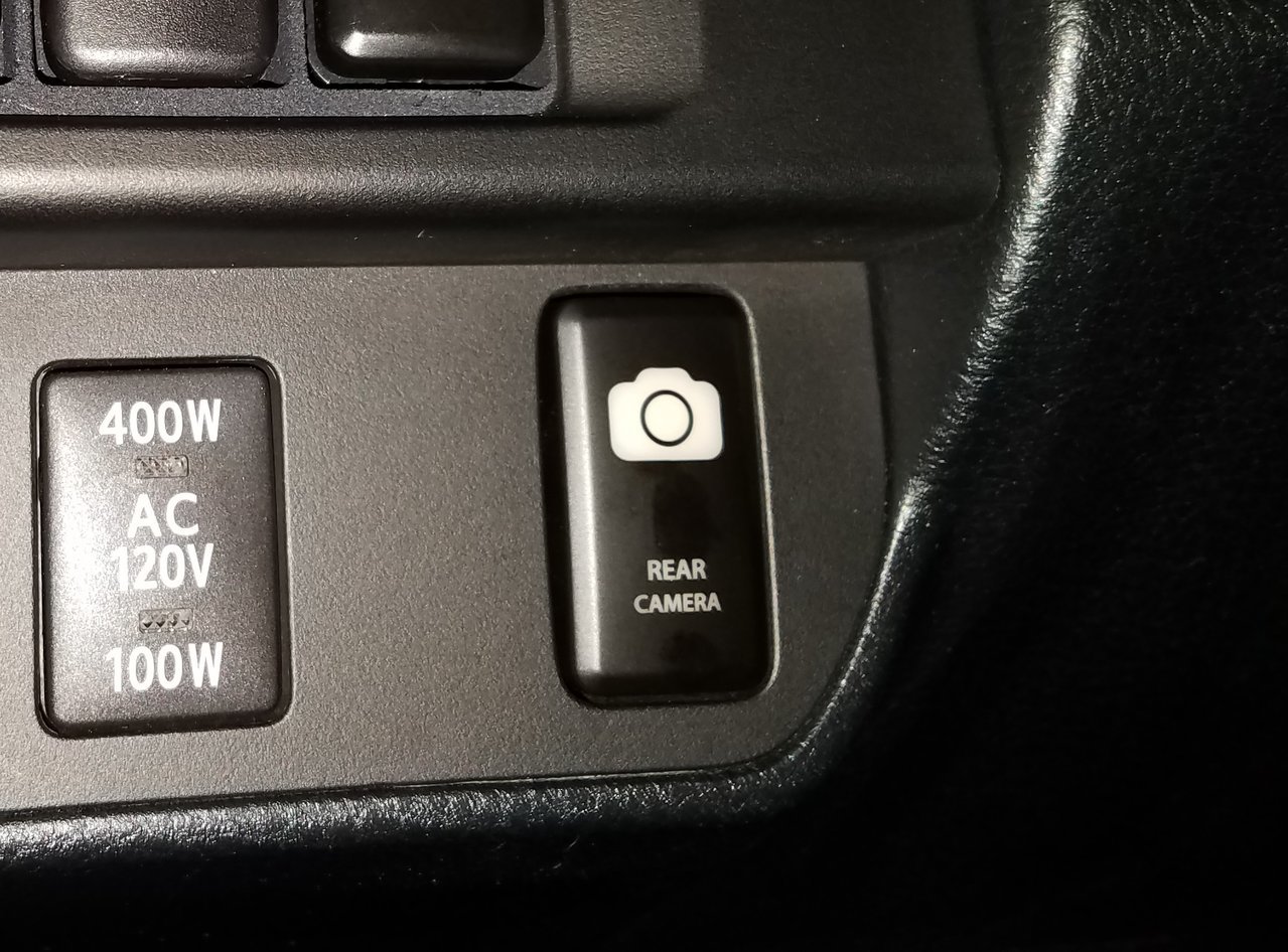

    Was there a guide you followed for getting this part off? I like the placement but don't feel comfortable drilling in place.
    Thanks!
  20. Dec 19, 2017 at 11:07 AM
    #220
    tonered
    tonered bartheloni
    Sep 25, 2017
    #231055
    31,195
    tony
    Lynnwood, WA
    I just winged it. I think I saw a thread about modding the key barrel to get rid of the key bong.
    Raise the steering wheel as high and toward the seat as far as it will go.
    From center, turn the steering wheel 90deg to the left and you will see a fastener on the vertical face. Take that out. Turn the steering wheel 180deg to the right and remove the other fastener.
    From there, you just need a spudger or other thin plastic tool to separate the lower cover from the top.
    Flex it out from the key barrel and that should be it.
    Don't drill the hole where I did on the first try. Use that upper hole in the pic.
    To install, just flex it in place, press it together, and install the fasteners. Depending on how your routed the switch pigtail, you might need install the switch while the cover is almost in place. I used a socket to tighten the nut.
    Route the wire around the steering wheel adjustment lever and the foot well heater outlet.
