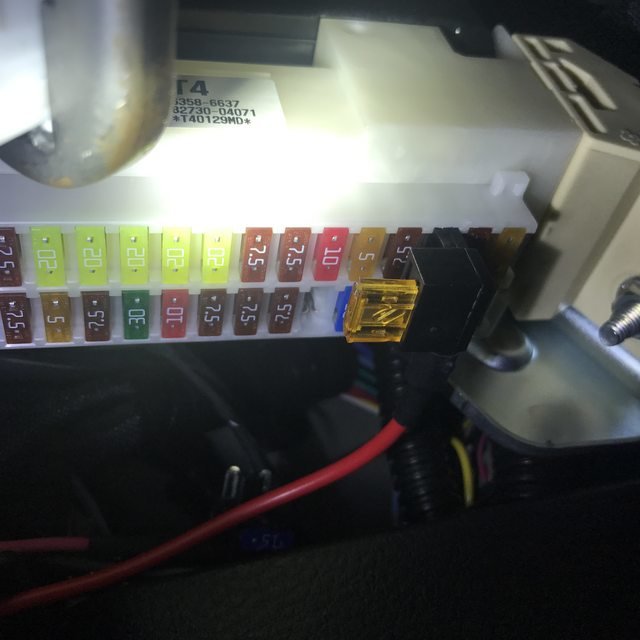

    Hey, Folks.
    Electronical genius here. Can someone please point me toward a good source of key on / acc power? The camera I got had a yellow RCA female and a 12v red / black power lead.
    I was probing around in the passenger side kick panel and could not get a hit. I found a constant power lead that wasn't pinned to anything, but I didn't want to risk battery drain. There is a good ground point back there also. Just need a good positive juice location.
    Thanks!

    I used an add-a-fuse to one of the p-outlet locations with a me-so customs extended fuse box lid.

    Uhh, thanks? So, the English version of that might be that you wired it under the hood? Not in the cab?
    I got mine working temporarily using a spare 12v output pigtail to the power port.
    If I can find out how to pop the power port out (unlikely?), I would just scab it on to that. I do have an MCTuning dual USB outlet on the shelf to go into the blank location on that lower panel. I'm hoping to go the shortcut route, not pulling the whole dash apart.
    I don't intend to scab that to the power port, esp as I do want that to work with the key off.
    BTW, I was able to route the camera harness through one of the two spare grommets / udders (hahaha!) in the big harnesses pass through. Gawd, it was a beyotch enlarging the opening and getting the connector through on the cab side.

    No, at the fuse panel in the cab with an add-a-fuse, like this...
    Then, since your fuse panel cover won't fit anymore with the add-a-fuse, use this cover...
    https://www.tacomaworld.com/threads/custom-fuse-cover-extended-height.519448/

    Oh! That's neato. That might be a good route for the USB outlets.
    Thanks!
    Thanks again for pointing me in the right direction. It did some searching and came up with posts that just said to connect to power as if it was obvious. Although, I was a bit nervy even probing wires given all the airbags.
    I appreciate the help!
